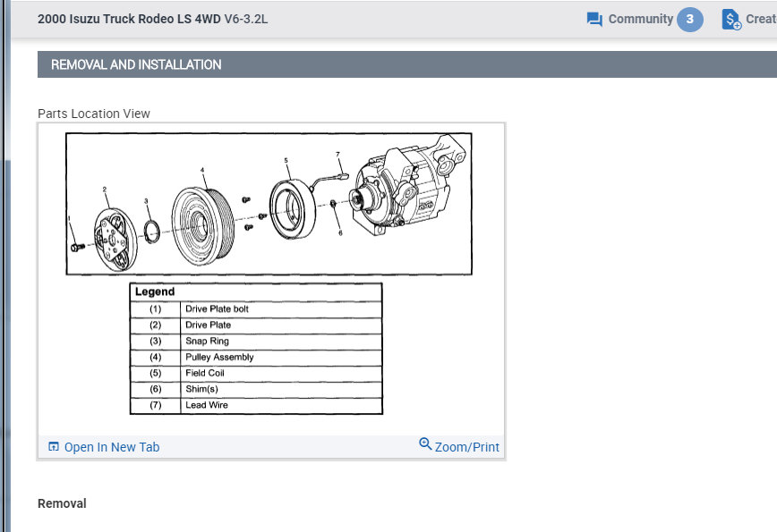

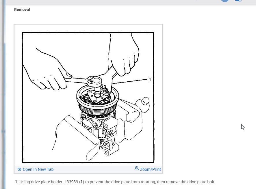

I need to know how to install the air compressor pulley on the vehicle listed above.
Oct 7, 2020 at 6:15 AM
Good afternoon,
I attached the procedure for removing the pulley for you.
Let me know if you have any other questions.

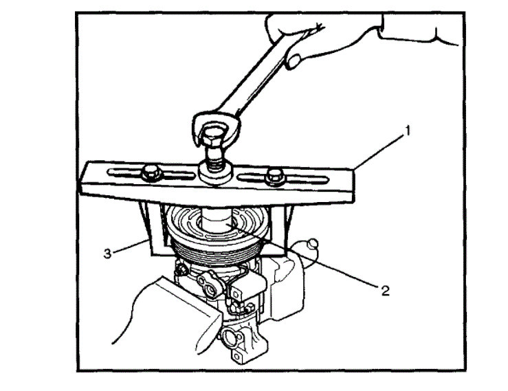

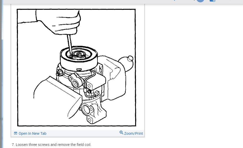

Removal

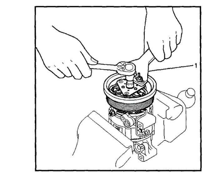

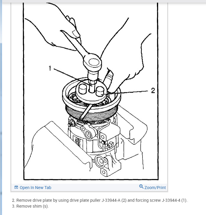

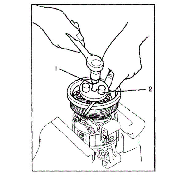

1. Using drive plate holder J-33939 (1) to prevent the drive plate from rotating, then remove the drive plate bolt.
2. Remove drive plate by using drive plate puller J-33944-A (2) and forcing screw J-33944-4
3. Remove shim (s).

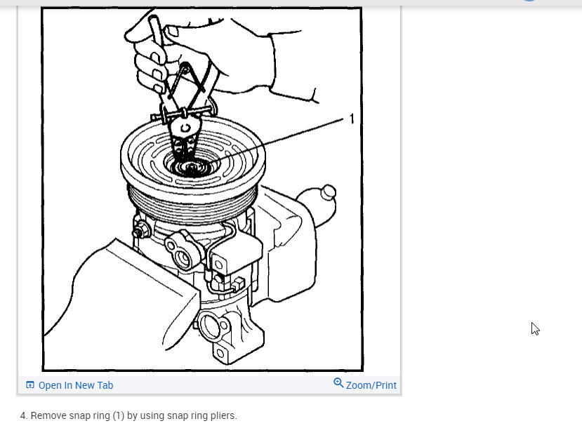

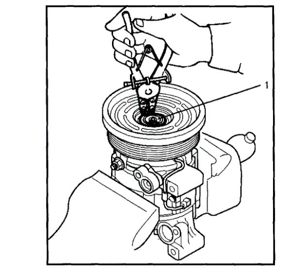

4. Remove snap ring (1) by using snap ring pliers.

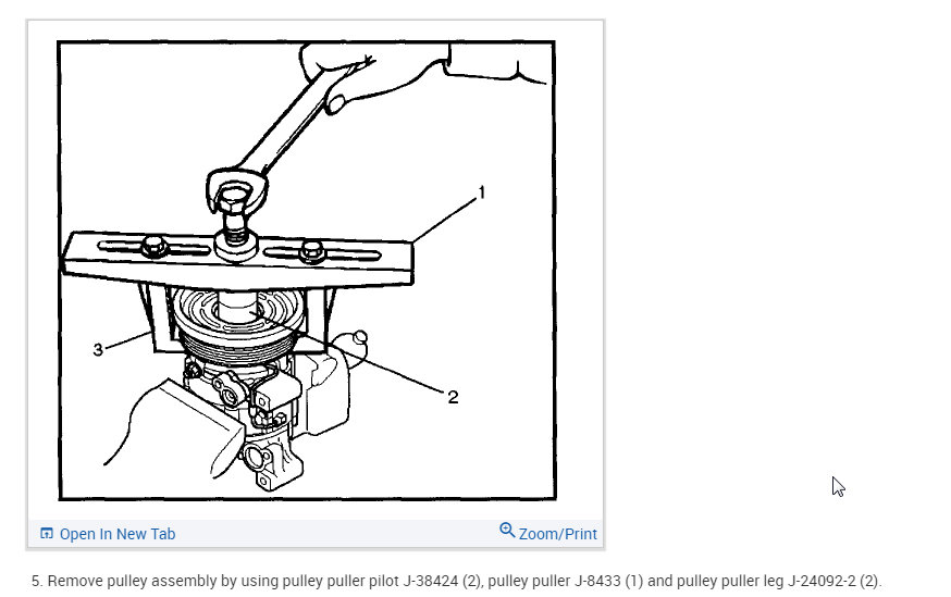

5. Remove pulley assembly by using pulley puller pilot J-38424 (2), pulley puller J-8433 (1) and pulley puller leg J-24092-2 (2).

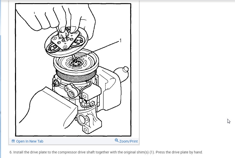

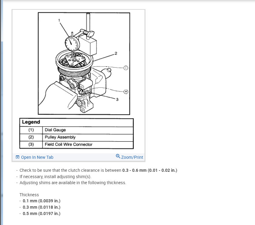

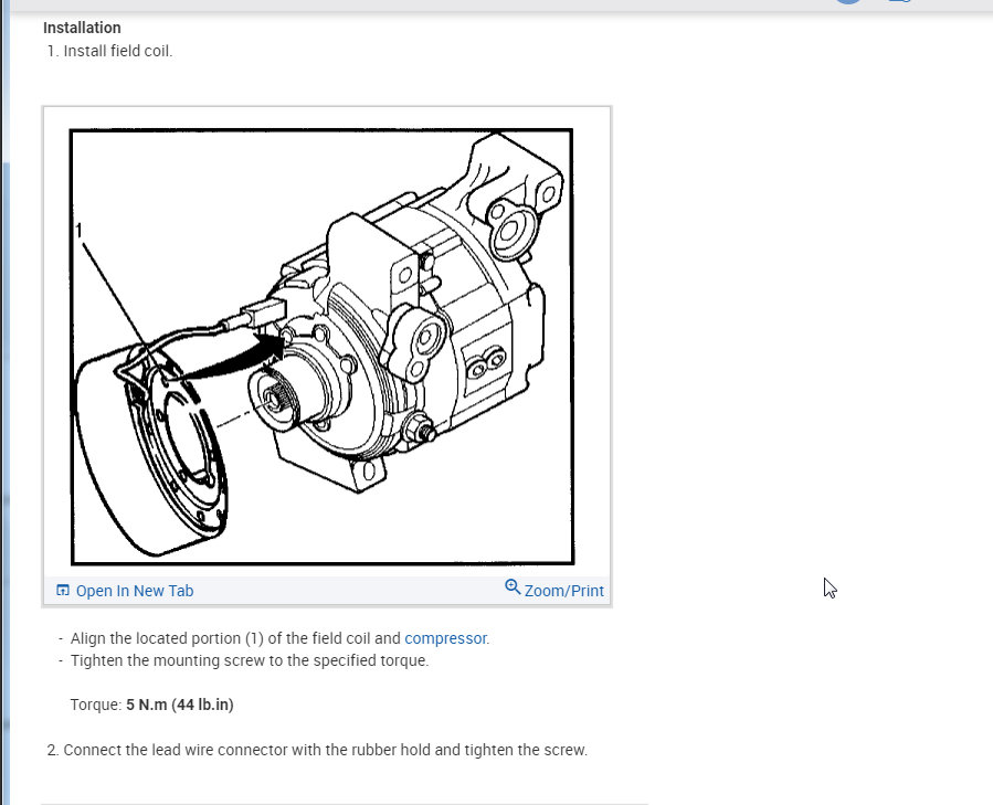

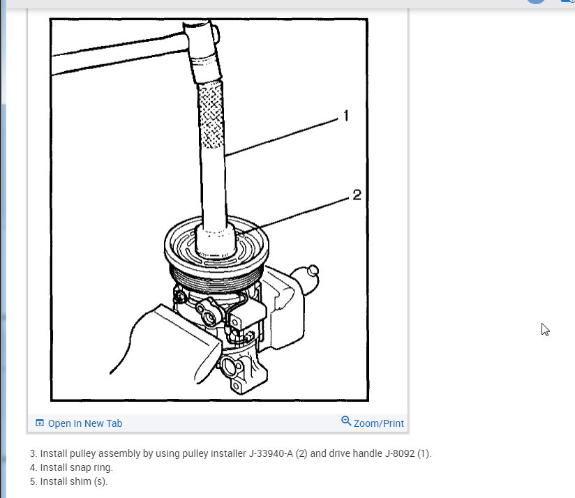

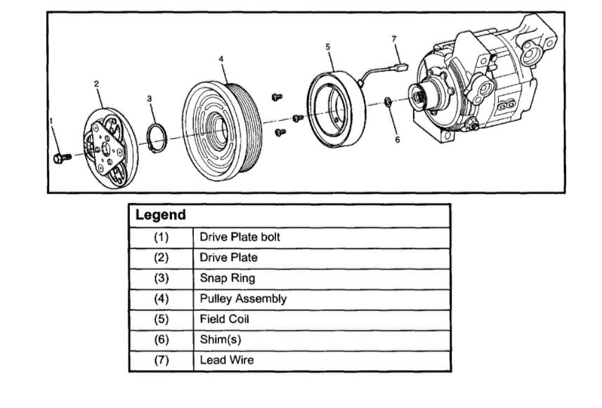

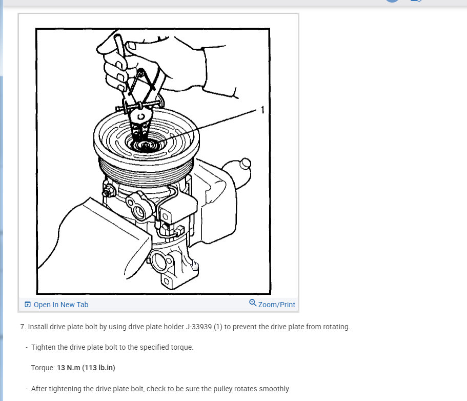

I am attaching the process needed to install the compressor clutch and pulley.
It may be easier to find a replacement compressor with the clutch and pulley installed but that is up to you.
