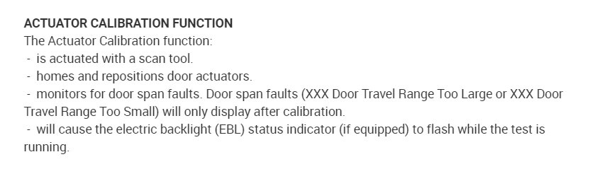

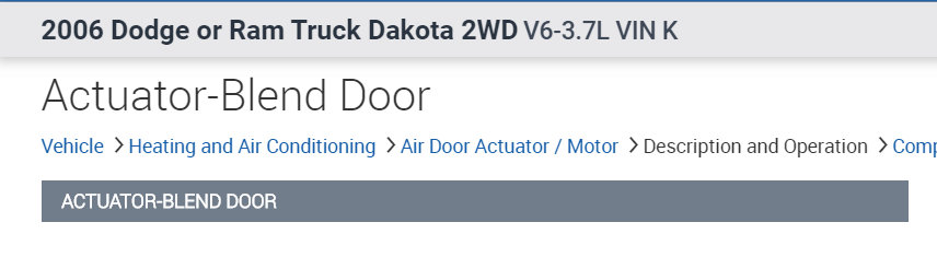

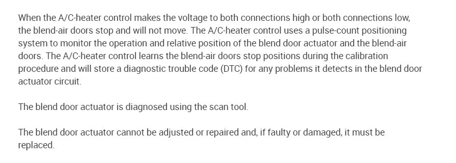

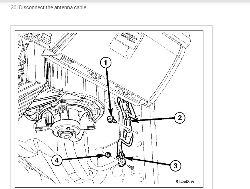

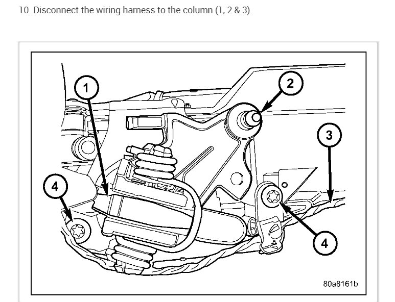

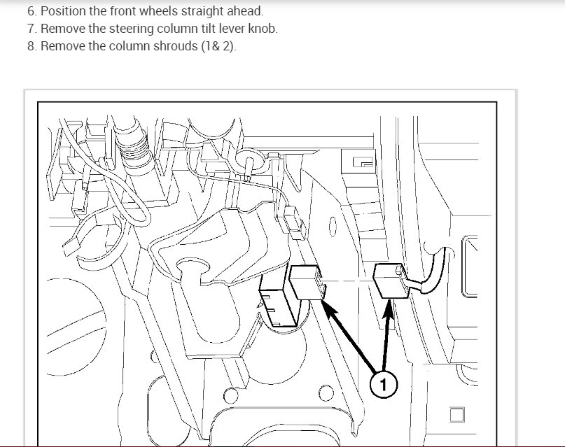

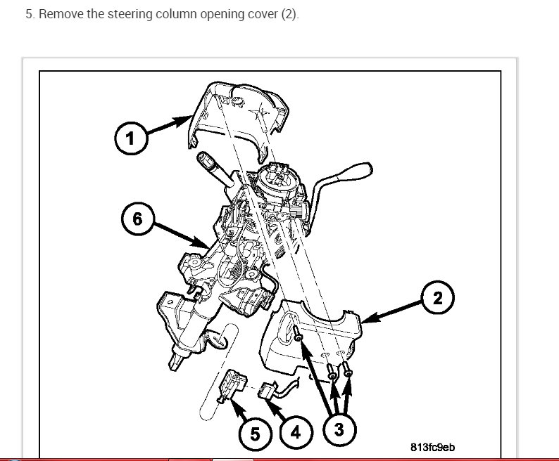

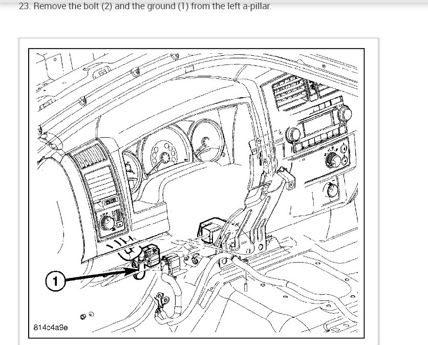

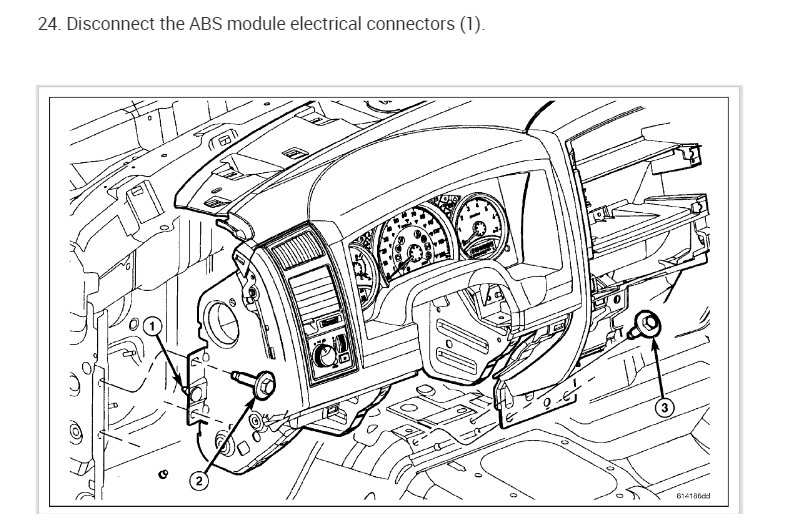

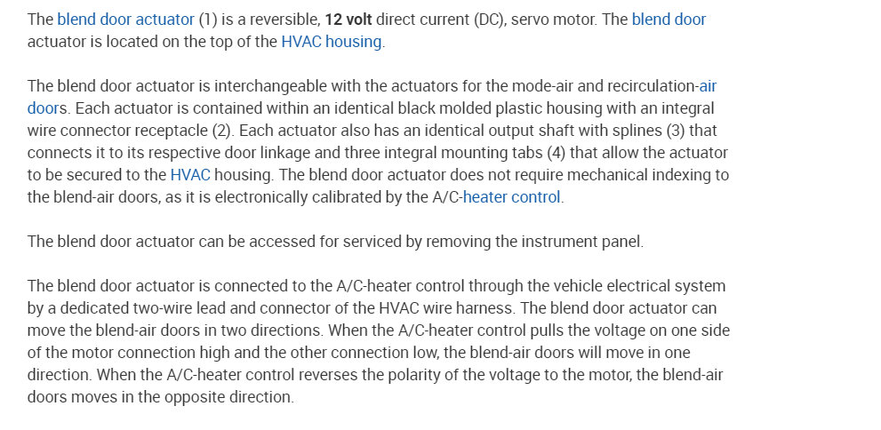

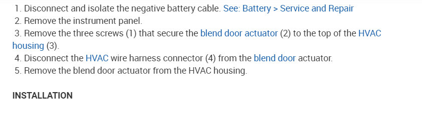

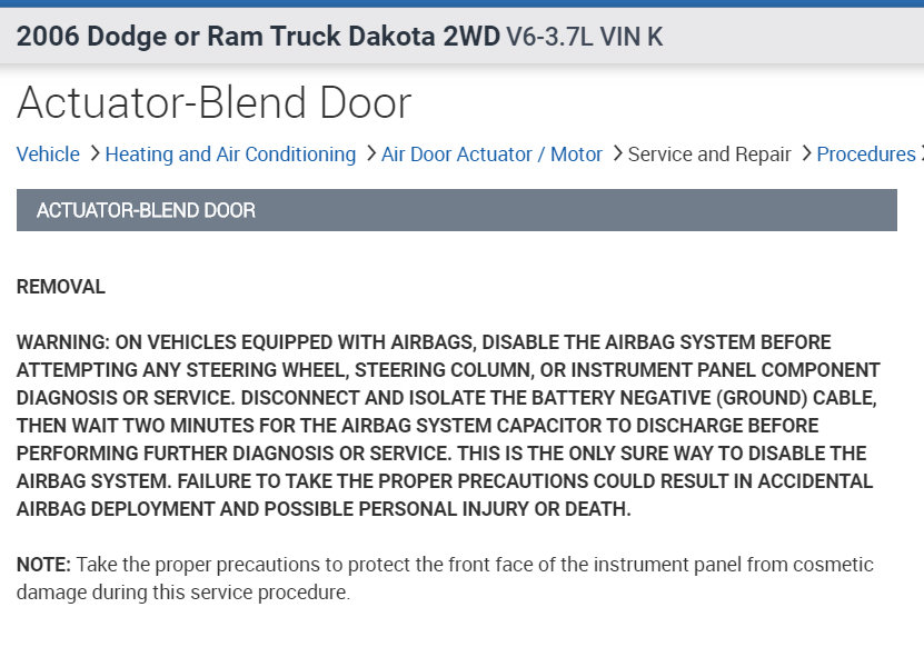

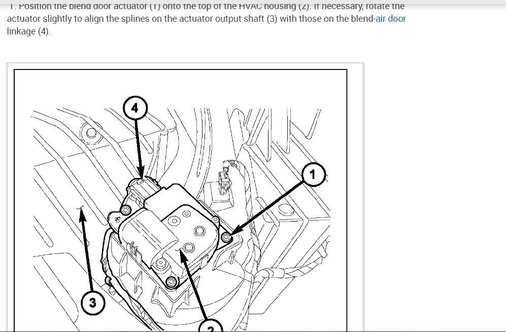

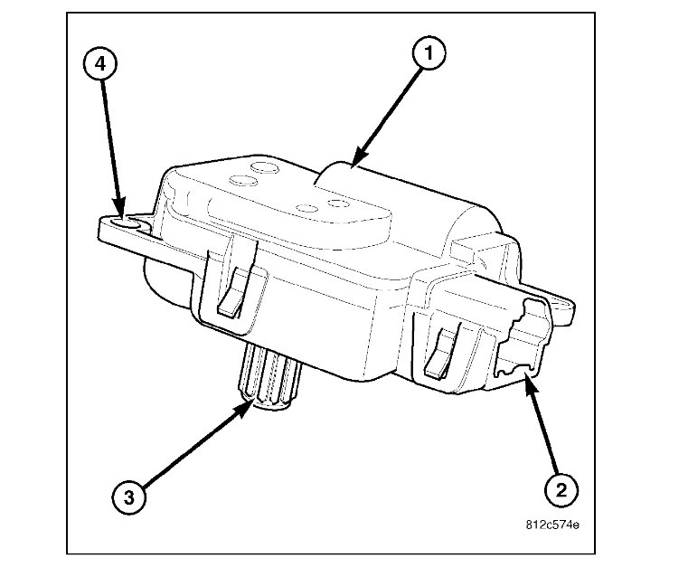

Location of blend door? what to remove to access the part to change? after replacing is there a need to scan or any other requirement prior to use? Because of the time required for a mechanic, I need to do this myself. The control that causes the most "machine gun noise" on my vehicle listed above, is the center control that has the blue to red marking and when changing from one temperature to another the noise starts. Also at time I hear one click noise when the fan speed is changer or the control that sends the air to the different outlets. Maybe the blend door actuator replacement fixes it all. Need to find out the location and what needs to be remove for access to the door and then after replacing it, is there any adjustments, etc, necessary?
Nov 6, 2019 at 8:32 AM
SCGRANTURISMO
  • 4,897 POSTS
I have included the information that you requested in the diagrams down below. Please go through this information and get back to us with how everything turns out.
Thanks,
Alex

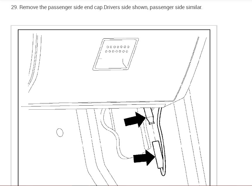

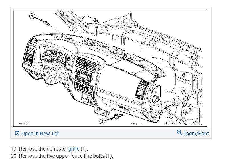

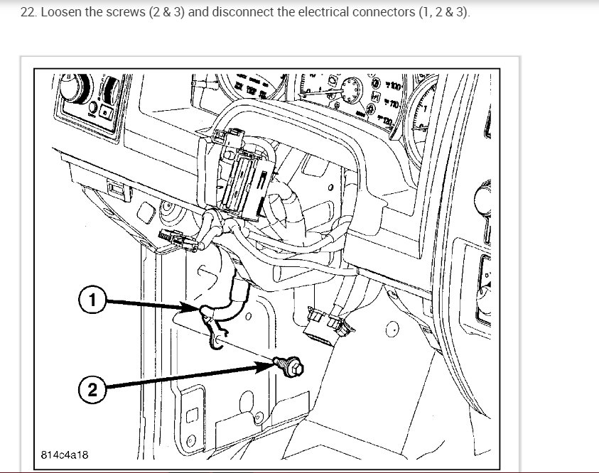

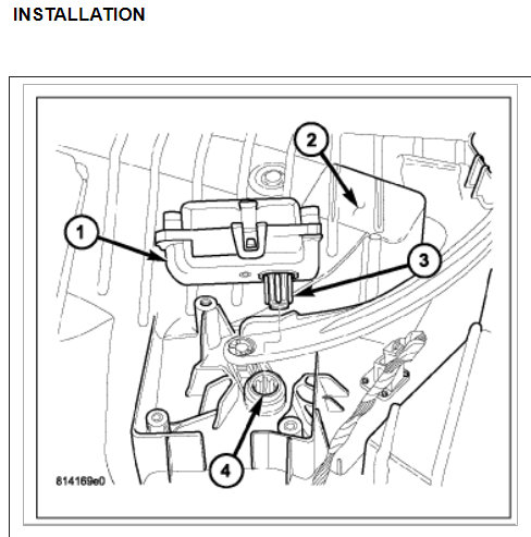

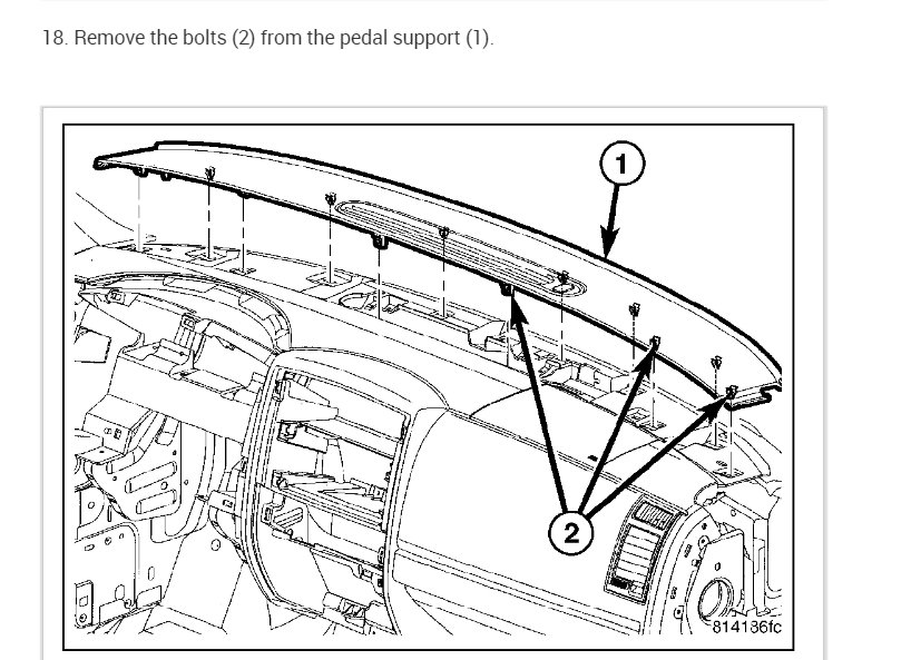

CHARLIE LUSE

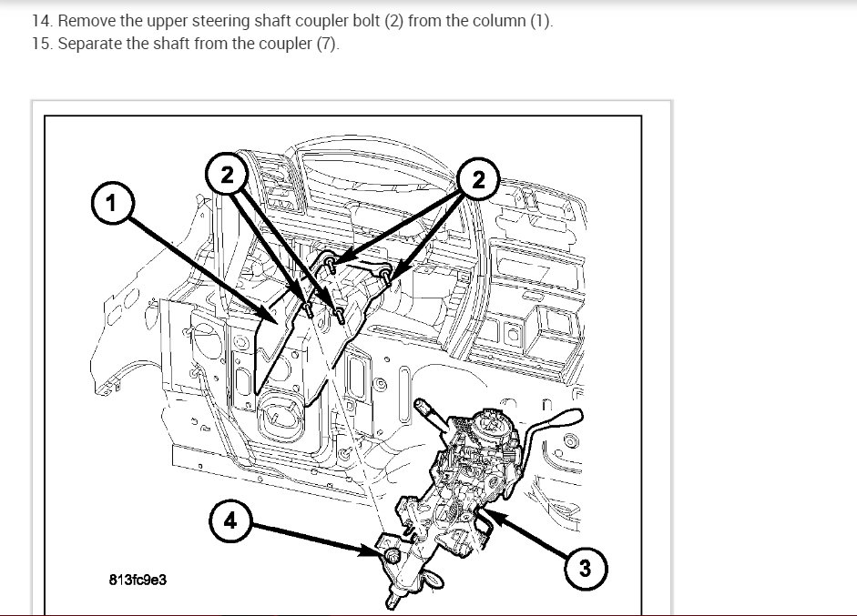

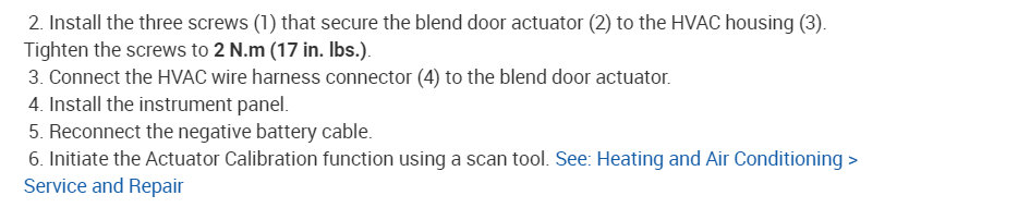

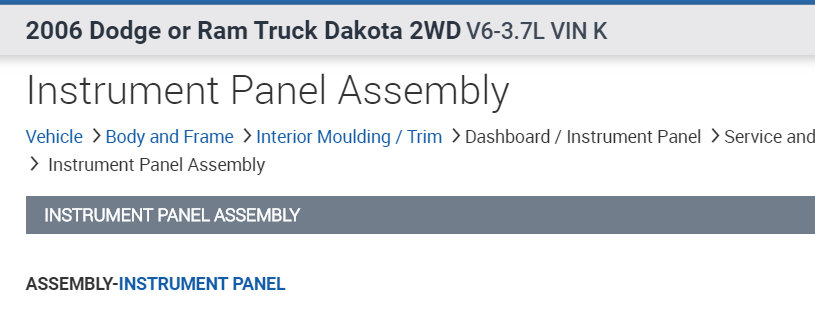

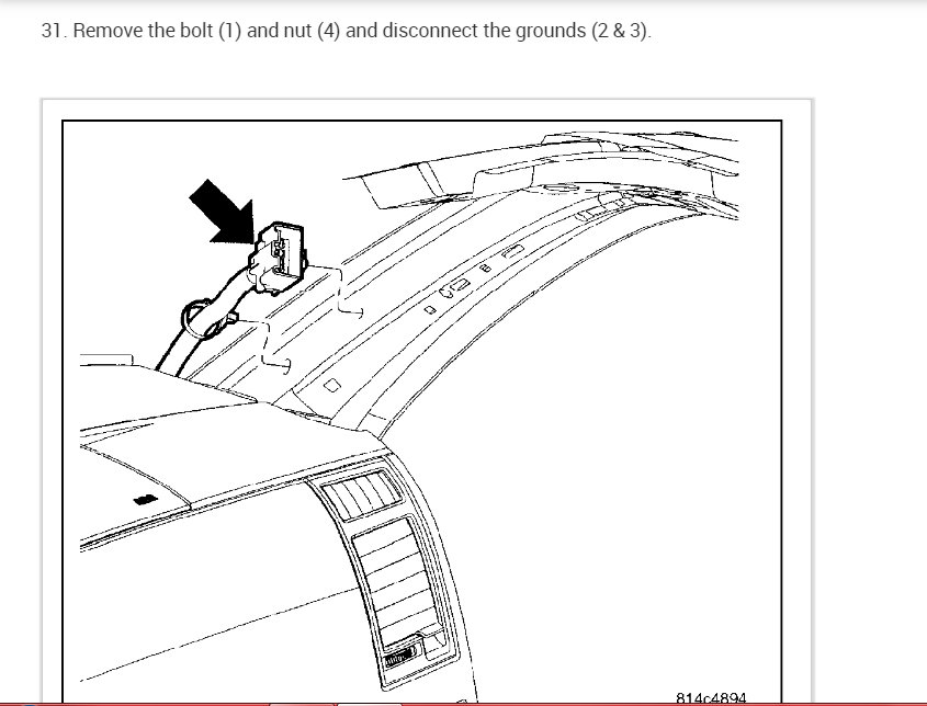

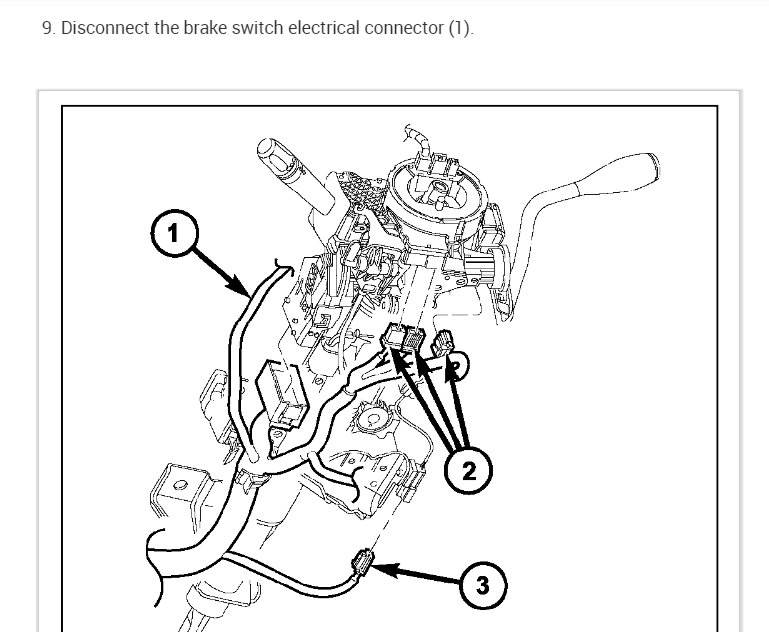

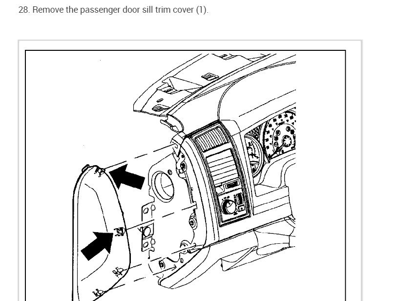

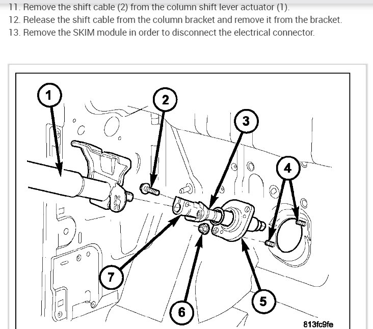

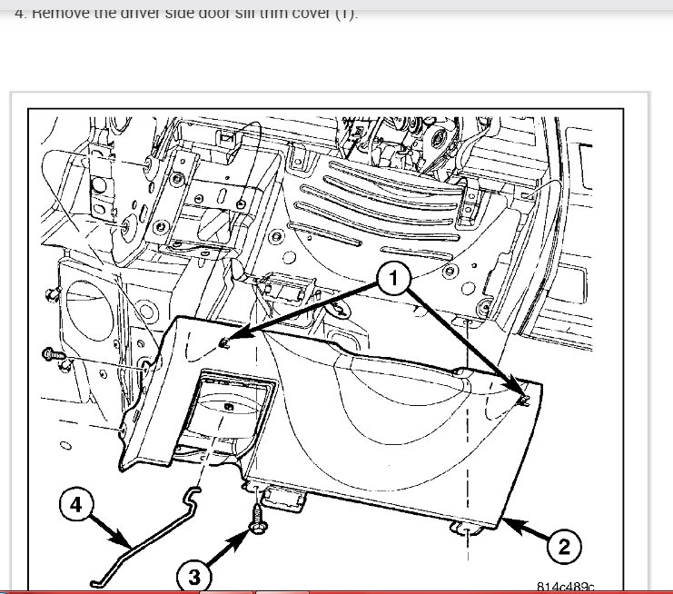

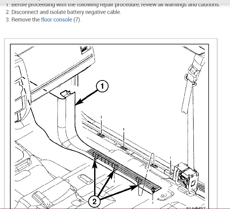

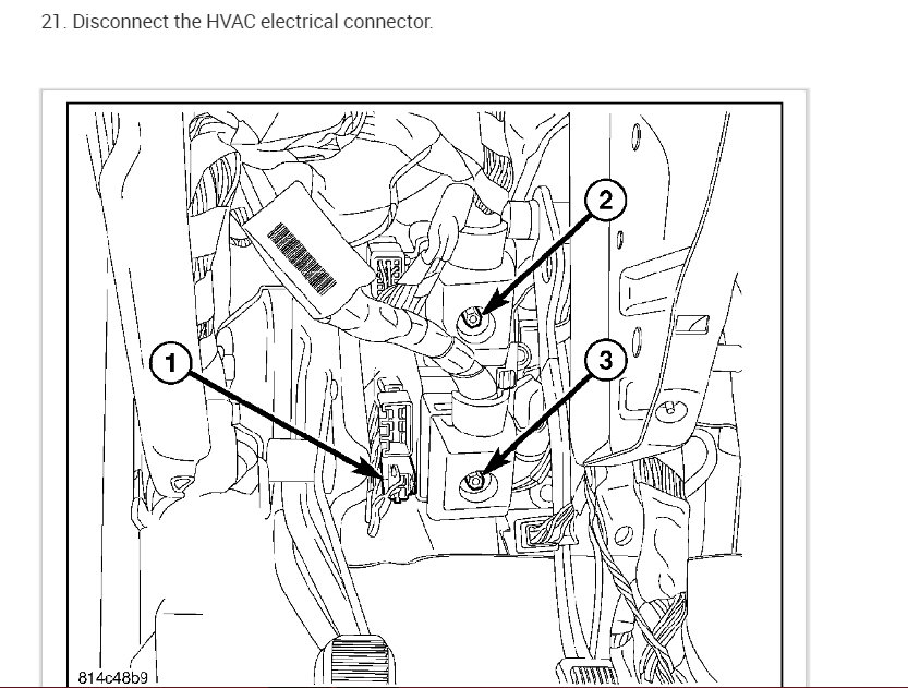

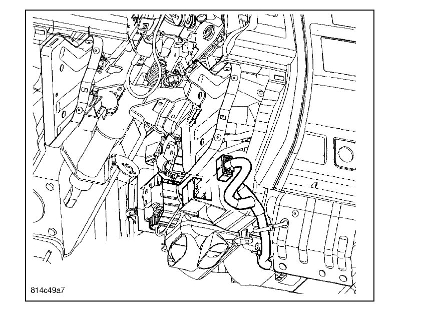

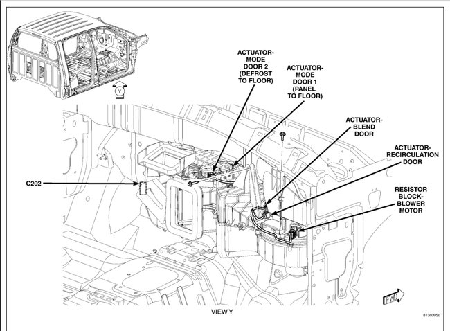

Good information for me as an 85 year old that needs to do this with help of my adopted son of 19. Need to know how to remove the instrument panel, as I guess the actuator is behind the radio panel. Not sure about the need to use a "scan tool" as I do not know what it is or where to get it and I guess it calibrates the correct movement of the door . But first, need to know how much of the instrument panel to remove? Thanks. Charlie
Nov 6, 2019 at 11:38 AM
SCGRANTURISMO
  • 4,897 POSTS

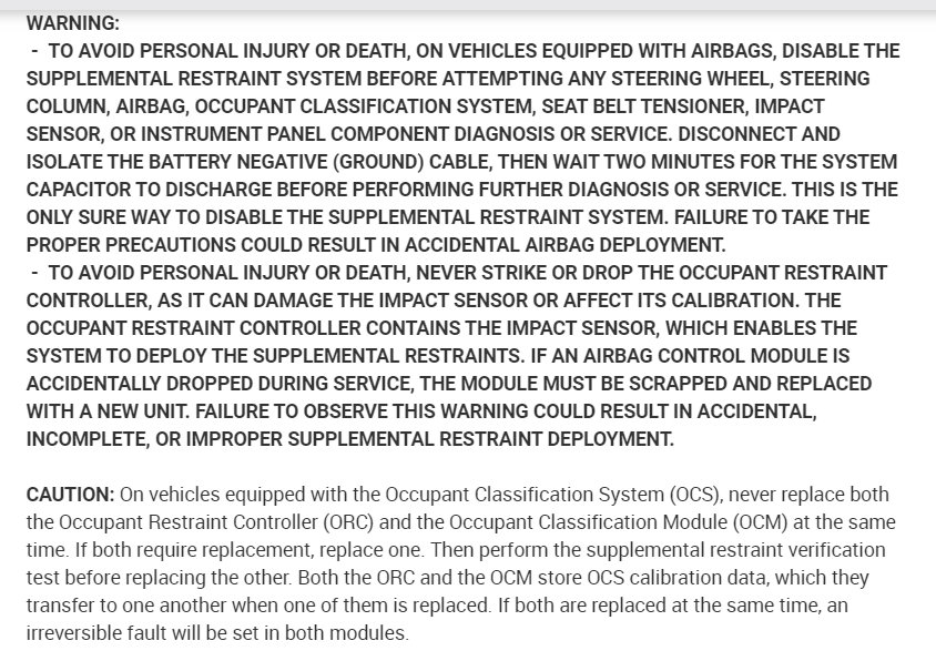

Hello again,
I have included the information that you requested in the diagrams down below. The installation process is going to be the reverse of the removal process. Please make sure that the negative battery terminal is taken off of the battery for at least one hour, to be safe, so as not to deploy the airbags accidentally, and use care when working around them. Please get back to us with how everything turns out.
Thanks,
Alex
2CarPros

Most likely a bad Blend door actuator in the dash.

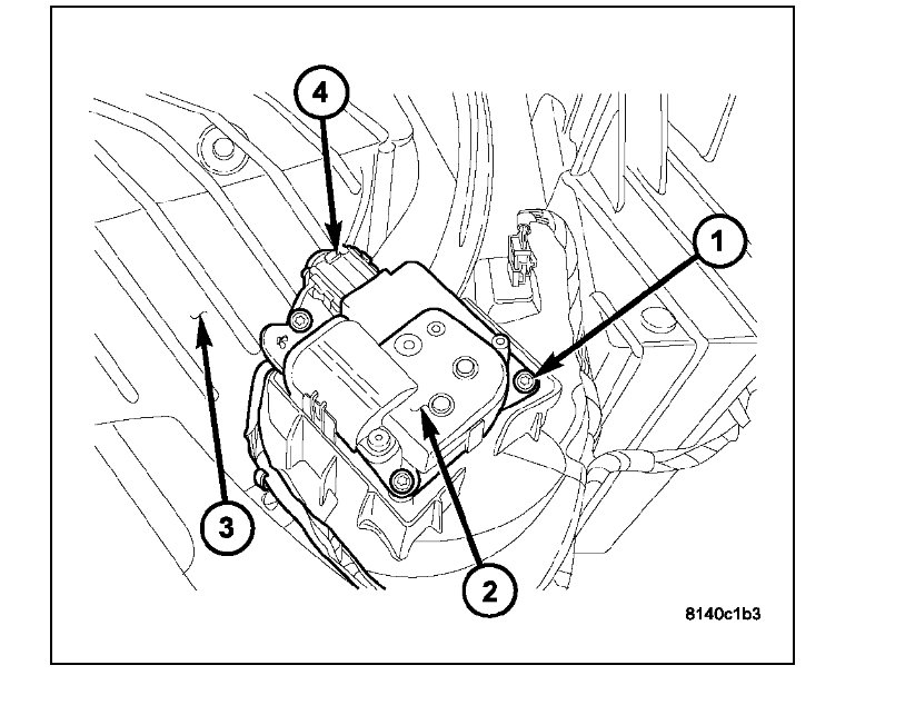

LEWISPERKINS
Diagram of the blend door acuator and location
Dec 1, 2020 at 4:08 AM (Merged)

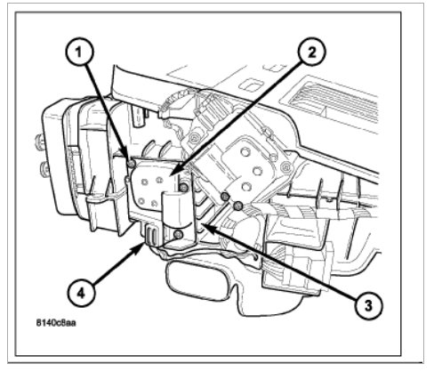

Heater only blows cold. Radiator and reservoir are full, heater core isn't clogged. I can cycle through all vent locations and blower speeds. Is my temperature control bad or is the heater blend door actuator bad? If it is the actuator, where is it located?
Dec 1, 2020 at 4:09 AM (Merged)

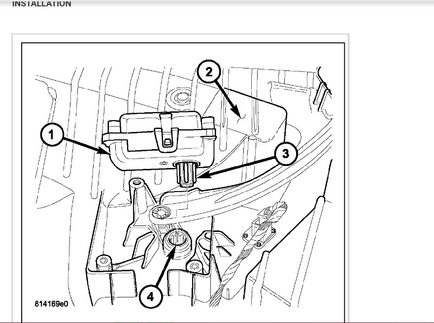

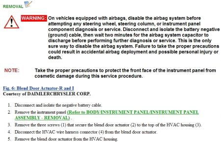

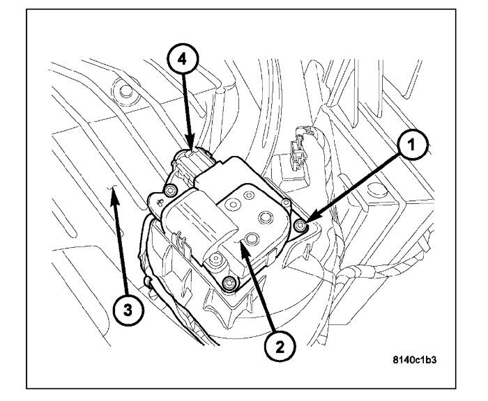

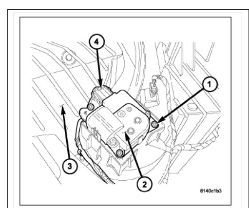

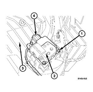

Good afternoon,
When you command heat and cool, can you hear the mode door move inside the dash?
It could also be a clogged heater core.
1. Disconnect and isolate the negative battery cable. See: Battery > Service and Repair
2. Remove the instrument panel.
3. Remove the three screws (1) that secure the blend door actuator (2) to the top of the HVAC housing (3).
4. Disconnect the HVAC wire harness connector (4) from the blend door actuator.
5. Remove the blend door actuator from the HVAC housing.

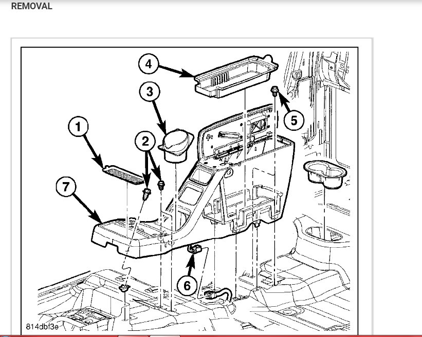

I am trying to replace the actuator motor for the inside/outside air door. I know its location, but it is a very tight fit. Chilton's says to remove the instrument panel assembly (entire dash). Is there a way to get to it without removing the entire dash?

The cluster is on the driver's side and the actuator is on the passenger's side. You would have to somehow reach past the center console.

If you can take a picture and upload it in your reply so we can see what you are talking about it will help. here are some diagrams to help you see what you are in for.

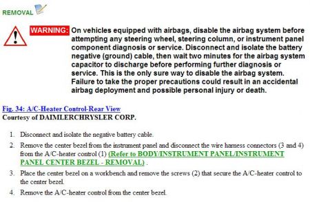

BLUELIGHTNIN6
  • 16,542 POSTS
Hello I have below the instructions on removal of the blend door actuator and the heater control. The blend door actuator is located on top of the HVAC housing which is inside the dash.
https://images.2carpros.com/forum/automotive_pictures/261618_Noname_1.jpg
https://images.2carpros.com/forum/automotive_pictures/261618_Graphic_10.jpg
https://images.2carpros.com/forum/automotive_pictures/261618_Noname_2.jpg
https://images.2carpros.com/forum/automotive_pictures/261618_Graphic_11.jpg
Hope this helps. Thanks for using 2carpros.com!
