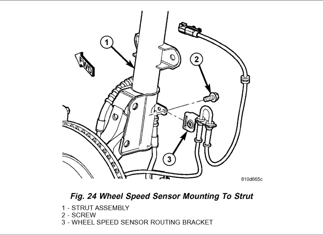

Good morning,

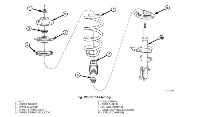

There is a torque value for the nut that holds the sturt. I attached it here. If you cannot get this torque, you will need to replace the strut.
https://www.2carpros.com/articles/replace-shock-absorber
Install Strut Nut Wrench (on end of a torque wrench), Special Tool 6864, on strut shaft retaining nut (Fig. 30). Next, install a 10 mm socket onto hex on end of strut shaft. While holding strut shaft from turning, tighten strut shaft retaining nut to a torque of 115 Nm (85 ft. lbs.).
Please let us know if you have any other questions.

4. Remove screw fastening wheel speed sensor routing bracket to strut assembly (Fig. 24).

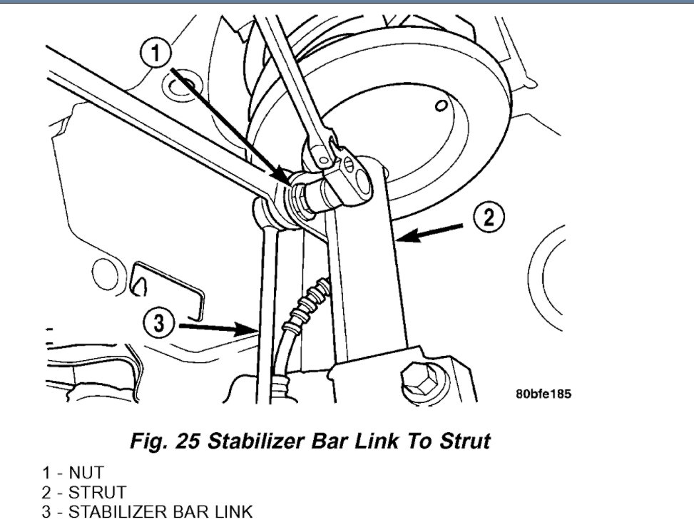

CAUTION: When removing nut from stud of stabilizer bar link, do not allow stud to rotate in it's socket. Hold stud from rotating by placing an open-end wrench on flat machined into stud (Fig. 25).
5. Remove stabilizer bar link from bracket on strut assembly (Fig. 25). To do so, place an open-end wrench on flat machined into link's mounting stud, then remove nut while holding wrench in place. Push stud out of bracket.

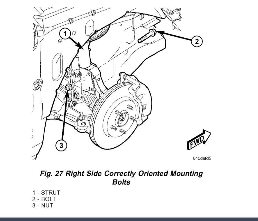

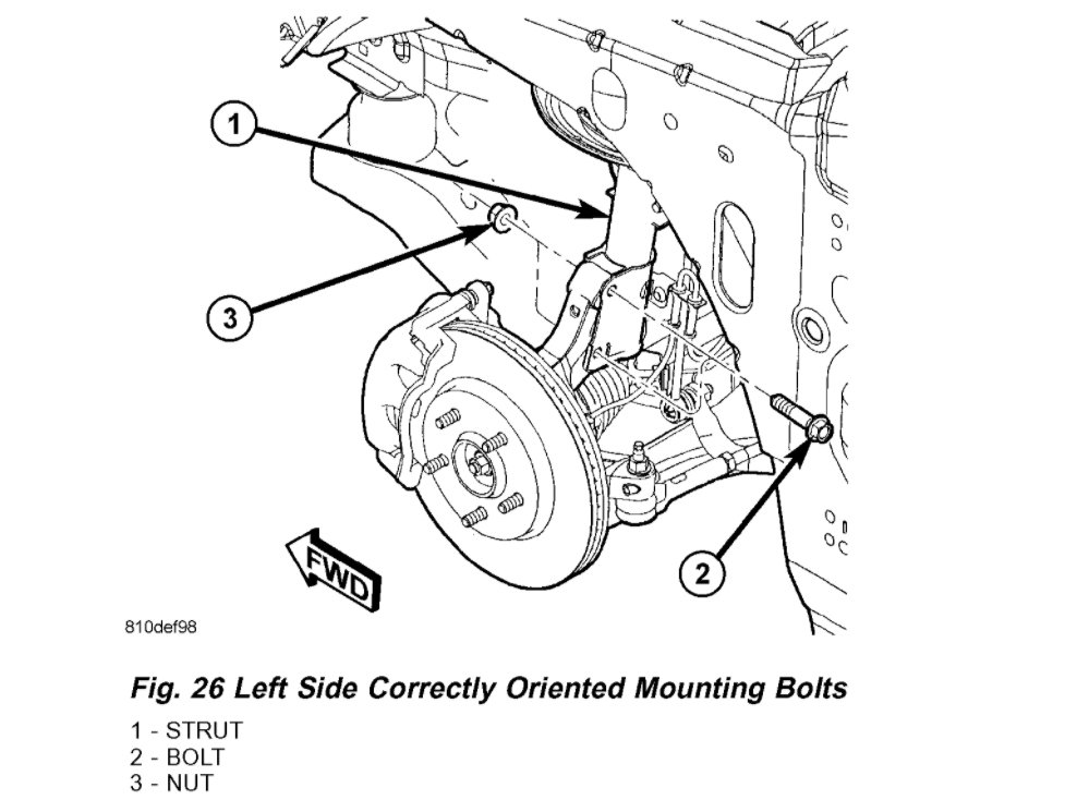

CAUTION: The steering knuckle to strut assembly attaching bolts are serrated and must not be turned during removal. Remove nuts while holding bolts stationary in steering knuckles.
6. Remove two bolts and nuts attaching strut clevis to steering knuckle (Fig. 26) (Fig. 27).

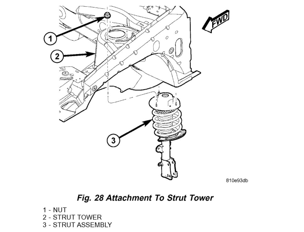

8. Remove three nuts attaching strut assembly upper mount to strut tower (Fig. 28), then remove strut assembly from vehicle.

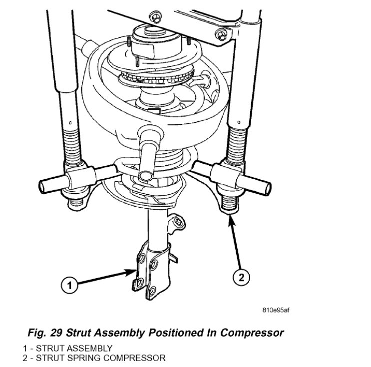

For disassembly and assembly of strut assembly, use of Strut Spring Compressor, Pentastar Service Equipment (PSE) tool W-7200, or equivalent, is recommended to compress coil spring. Follow manufacturer's instructions closely.
WARNING: DO NOT REMOVE STRUT SHAFT NUT BEFORE COIL SPRING IS COMPRESSED. COIL SPRING IS HELD UNDER PRESSURE AND MUST BE COMPRESSED, REMOVING SPRING TENSION FROM UPPER MOUNT AND PIVOT BEARING, BEFORE SHAFT NUT IS REMOVED.
1. Position strut assembly in strut coil spring compressor following manufacturers instructions (Fig. 29). Position lower hooks on coil spring first, then uppers.
2. Compress coil spring until all coil spring tension is removed from upper mount.
