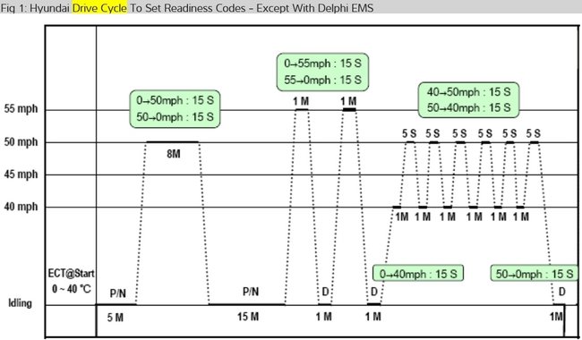

when I have the shop replace my o2 sensor that is causing my engine light to come on it will say not ready or that I have to drive a certain amount of miles to make sure the light does not come back on. How do I bypass this? I need this light to go off so that it will pass inspection. How can I or a shop bypass this light?

it may be something other than the O2 sensor causing this you need ascanner to turn light off

I was just kicking around, found this for drive cycle.
