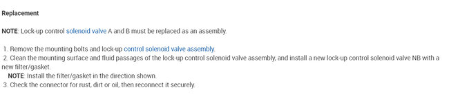

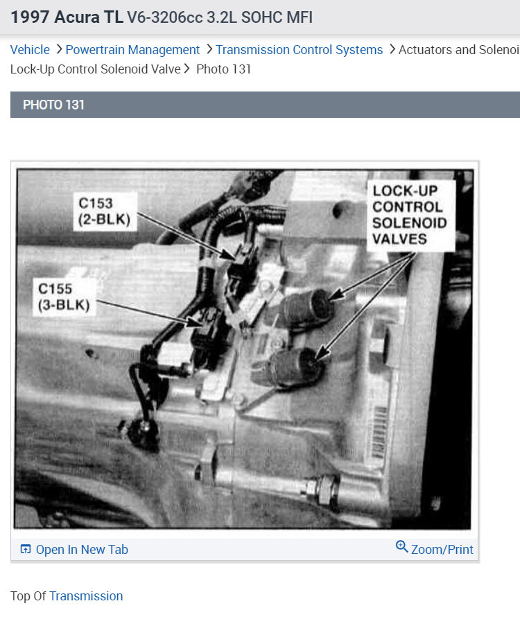

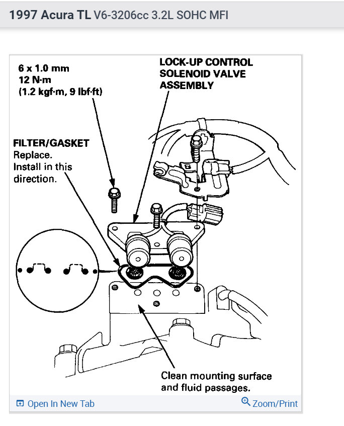

I just want to know if Lockup Solenoid “B” can be replaced without taking out my transmission. I want to do it myself instead of taking it to a dealership and paying an arm and a leg.
Jul 10, 2023 at 11:09 PM
  • 55,456 POSTS
Yes, you can there are mounted on the outside of the transmission. Lucky you! Here are the instructions on how to replace the converter clutch lock up solenoids. Check out the images (below). Please let us know if you need anything else to get the problem fixed.
