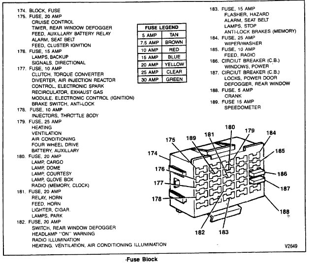

I attached a pic below of the fuse box. Let me know if that is what you need. Also, is it possible for you to take a pic of the panel you are referring to?
Let me know. Also, let me know what is happening, hopefully, I'll have a few ideas that will be helpful.

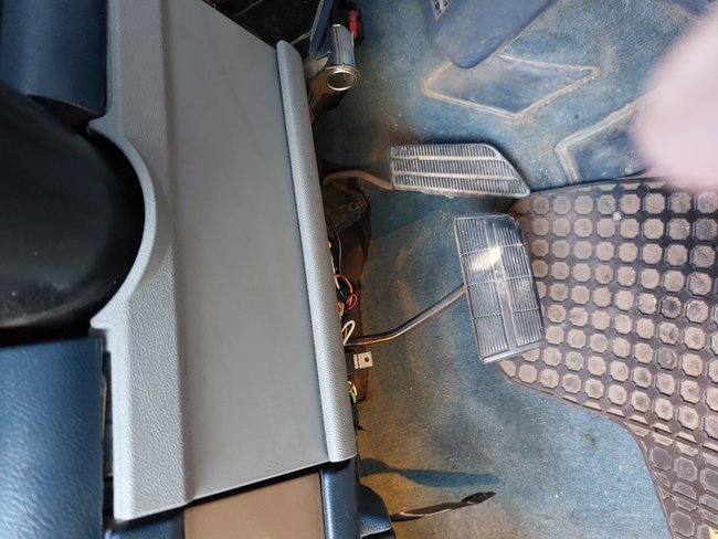

It's not the fuse box panel at all, it's the panel to the right of the fuse. It's like an inspection panel to check wires under the dash. i just need the proper name of that panel.

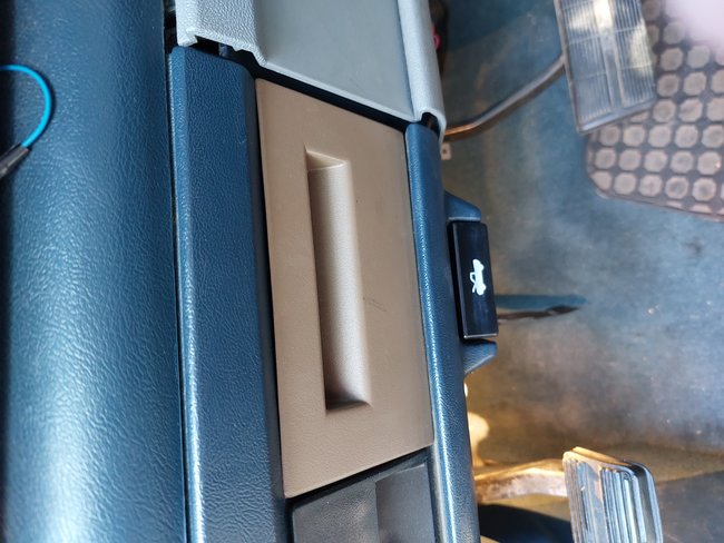

The brown panel on the right is my fuse panel. The other pic is the one i need the name of. It is below my steering wheel. Thanks

Hi Tom, the plastic cover is called a knee bolster. It's designed to prevent your knees/legs from hitting any of the hard surfaces under the dash in the event of an accident.
On your vehicle, there should be four mounting screws holding it in place.

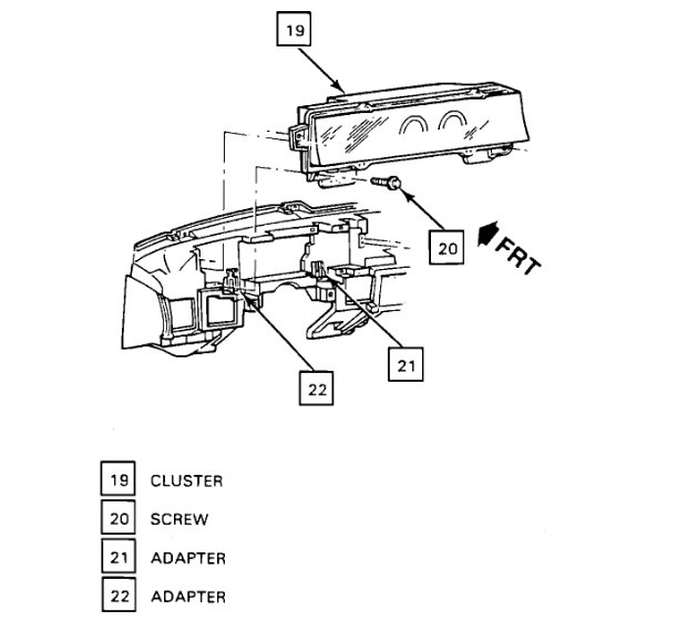

a pic of the dashboard on the driver's side. Thanks

I'm sorry, but I checked for pics and there isn't anything listed. It may be because of the model year. The only thing I have is an exploded view of the instrument panel being removed, which I attached below.
I hope in some way, that helps.
See pic below.
