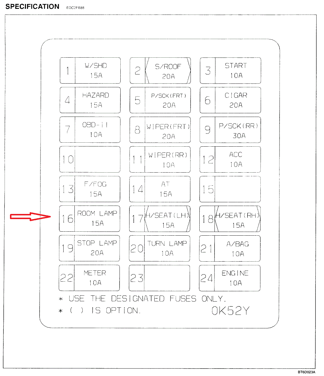

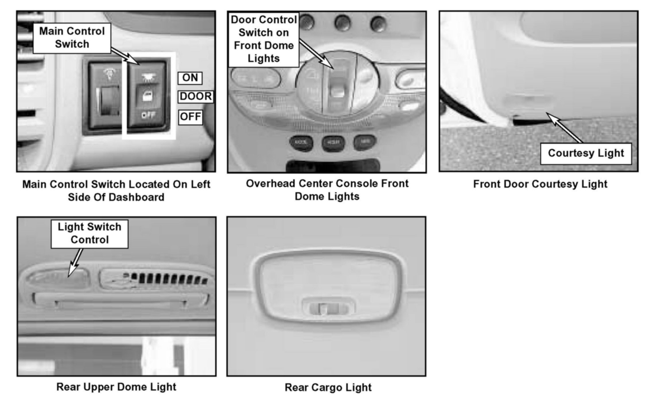

The inside lights will not come on when I open my doors.

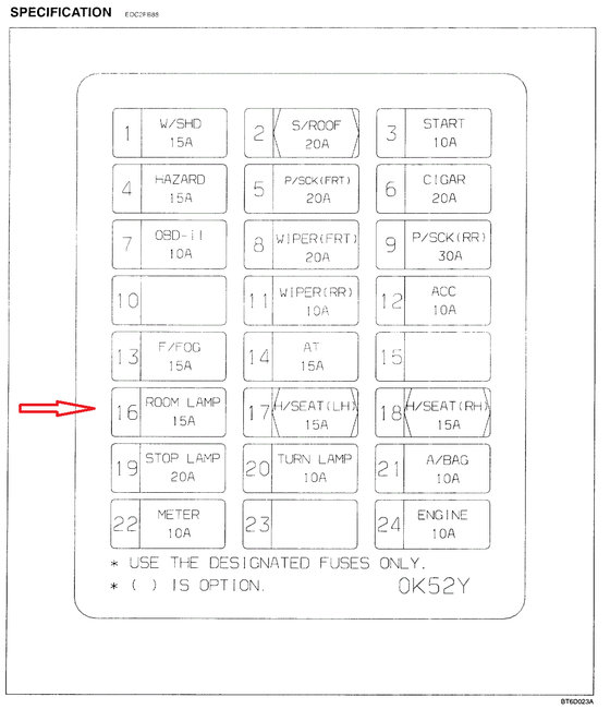

Verify the light switch is set for doors. If that is set up right then check fuse sixteen for an open. Let us know what you find.
