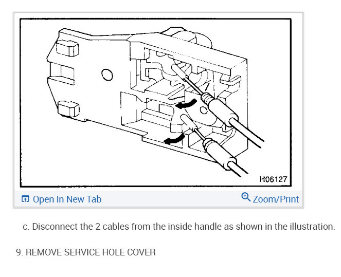

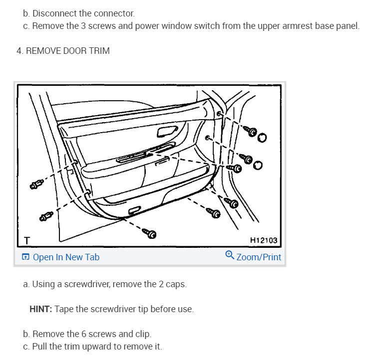

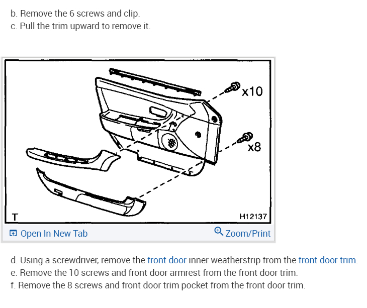

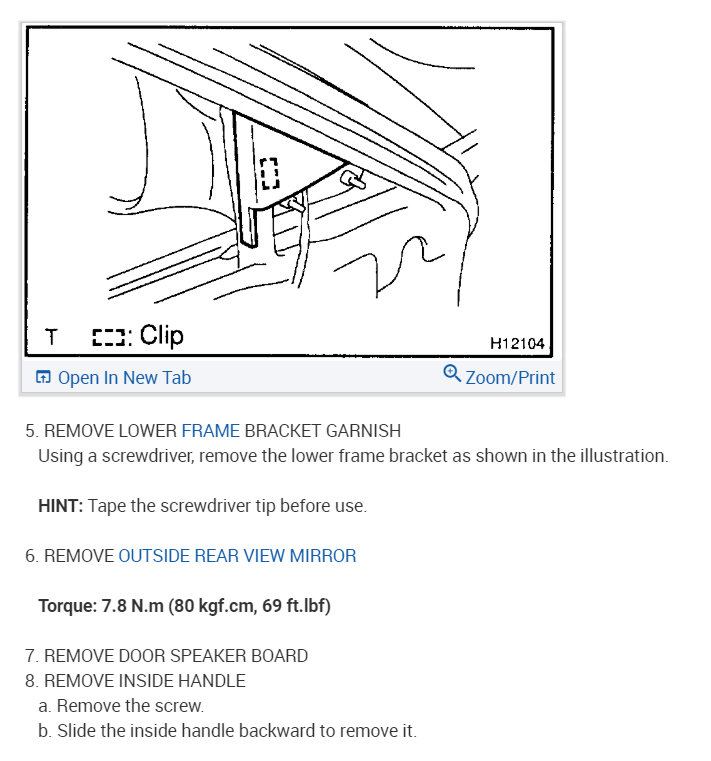

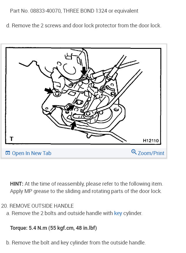

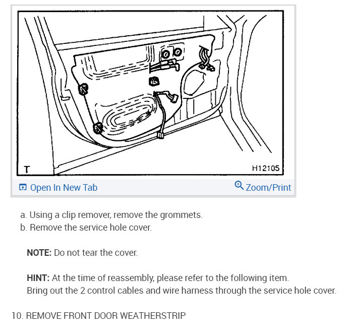

Drivers door lock will not engage to unlock
288,000 MILES • 6 CYL • 2WD • AUTOMATIC
RHONDA SOUTHERN

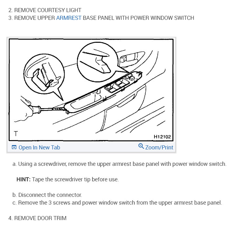

I have to crawl to other side to enter/exit car.
Nov 19, 2019 at 5:04 AM
  • 55,673 POSTS

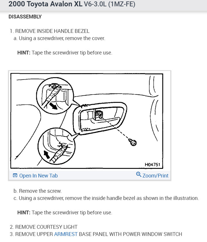

It sounds like the lock rod or inside door handle control rod has fallen off or broken. Here are diagrams to help you see what's going on you will need to remove the door panel. Check out the diagrams (below). Please let us know what you find. We are interested to see what it is.
