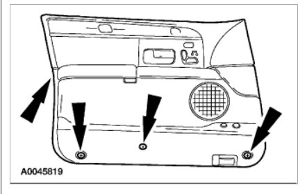

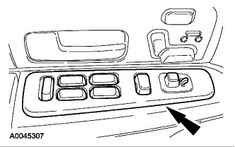

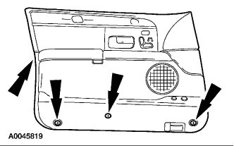

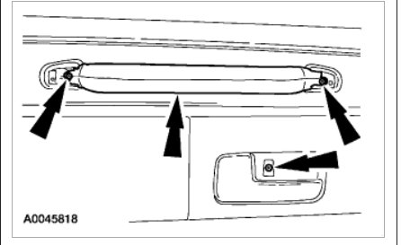

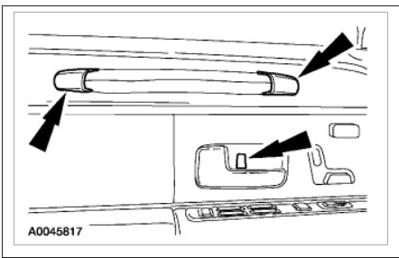

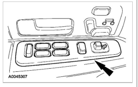

You will need to remove the inner trim panel and see if it is a problem at the handle end or more likely an issue with the latch end of the linkage. The switch panel is removed with a thin plastic or similar toll that you can gently pry it out of the panel.

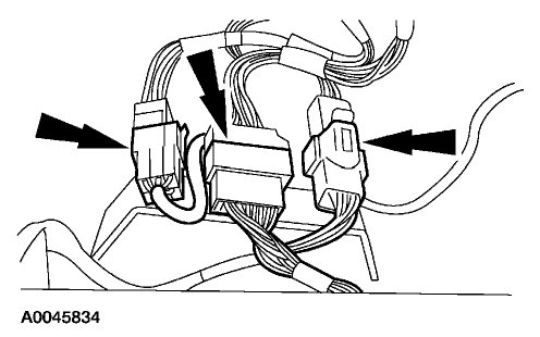

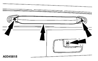

Then remove all the screws (they are under covers at the noted locations). Once the panel is off there will be a water shield behind it, do not damage it. You can usually peel them off. The linkage runs back to the latch.
If it is still connected at the latch but not moving, it could be rust/dirt in the lever or a bad latch. It could be the metal plate that the interior handle interfaces with the mechanism needs replacement

You can remove the the door panel and repair the handle by looking at what broken and fix it or get a new or used part. I have made a small metal clasp and screwed it to the handle so the rod/cable could be reconnected. Here are guides to show you how to get the panel off:
https://www.2carpros.com/articles/door-panel-removal

i had the same problem, door handle sticking out. opening door from the outside, i'm not a mencanic, but all i did was to losen
the two screws that hold the handle, & u hve 1 screw that's right
behind the handle, once u do that, take a flate head screw diver
& very gentel start pulling door panel outward, it has clips holding it, so be gentel.& once i did that the handle went back to
working again,it might just be stuck, just try that, if it works
