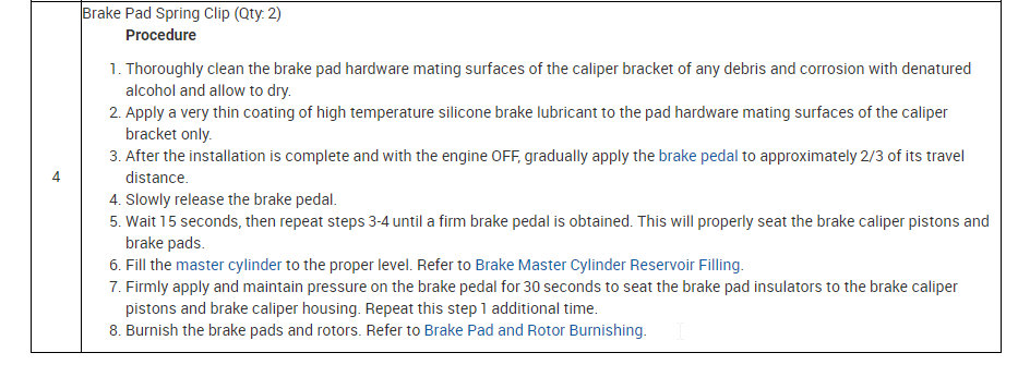

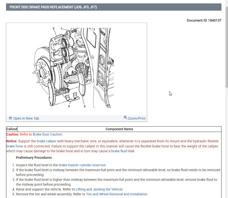

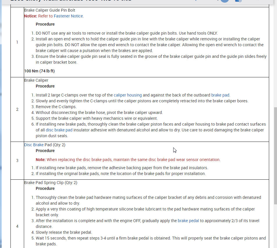

Also, below is the process from the manual on how to replace the pads. Let's run through this material and report back what you find.
