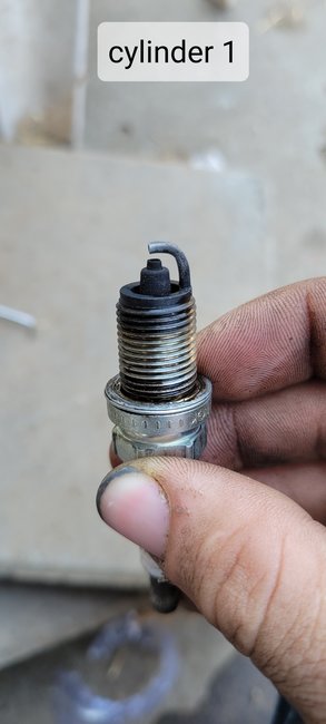

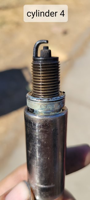

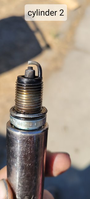

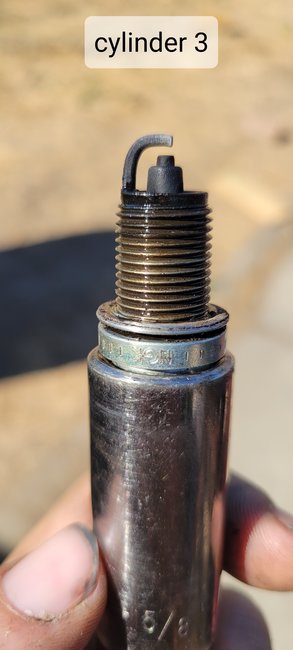

TSACOMA
I've included pictures of the spark plugs, and there is definitely oil and gas on them. When it is smoking it smells like burning oil, so I'd assume that it's not burning any coolant. And i haven't ran it in this state long enough to tell how much it's losing, but it's enough that you can barely see headlights through the cloud of smoke. It's done this three times in the last 24 hours and I'm concerned that I might cause damage by running it more than strictly necessary.

Okay. That is great info.
If this just started and is that bad, then I suspect you have blow by which means the rings are going out of it.
The compression is terrible, but I would suggest doing a leak down test. Basically you put the cylinders on TDC of the compression stroke and then remove the Schrader valve of your compression tester and put compressed air to the cylinder. Then you check the intake, exhaust, cooling system, and oil fill cap for any air escaping.
They make a gauge that will measure how much is escaping but you should not hear or feel much air coming out so if you do then it is too much.
Here is a video that will help with this. This is not produced by our site, but it is a decent video.
https://www.youtube.com/watch?v=WHli-wLy9_o
This could be valve guide seals, but it is unlikely to cause this much smoke. Plus, the fact that this is at high RPM points more to a ring issue.
