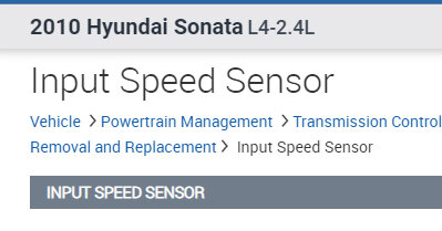

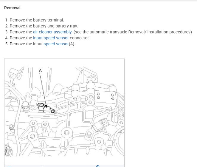

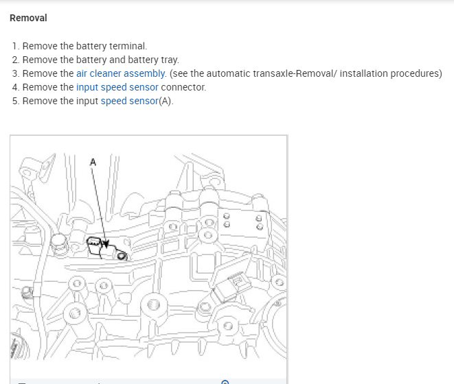

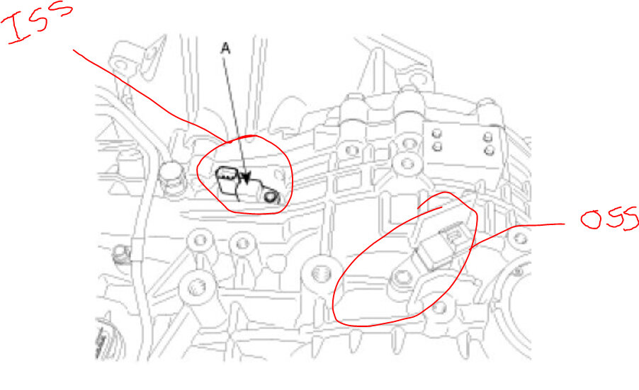

I'm looking for the location of this sensor.
Nov 23, 2022 at 2:27 PM
  • 110,240 POSTS
To access the input speed sensor, you need to remove the battery and battery tray,
I attached the directions below for replacing the sensor. Take a look through them and let me know if you have questions.

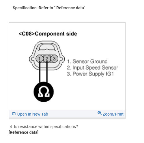

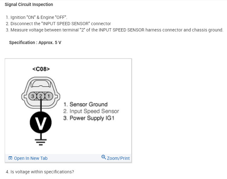

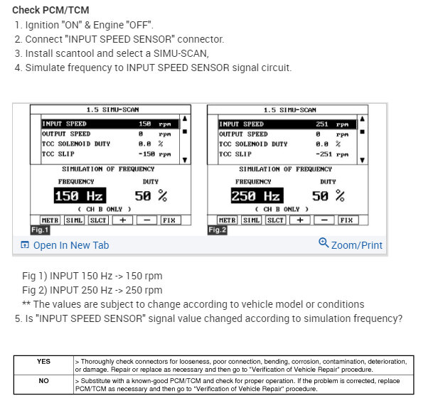

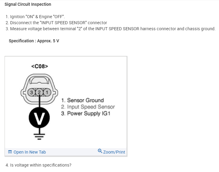

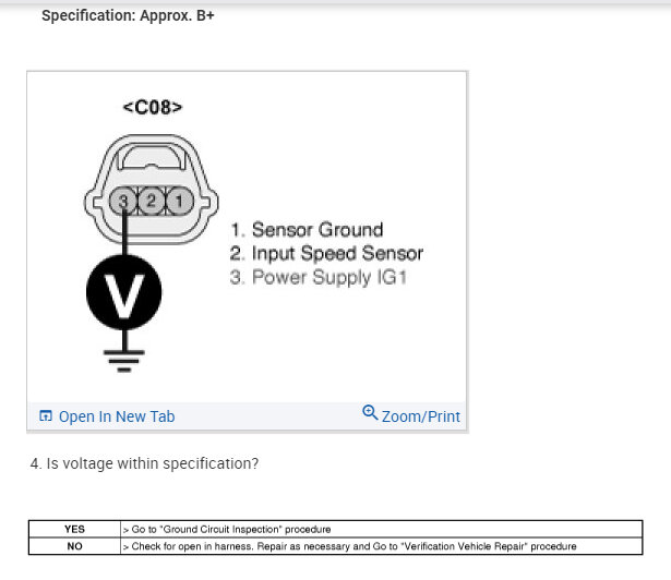

Thank you. Another question is, is the other sensor almost similar to the output speed sensor? I looked and there were two alike. These are the codes I'm trying to fix P0717-Input/Turbine Shaft Speed Sensor "A" Circuit No Signal any insight on it will be greatly appreciated!
Nov 23, 2022 at 3:49 PM
  • 110,240 POSTS

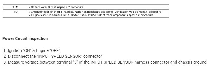

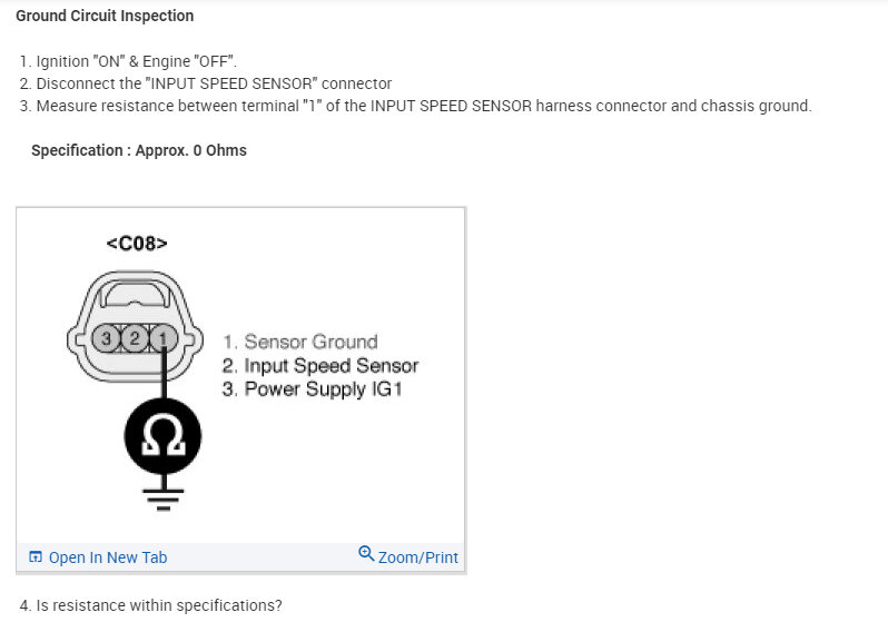

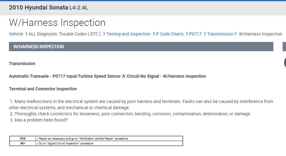

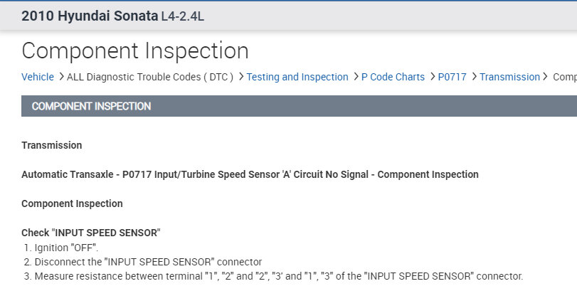

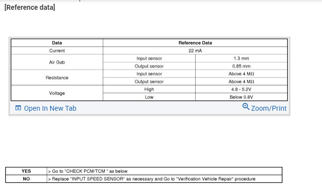

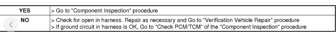

The code could indicate the sensor has failed, a wiring issue, or a control module issue.
Here is what I suggest. First, check the input speed sensor. The first 4 pics below are the directions for testing the sensor and wiring at the sensor. Do this first.
The next six are the procedures for testing the wiring, power supply, and ground.
As far as your question is concerned, yes, they are both located there and look alike. If you look at the very last pic below, I circled the two. ISS is the input speed sensor and OSS is the output speed sensor.
Let me know if this helps.
