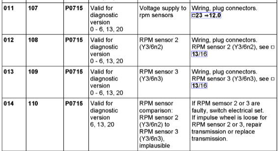

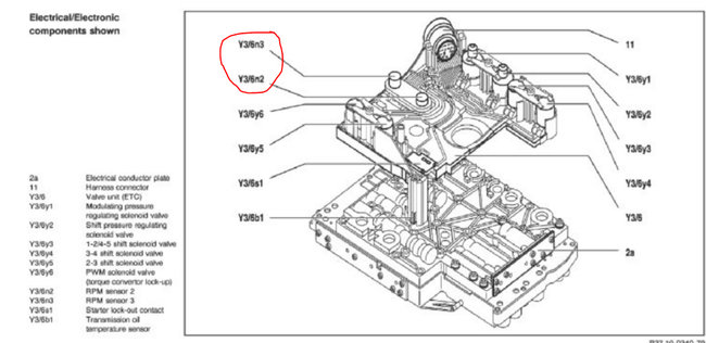

Hi, I got a P0715 and having difficulty shift or not shifting at all.. Wanted to know the location for the input shaft speed sensor. Input/Turbine Shaft Speed Sensor"A" Circuit
Thanks for the help.

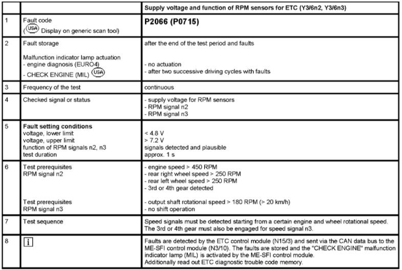

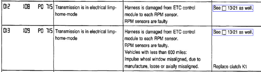

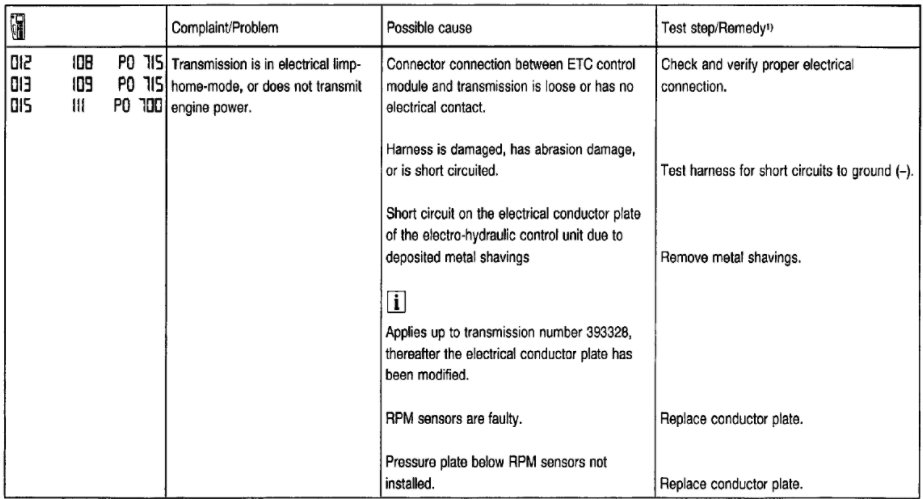

Hello, I'm Danny.
Here is the information you requested. I've attached picture diagnostic steps below relating to the code P0715. The pictures also include the location of the 2 RPM speed sensors in the transmission. Hope this helps and thanks for using 2CarPros.
