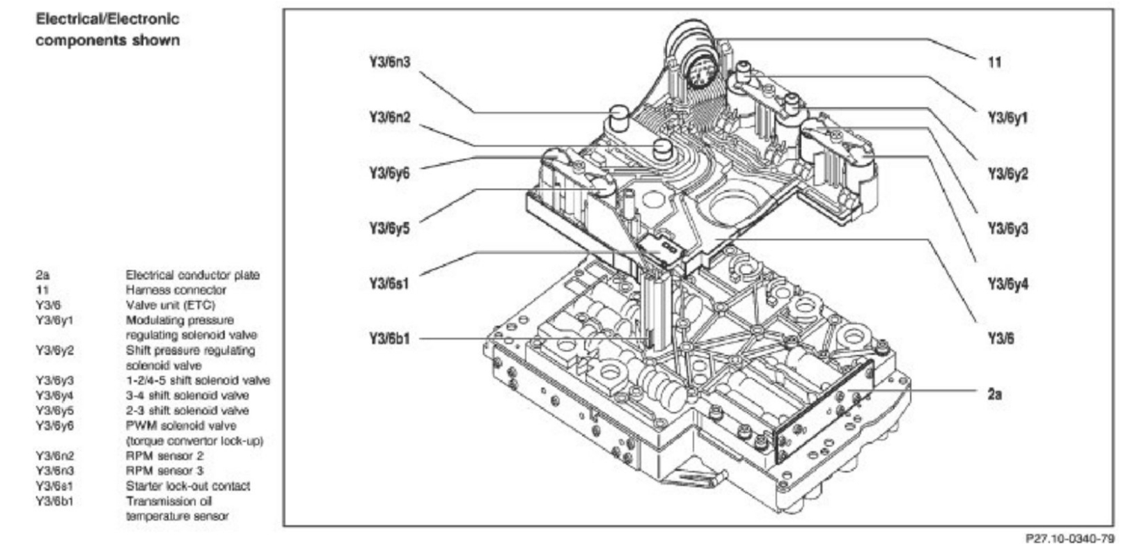

Input/turbine shaft speed sensor A circuit location?

Is this on the outside of transmission or inside? If outside, where is it located?

Yes, both speed input sensors are inside the transmission. Check out the images (below). Please let us know if you need anything else to get the problem fixed.
