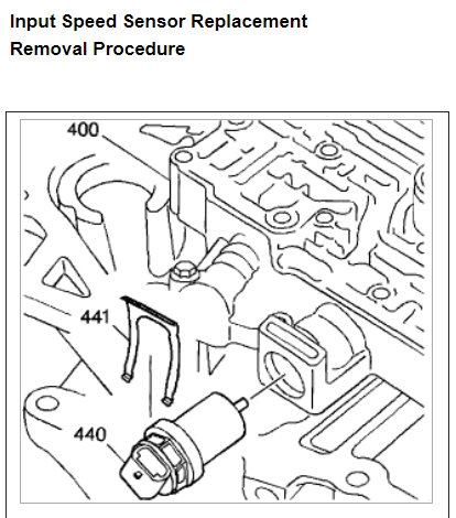

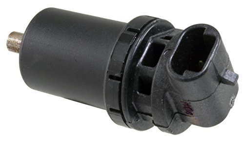

I have no speedometer. Will not shift out of first gear. I have replaced VSS and PCM. Still no change. I need to know where transmission input speed sensor location to install new one. Please help.
Jun 24, 2017 at 10:29 PM
WRENCHTECH
  • 20,761 POSTS
It is number 440 in this picture but that sensor will have no effect on the speedometer. https://www.2carpros.com/images/external/105997639.gif

That input sensor could effect your shifting problem but it has no effect on speed readings. if you are still having speedometer issues, you could have wiring problems or a defective output sensor. You really need a lab scope to test the signal coming out of the VSS sensor.

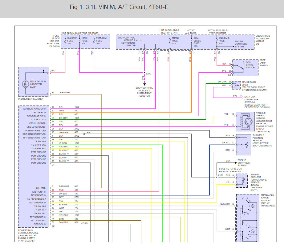

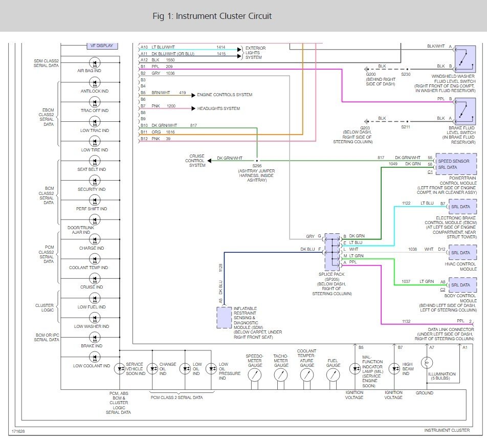

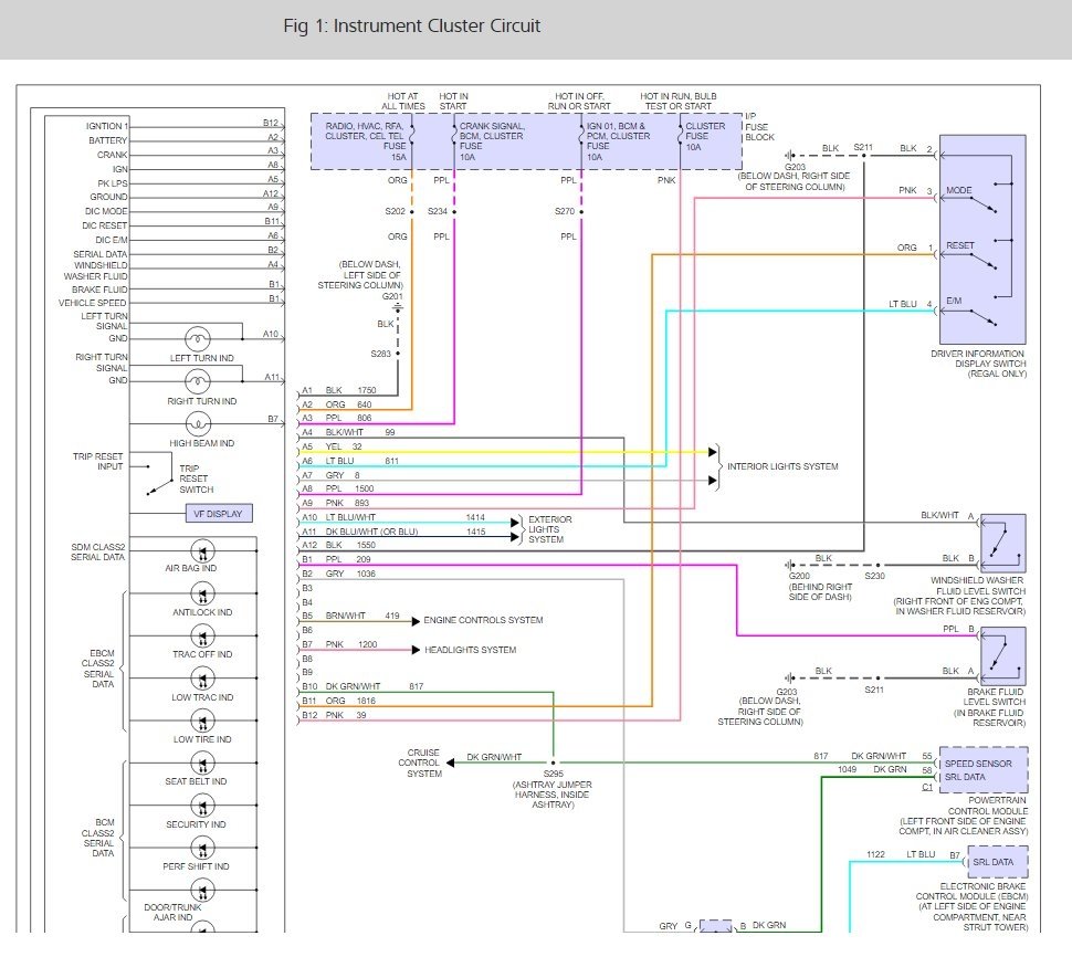

There is a fuse 10 amp hot when cranked over that sounds like it might be blown. Here is a wiring diagram for the cluster (below) so you can do some testing.
Please run this test and get back to us so we can continue helping you.

I feel a little stupid and relieved. It was a broken wire to vss

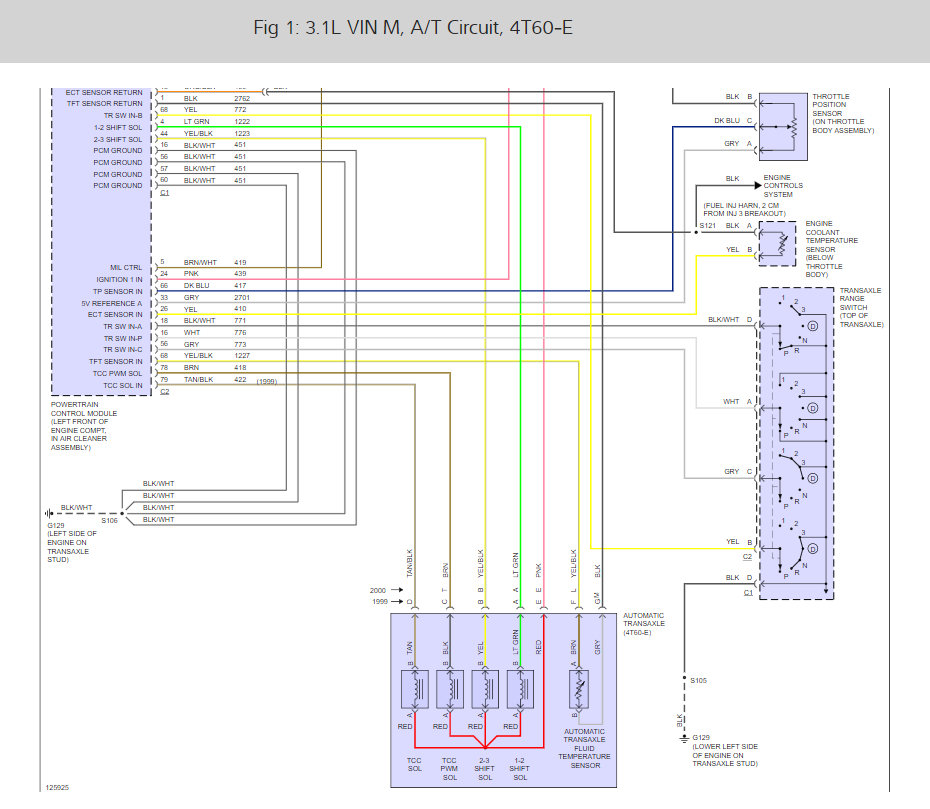

need help finding input speed sensor on 99 buick century 3.1 v6, i repllaced output sensor but need to replace input having shifting issues plz help. code pulled p0502
Jan 16, 2019 at 10:57 AM
  • 55,433 POSTS
This car does not have a input shaft speed sensor here are the transmission wiring diagrams to confirm the issue so you can see how it works. P0502 is for the VSS I would use this guide and the wiring diagrams to confirm the connection between the sensor and the PCM
Check out the diagrams (Below). Please let us know what you find.

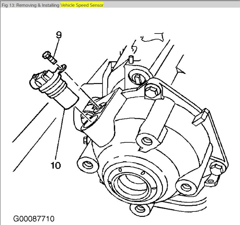

PATENTED_REPAIR_PRO
  • 1,853 POSTS
The vehicle speed sensor (VSS) is located on transaxle right axle case extension.
If you are wanting to replace it, it is probably best to remove the right front wheel to gain access.
Then simply unplug the harness connector, then unbolt the sensor and do not forget it has an o-ring. To install, reverse order. Tighten the bolt to 8 ft lbs.

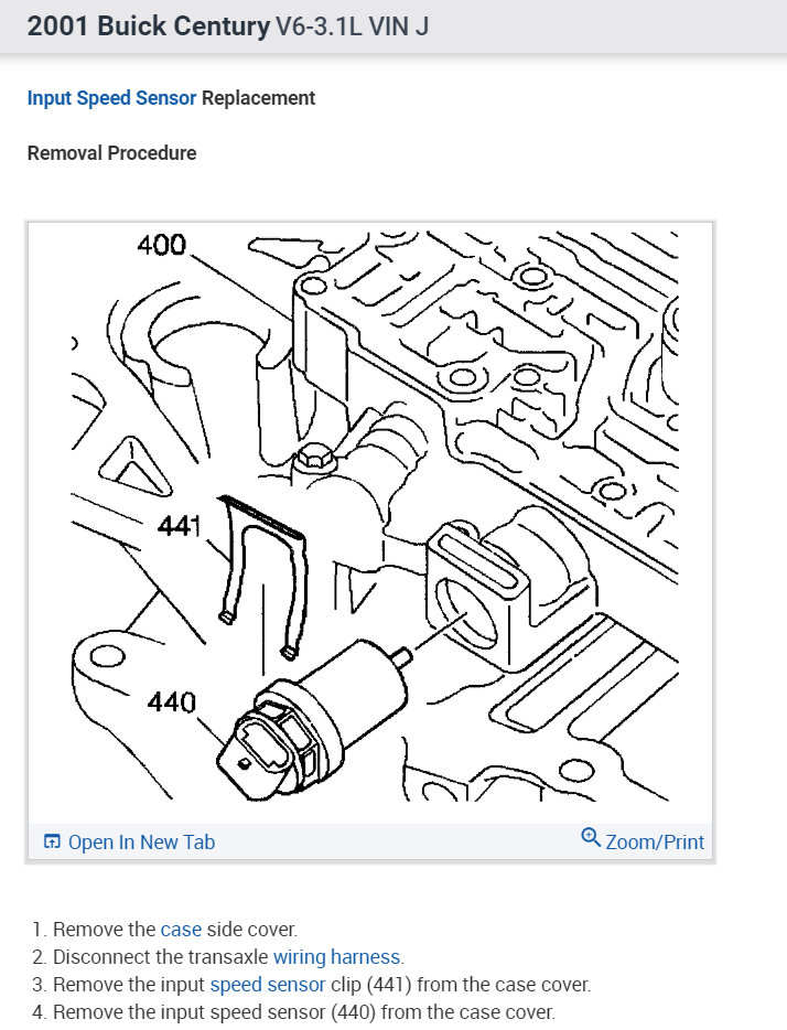

ERICBOSTWICK

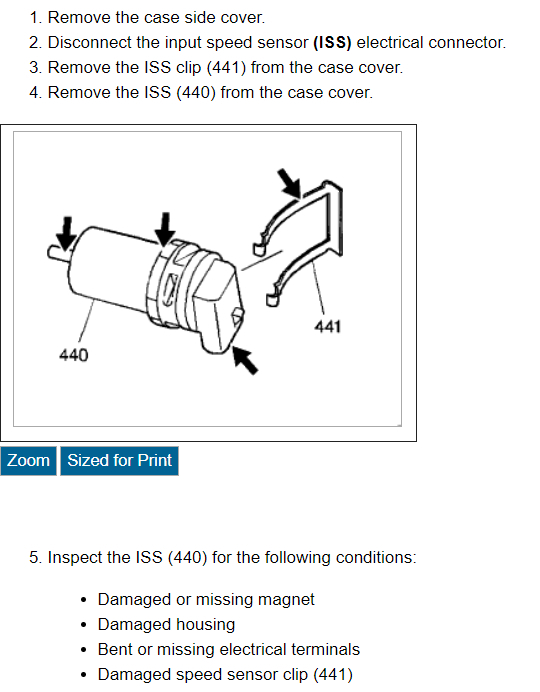

I am looking for the input speed sensor not the output.
Nov 26, 2019 at 11:59 AM (Merged)
  • 55,433 POSTS
It inside the transmission pan near the valve body. This guide will help you see what you are in for when dropping the pan so you can change the sensor out with diagrams below on how to do the job and the sensor location.
