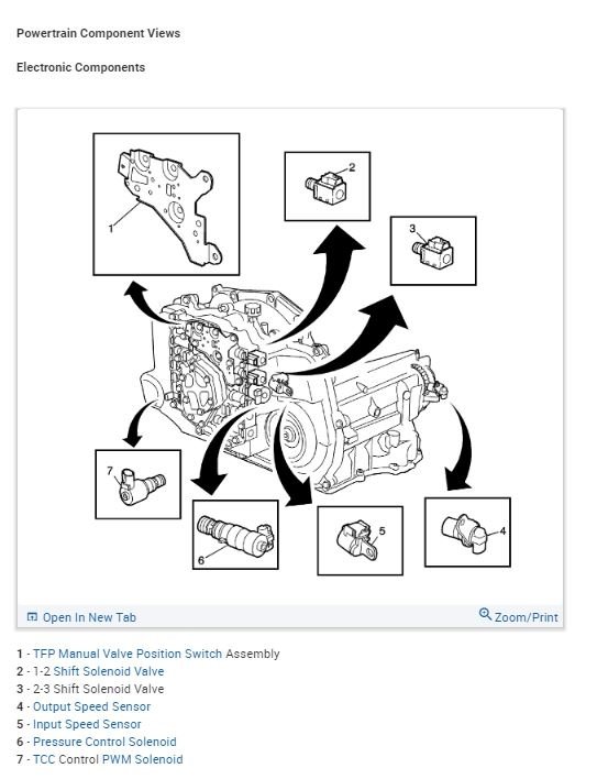

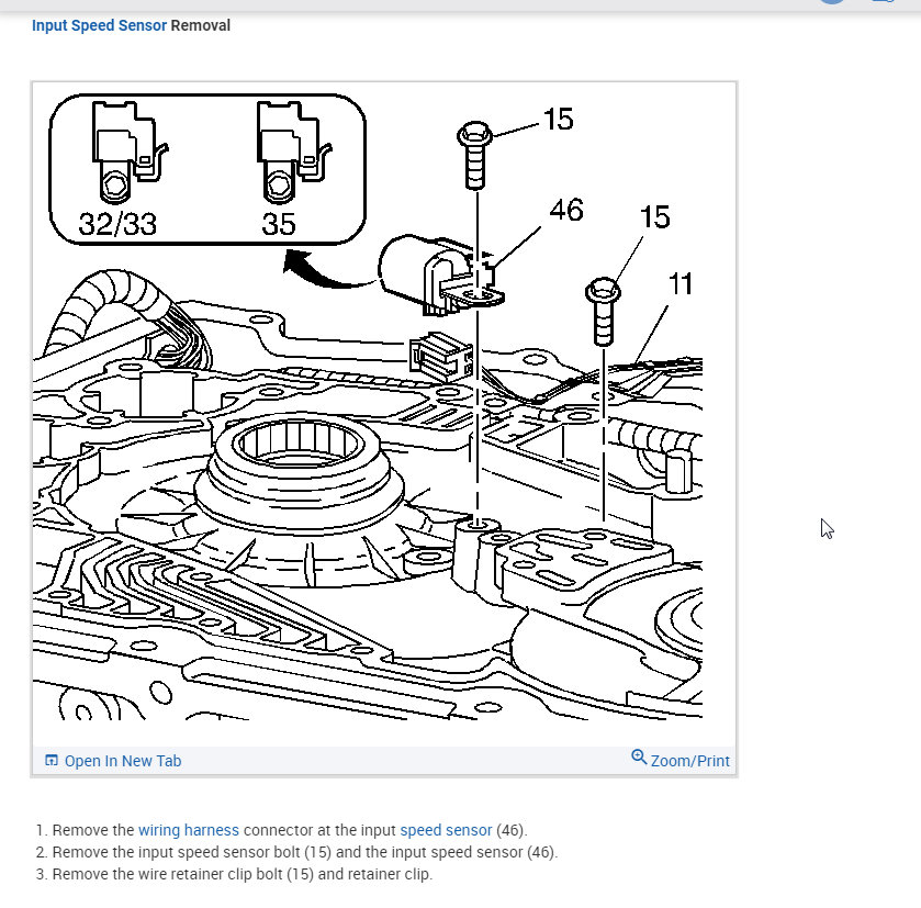

My mechanic says that the input speed sensor on my car needs to be replaced due to error code and rough shifting. Strangely, the tachometer is not working now. Does the transmission have to be dropped or removed to replace this sensor? I have not been able to find real clear pictures on the location if this part.
Thank you for your help.
Sam
Dec 24, 2017 at 8:29 AM
MHPAUTOS
  • 31,937 POSTS

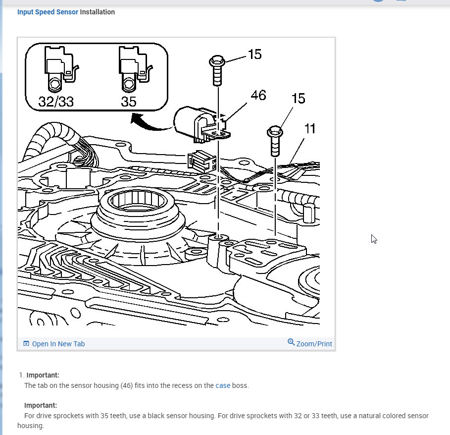

the sensor is No 5.From this picture it doesn't appear to require transmission removal to change it

2005 Chevy Cobalt 4 cyl Front Wheel Drive Automatic
Where is the input speed sensors located on a 2005 chevrolet Cobalt?

on side of the tranny

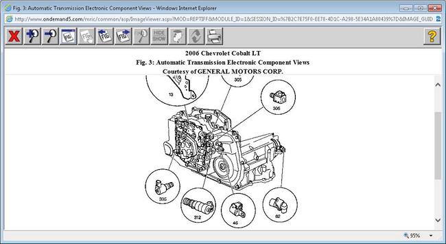

Where is the INPUT speed sensor on a 2006 Chevy Cobalt LT 2.2 engine? Had to replace fuse box. Now speedometer does not work and car will not shift. it is an automatic. Dealership said to replace the input and output speed sensors. Found and replaced the output sensor fine. CANNOT FIND the input speed sensor. Need to know where on the car this is so that I can replace with the new. Have looked behind front left tire, under side cap of driver's side engine. Do not see it anywhere.
Jan 23, 2019 at 9:02 AM (Merged)
SATURNTECH9
  • 30,868 POSTS
Its 46 in the diagram its under the transmission side cover.I wouldn't suspect the input speed sensor for the speedo inop/it tells the computer the speed of the input shaft not the output speed sensor.What codes do you have in the computer?Did you replace the inside or engine compartment fuse box?Also why did you replace it?

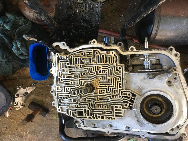

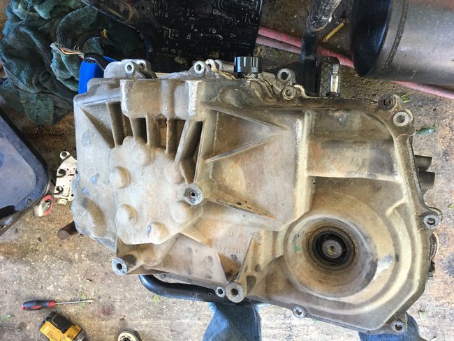

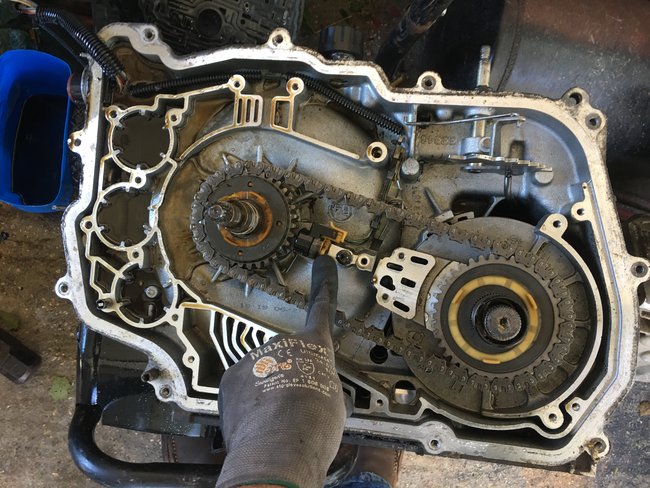

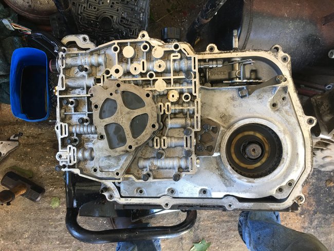

ODIE JARRELL BRYANT
06 CHEVY HHR 2.2 eco. Obd2 code p0717. Input speed sensor. Actual location of sensor. It’s a pain. If your not sure, don’t attempt.

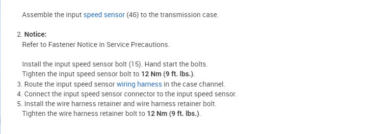

Oct 10, 2020 at 6:02 AM
Thanks for the addition to the site. That is great information and pictures. I am attaching the process out of the manual as well in case somebody needs that. Let us know if there is anything we can assist you with in the future.
