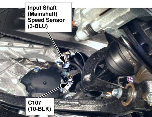

Input speed sensor?
2011 ACURA TSX
153,000 MILES • 4 CYL • 2WD • AUTOMATIC
FEARS
Just bought a 2011 Acura TSX and the engine light came on and it’s saying that I need to get a input speed sensor. What I need is the exact location of where that is passenger or driver side on top on the bottom I have no idea. I just need to know the exact location for I can replace it if you can help please I would really appreciate it.

Yep, it looks like it is down by the driver side CV axle, here is the location, after replacing the sensor please clear the codes to see what happens. Check out the images (below). Let us know how it goes, Ken
