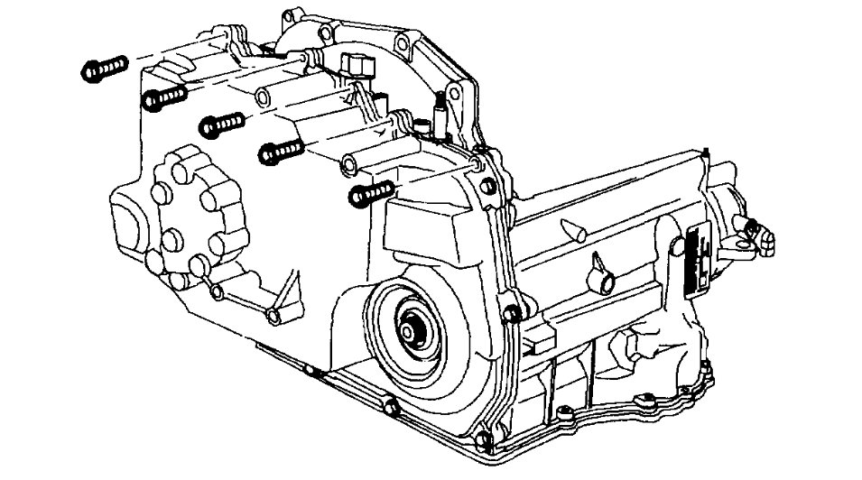

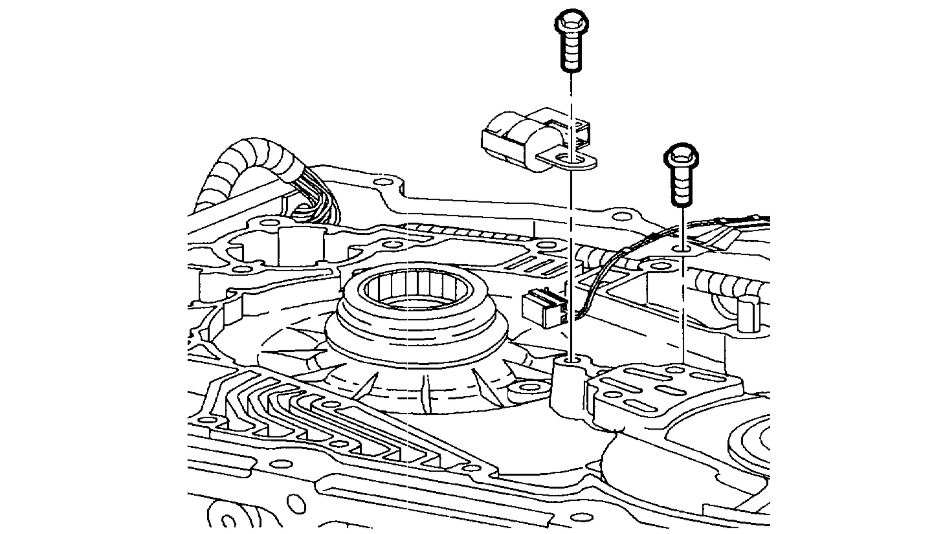

Good morning,
I need the model of your Saturn to get the exact information.
Dec 22, 2018 at 1:30 AM
EJBJR
lw300 3.0 liter v6 2002.
Thanks, Ed
Dec 22, 2018 at 3:20 AM
Ed,
It is under the side cover. it is not the fluid pan but the side cover gasket. after the side cover is removed it is there. I attached a picture for you to review.
