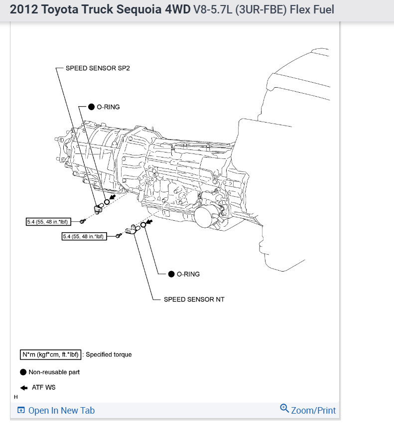

Where is the Input Shaft Speed Sensor located?
2012 TOYOTA SEQUOIA
150,000 MILES • 5.7L • V8 • 4WD • AUTOMATIC
MATTHUFF111
Oct 27, 2022 at 6:42 AM
  • 54,832 POSTS

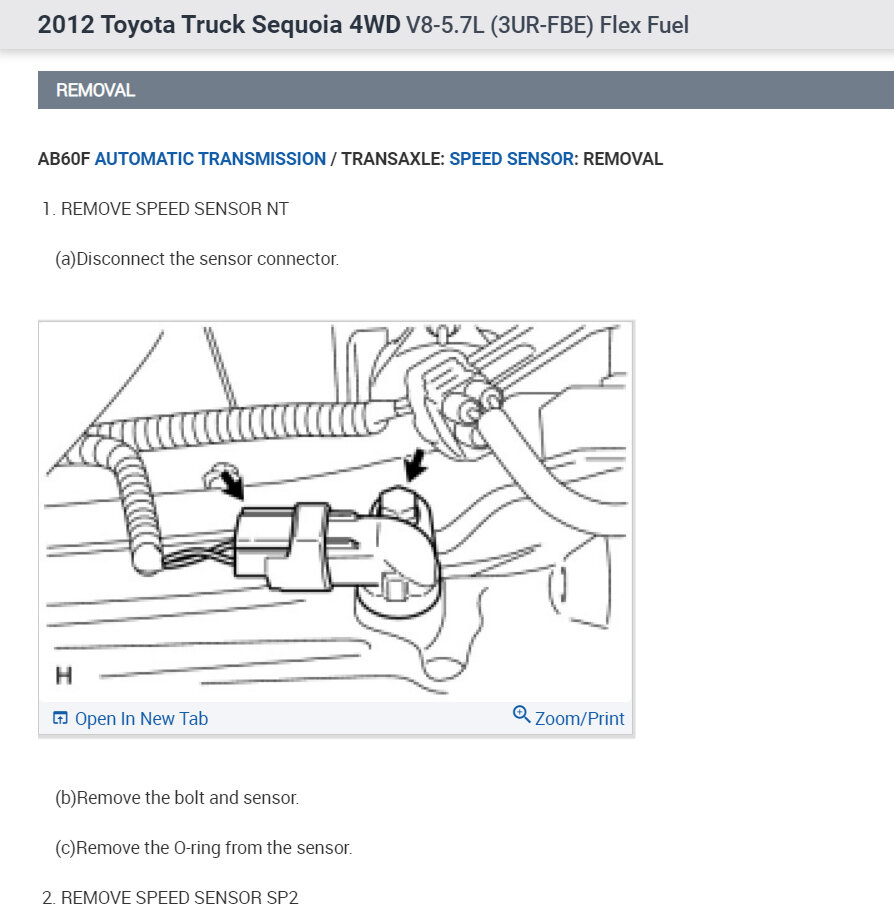

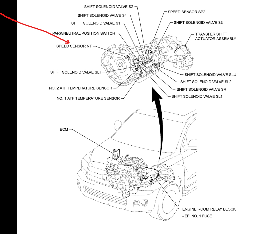

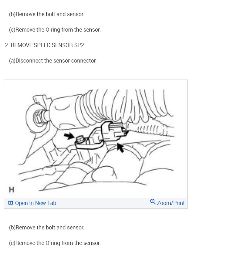

It looks like the input shaft speed sensor they call a speed sensor NT is on the right side of the transmission toward the front near the bell housing. here is the location in the diagrams below. Check out the images (below). Please let us know if you need anything else to get the problem fixed.
