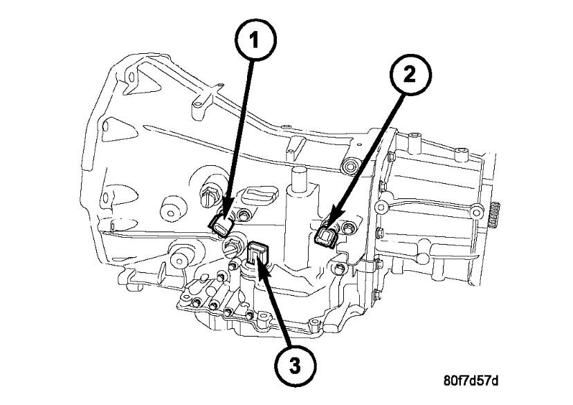

doesn't allow smooth change from third gear to second gear unless the vehicle is slowed down to 4 mph or it scratches as described by a mechanic on YouTube. sometimes it's just a faulty speed sensor and you would have sworn your whole transmission would need a rebuild. So I decided to buy a sensor and try it out, to see if it would elevate the problem. but I cannot find the sensor location as said to be on the left hand side of the transmission. The only thing there on this model is the clutch input module.

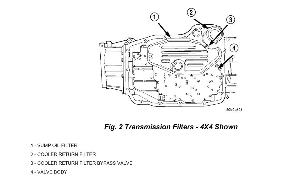

There was a TSB for erratic shifting which I posted. It was all about the filter mounting.
As far as the sensors, no. If there was an issue with the sensor they would code.

A replacement 04799662 cooler return filter may come packaged with a separate threaded adapter stud. The threaded adapter stud is used to attach the cooler return filter to the transmission. Inspect the stud and note end without threads. Install the stud end without the threads into the cooler return filter and tighten the stud-to4ilter connection to 18.6 Nm (165 in.lbs.). Once the threaded adapter stud has been installed to the cooler return filter, install the assembled cooler return filter to the transmission and tighten the filter to 14.1 Nm (125 in.lbs.)
Use the procedures outlined in TechCONNECT(R) (Service Information Tab / 21 - Transmission Transaxle / Automatic - 45RFE 545RFE / Fluid / Standard Procedure / Fluid and Filter Replacement) to replace BOTH the transmission cooler return filter and the transmission sump oil filter.

Hi, thanks for the response, but something seems a bit off track in two directions.!(!) After giving the specs i was sold a sensor even by the dealer. But after reading all the diagrams i hunted, the location still could not be found; then i now assumed along with one guy that everybody is giving me information for an automatic transmission when my truck is a manual transmission. And also based on other cars or trucks. I am not hearing nothing about the 2006 dodge Dakotas which is my truck. Even on you tube everybody is talking about the rams and not the Dakotas.(2) nobody can still tell me if the 2006 manual transmission of the Dakotas carry input/out speed sensors or not and where they located. If they do carry any. Cause all the info diagrams i get seems to be for the automatic ones instead.so i want persons to understand that my problem of rough shifting from 3rd to second or not allowing to shift down from 3rd to 2nd is in a manual trans. Not automatic. .so is there anyone out there who is familiar with the 2006 Dakotas with manual transmission, and has shifting problems; like that that i have experienced. So once again i have a speed sensor in my hand and cannot find where to put it cause it was bought under the specs but it's location cannot be found; suggesting that it belongs to an automatic truck instead of a standard one. And 2 no one can still tell me why the truck won't allow shifting down to 2nd from 3rd unless it is slowed down to 4 mph. please review as the answers i got is for automatic; mine is standard(manual) transmission.
Jan 12, 2020 at 6:25 AM
FREDERICK BLACKETT
VIN;id7hw48ki6s575578 Dodge Dakota 2006 6spd. manual 3.7 slt quad cab
Where are the input/output speed sensors on this engine transmission, or the directions given is related to automatic trucks only. Cause none is found on the side of the transmission where most people say they are.so does this engine have them or not?

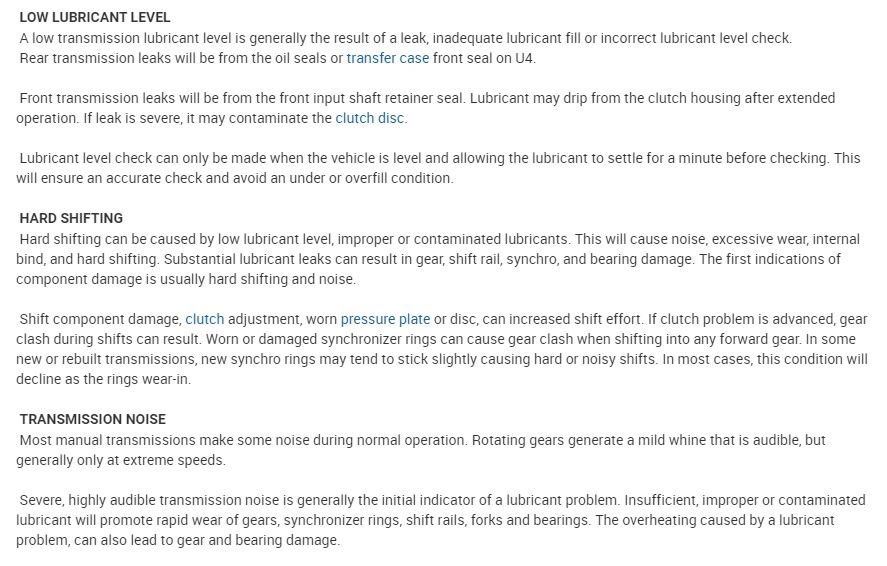

Secondly, shifting problems in this manual trans. From 3rd to 2nd unless the truck is slowed down to 4 mph.or even shifting from 1st to 2nd is a problem when accelerating. It scratches terrible if i force it. Is it that manual transmissions on this model don't carry speed sensors on the transmission and that the information people are giving me is for the automatic ones. Maybe i should phrase the question different; like on a 2006 manual transmission Dakota what makes shifting down to 2nd from 1st or 3rd not possible unless the truck is slowed down to almost zero ??
Jan 12, 2020 at 7:21 AM
Okay, there is no input or output speed sensor on a manual.
The only sensor is the vehicle speed sensor. This is on the transfer case and has no effect on your shifting at all.
If the gears are grinding, then it is either the clutch or worn out synchronizers in the transmission.
