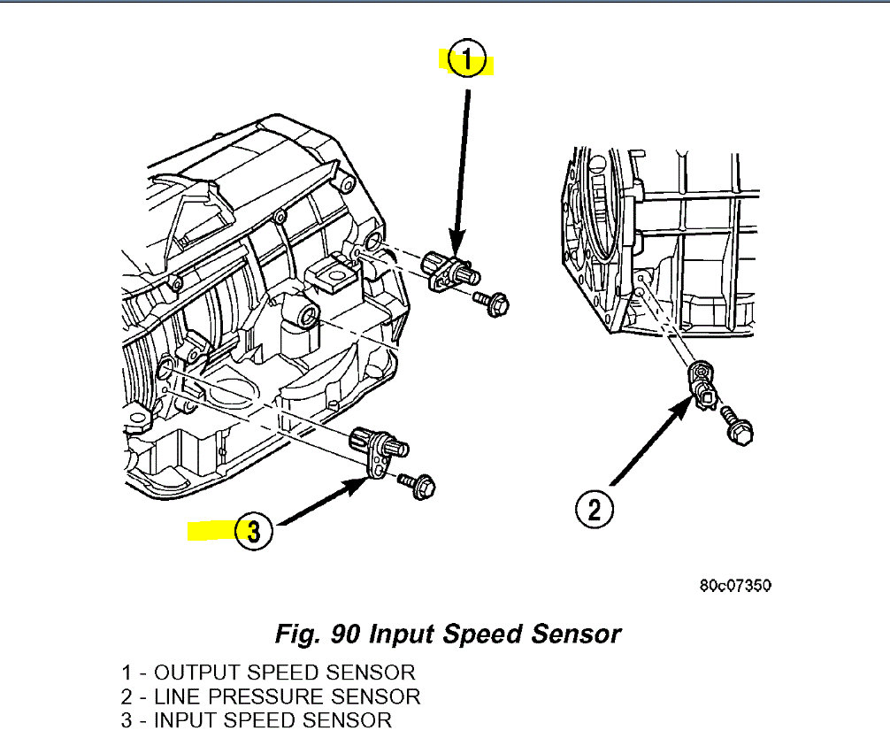

Hey there, looking for the location of the input and output speed sensor for my truck to replace them. Thank you!

These are both located on the driver's side of the transmission housing. I attached a pic below showing their locations.
Take a look at the picture and let me know if you have questions.
