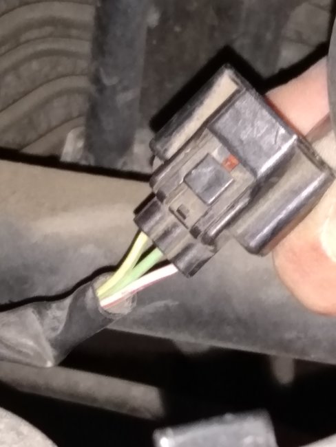

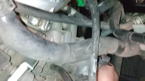

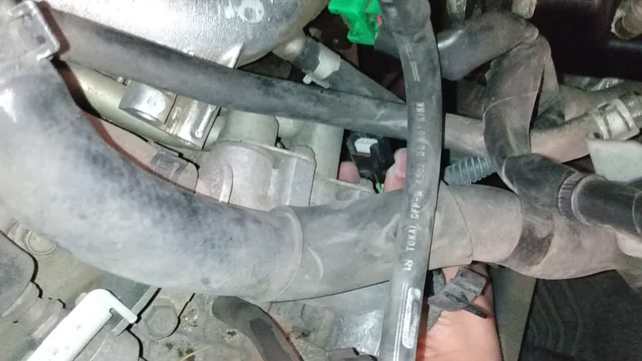

I think I found it but I doubt it's the input because shouldn't it be after the torque converter?
Dec 16, 2019 at 6:48 AM
SOMEONEELSENOW
Here is evidence:
Dec 16, 2019 at 6:53 AM
AL514
  • 5,639 POSTS
There seems to be 2 speed sensors on this model, one is inside the transmission and one outside. It should be a 2 wire sensor not 3.
