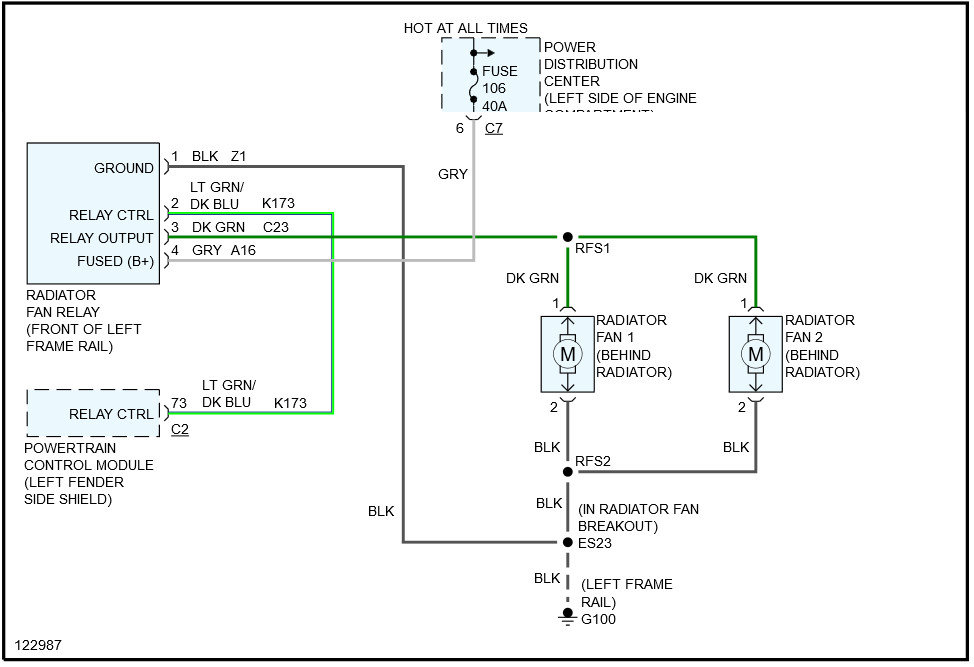

Where can I get a wiring diagram showing inputs and outputs of the PCM? Can anyone point me in the right direction to obtain the wiring diagram?

When both fans are bad, start by checking fuse 106, a 40-amp, in the under-hood fuse box. Next, the more common suspect is a failed electronic relay. It is a small module on the front of the left frame rail, and has four wires going to it.

CARADIODOC: Thank you, thank you, thank you. You really helped me out! A little history on my task: I bypassed the electronic relay and fans worked, so I replaced relay. The following all happened last year: (1)I replaced PCM.
(2) I wanted to do some resistance measurements on the coolant temperature sensor and when I removed the cable to the sensor the fans went on.
(3) also, when I turned ignition key to on and turned on A/C the fans also turned on, but not this time. Fuses and relay in distribution box next to the battery were all okay.
So with the wiring diagram I can trace the problem to its source. Thanks again, Chrysdupe (Frank)

This is a duplicate question and I already gave you the wiring diagram for the fans on the other question.

Last year I replaced radiator fan relay and PCM.
I have driven about 5,000 miles and same old
inoperative fans. I bypassed fan relay and fans turned on. I replaced fan relay again. Unplugging temperature control sensor wires do not
cause fans to turn on allowing engine to heat up does not not cause fans to come on. What other components/signals are required to control PCM operation? Will I need anotherPCM?
I cannot get a wiring diagram anywhere to try to trace the problem. I do not need schematic of PCM circuits, but I need wiring to and from PCM and maybe expected voltages or resistance at PCM pins.

Here is the diagram for the cooling fan circuit.
The proper way to trigger the fans would be using a scan tool.
