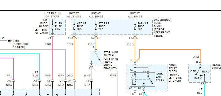

2000 Chevy Blazer no brake lights turn signals or emergency flashers.
Headlights and taillights work

Hello, I can help, the first thing we need to do is check the fuses. This guide can help and I have included the fuses to check in the images below.
Check out the images (below). Let us know what you find.
