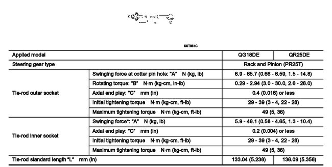

Do you know the inner tie rod torque for my car? Also, no lock washer for inner tie rod, Loctight or not? Thanks
Aug 13, 2018 at 6:11 PM
  • 110,194 POSTS

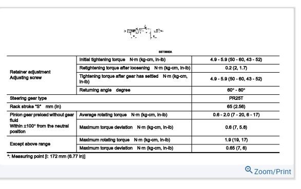

I have attached two pictures of the torque specifications for the front/steering components. The inner tie-rod is included.
Let me know if this helps.
