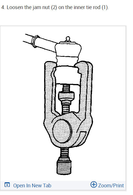

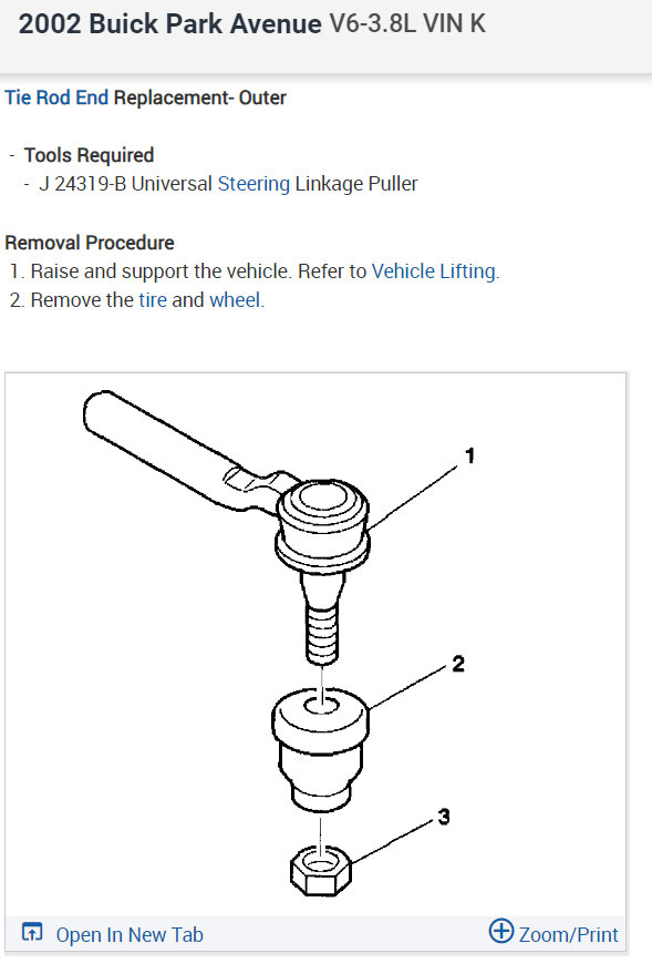

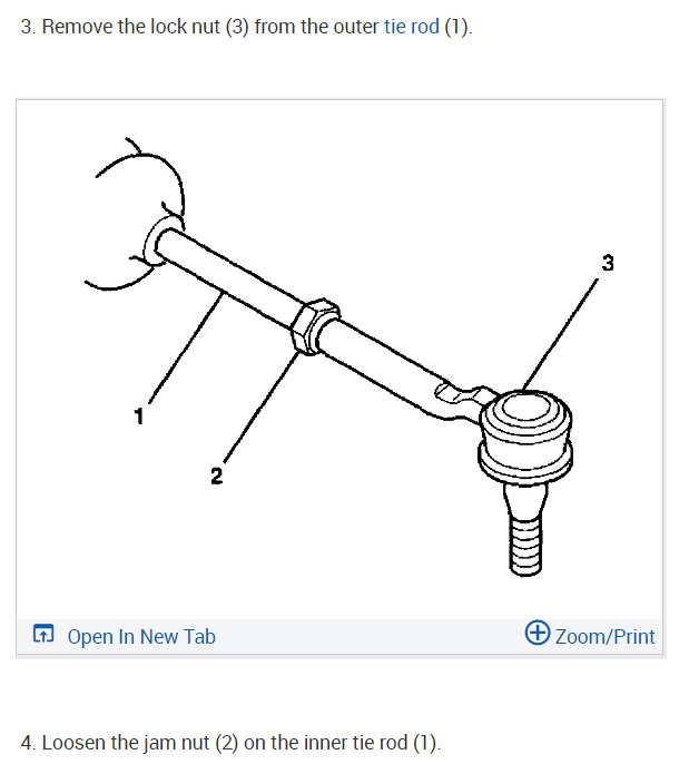

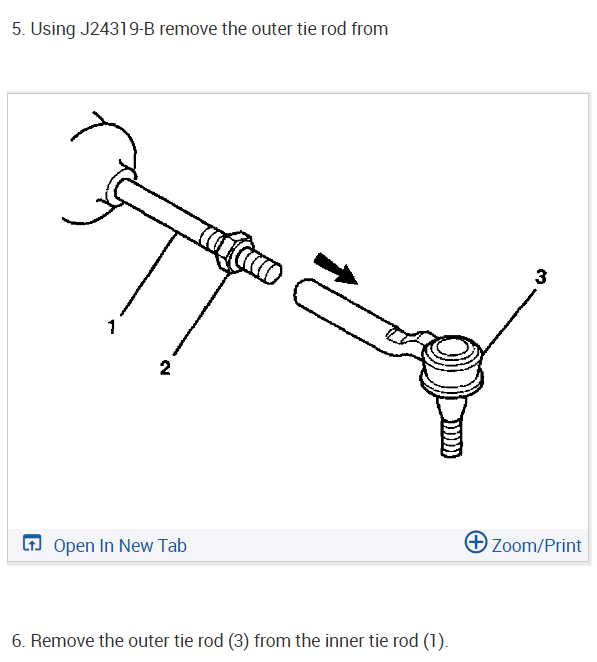

Can you upload an image of what the problem is? Tie rods usually do not go out that fast. Does it have a Zirk fitting? Here is how the outer tie rod end is replaced correctly. Check out the images (below). Please let us know what happens.

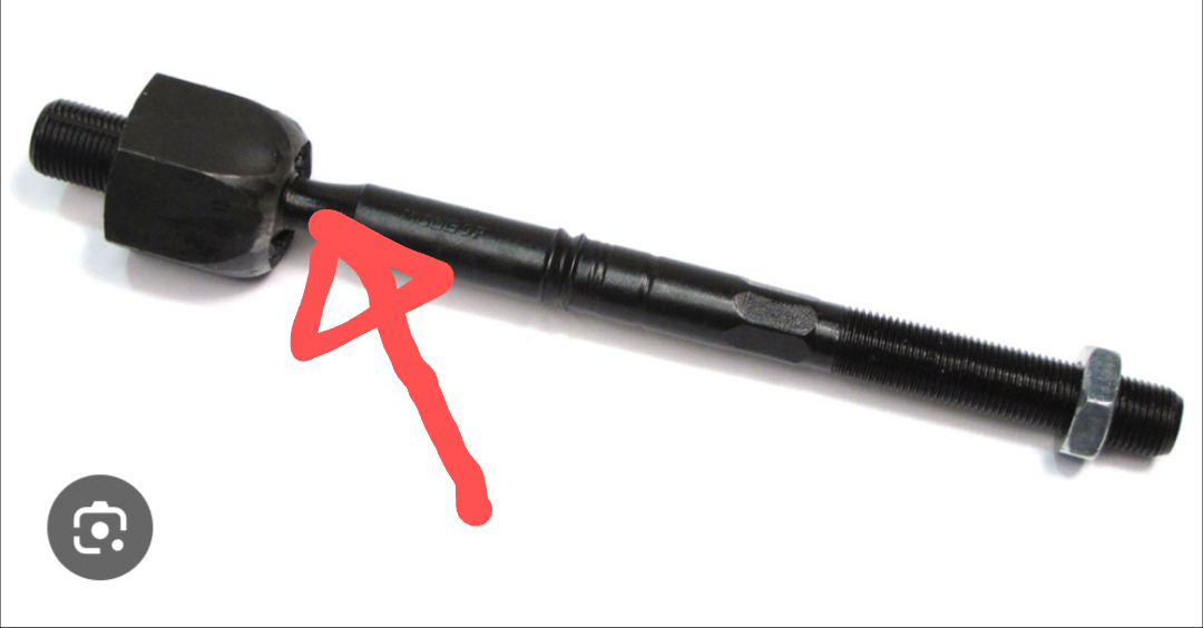

It is the inner tie rod that keeps giving out. This is the part that keeps giving out. It has in and out play. At first i thought it was just the part but i have tried 3 different ones and they all get that play in there which gives the tire the wobble.

How is the tire wear? it could be the alignment is way out and added stress to this part.
