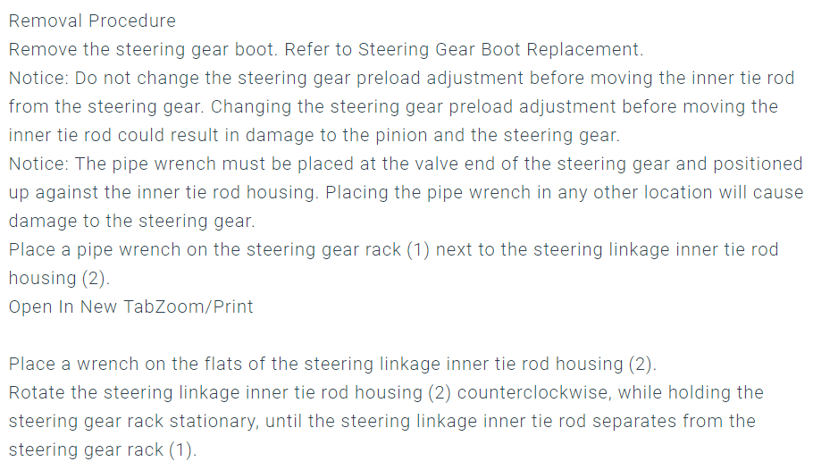

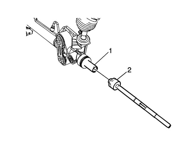

Does my GMC 6.6 Duramax 4wd have inner tie rod ends. and am sorry GMC 6.6 Duramax not a Chevrolet.
Nov 24, 2020 at 7:04 AM
Experienced Mechanic
52,796 POSTS
Good evening,
Yes, it does. I attached a picture and the procedure for you of the repair.
https://www.2carpros.com/articles/tie-rod-end-replacement
It is the same for both sides.

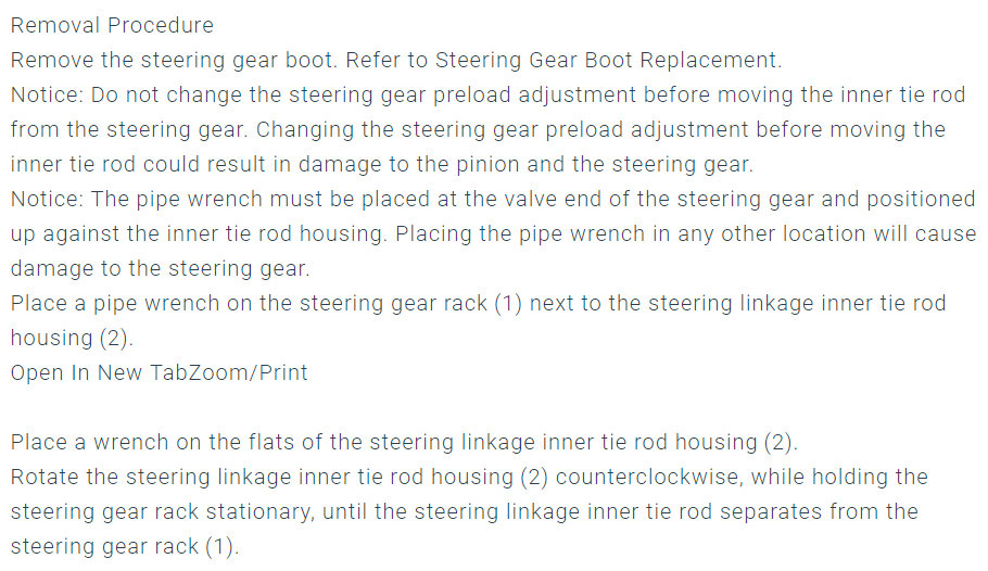

Thank you Roy. so it's just the Ford F150s models like the 250s and 350s 4x4 that don't have an inner tie rods, but Chevy's and GM's do, correct?
Nov 24, 2020 at 7:36 AM
52,796 POSTS
No, Fords and Dodge has them as well. They are part of the steering rack itself.
