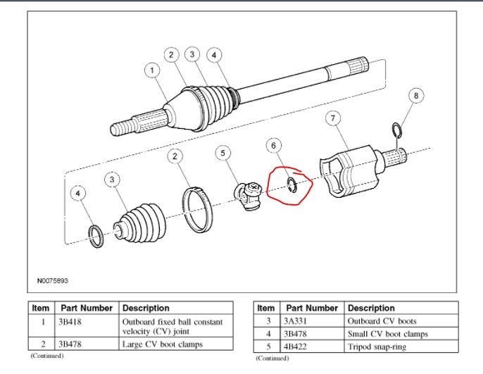

my inner CV joint is always coming out. changed shocks wheel bearing and control. arm

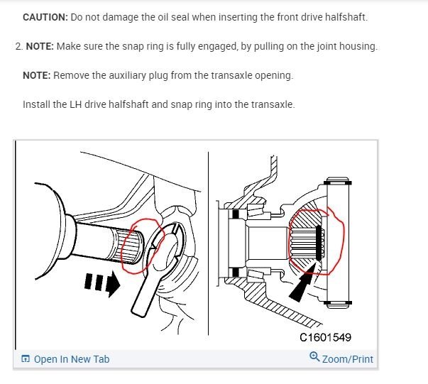

There is a snap ring on the end of the axle that keeps the axle from popping out.
https://www.2carpros.com/articles/replace-cv-axle
If it is missing or too compressed, it will not lock into the transaxle to prevent the axle from falling out.

thanks, but it is not going out from the gearbox, the housing stays behind only the shaft and the tripod (balls where you connect the shaft that from the outer CV joint.

There is also a snap ring in that joint as well. Open the joint again and make sure the ring is not damaged.

The inner part of the joint.
I attached a picture and circled the ring for you.
Oct 26, 2021 at 4:10 AM

that is attached .

from the image the whole thing pops out but 7 stay attached to the gearbox 6 stay attached to the shaft only break tripod rings (5).

Then there is too much movement.
Is this a replacement axle shaft of the original shaft?

my inner CV joint the tripod always comes out from the housing. i put a new control arm shocks and wheel bearing.

The inner Tri-pod joint is designed to slide inside its casing up to a point. Any further outwards movement will cause it to pop out.
Which side is affected?
Why did you replace the lower control arm? Accident damage?
When replacing the lower control arm did you check that it is the same length as the old unit?
Was the wheel alignment checked afterwards?
Did you check that the outer cv joint installation depth matches the other side?
An outer CV joint which sits too deep in the wheel hub will effectively lengthen the travel of the side shaft which can cause the inner CV joint to pop out.
Also check that the side shaft is not bent
Please let us know how you get along.
Cheers, Boris

I hit a pothole my old control arm bend replaced it same length. have not check the outer one will do that ASAP because it's like the shaft is short but it's the original and it didn't bend.
