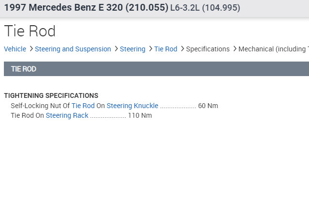

Those specifications are correct.
The tie rod on the steering rack is 110 Nm (81 ft. lbs.)
Self-locking nut of the tie rod on the knuckle 60 Nm (44 ft. lbs.)

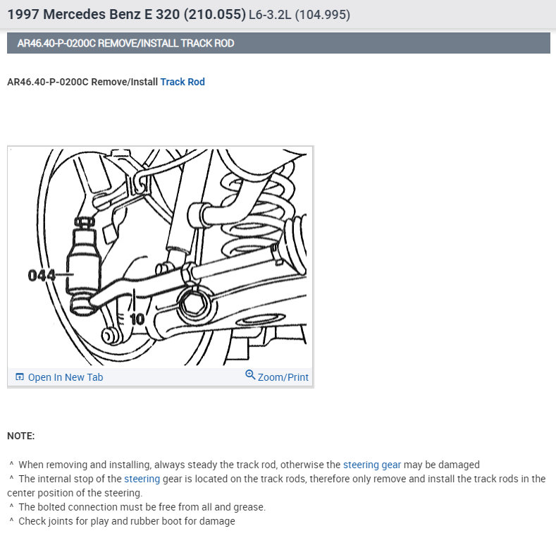

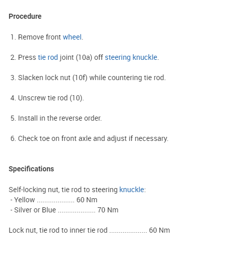

I have attached the instructions below.

Got it I see what happened. I included that guide just as a reference. As that is our standard tie rod end replacement procedure (different model).
The actual torque specifications are on the screen shot from all data that has your make and model.
Hope this clears it up for you.
