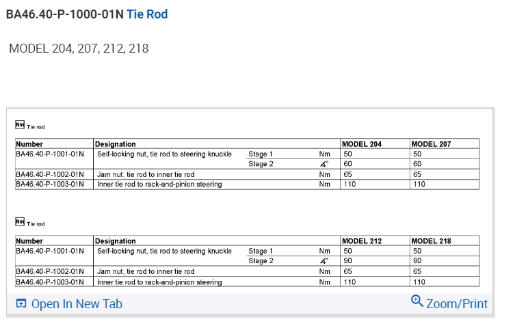

Inner and Out Tie Rod replacement torques specs needed?

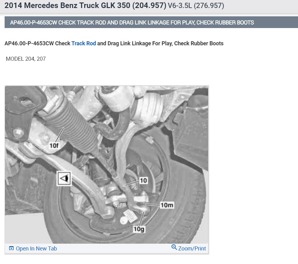

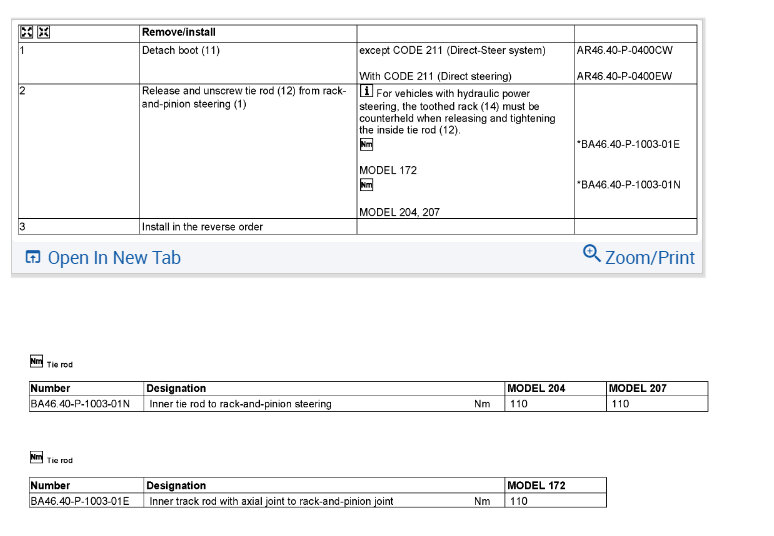

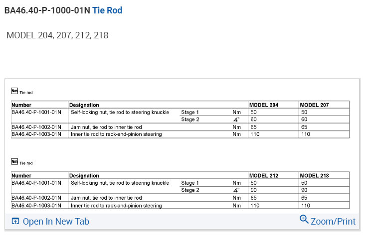

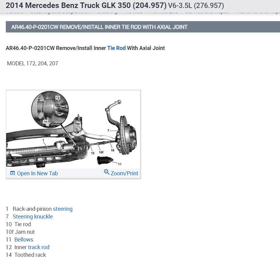

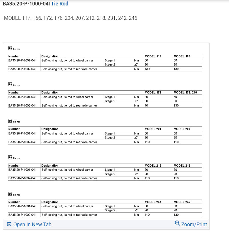

Not necessarily a problem. Just seeing if you guys could provide torque for the procedure. Specifically, inner to steering rack, inner to outer nut, and outer to wheel nut. Thanks a lot!
Aug 3, 2023 at 7:09 AM
  • 55,721 POSTS

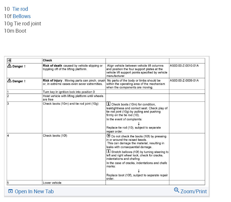

Sure, here are the instructions on how to replace the inner and out tie rod ends and torque specs to help you do the repair. Check out the images (below). Please let us know if you need anything else to get the problem fixed.
