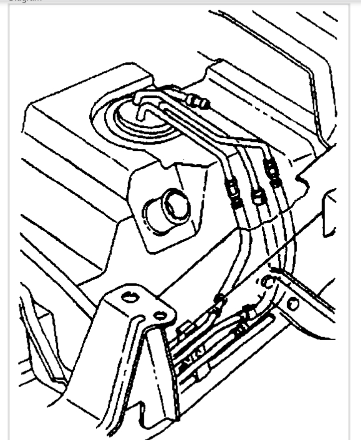

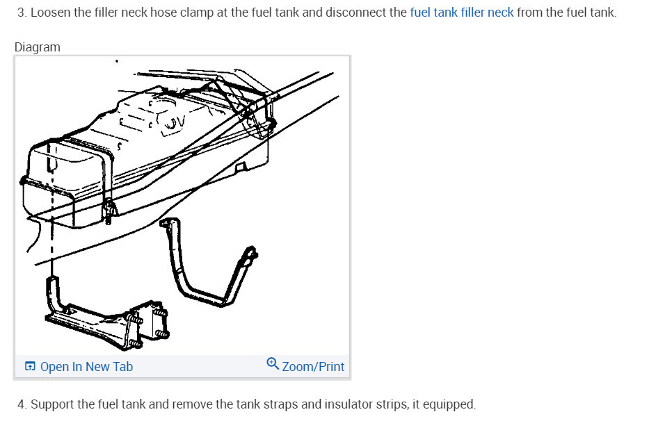

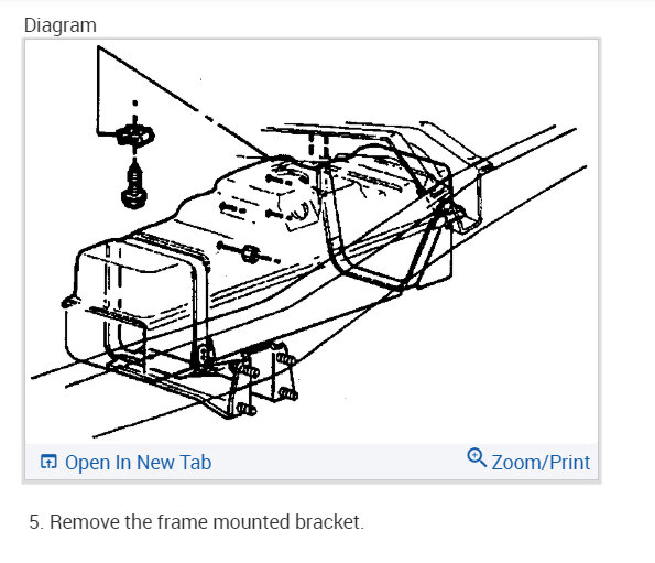

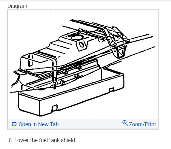

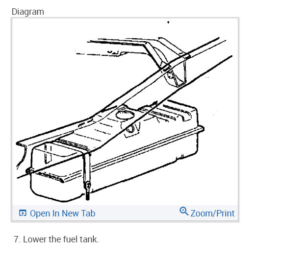

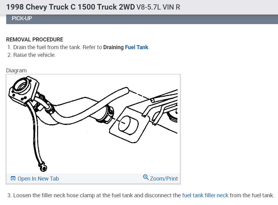

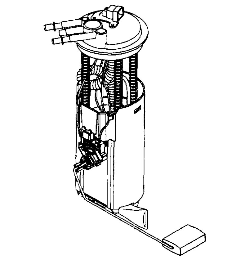

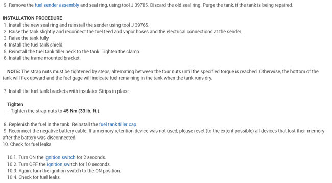

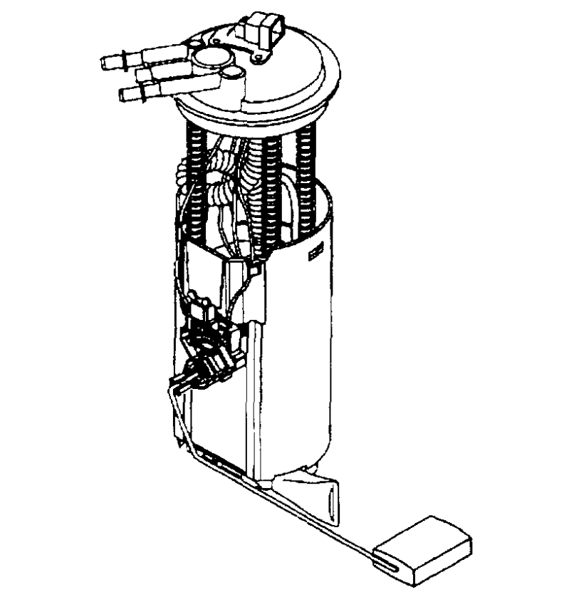

Will the engine run if you use starting fluid? If so, can you hear the fuel pump in the tank run when you turn the key on but not start? It sounds like you have a bad fuel pump which will cause the fuel pump relay to burn up. Here is how to replace the fuel pump, use AC Delco parts. Check out the images (below). Please let us know what happens.
