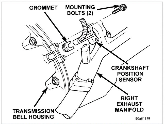

My truck was driving just fine then out of the blue it just lost almost all power. When I tried to give it gas it seemed to just choke it out more. Then after I parked it let it sit and started it back up. It has a rough idle and if I try to give it more gas it chokes out and backfires a little bit. so, I don't know if my fuel pump is bad or my injectors are bad or if it could possibly be a vacuum hose popped off somewhere.

By chance, have you scanned the computer to see if there are diagnostic trouble codes stored? I ask because this could be several things. It could be fuel-related (too much or too little), it could be a crankshaft position sensor failing, even a partially plugged catalytic converter can be the issue. I question if it's a vacuum leak, but anything is possible.

If there was a lean or rich fuel mixture, it should have set a code. The same if it was a plugged converter. Does your scan tool have live data? If it does, I need you to check two things.
First, with the engine cold, check the engine coolant temperature sensor reading. Start the engine, allow it to warm up in an open-loop condition, and see what the short-term fuel trims are.

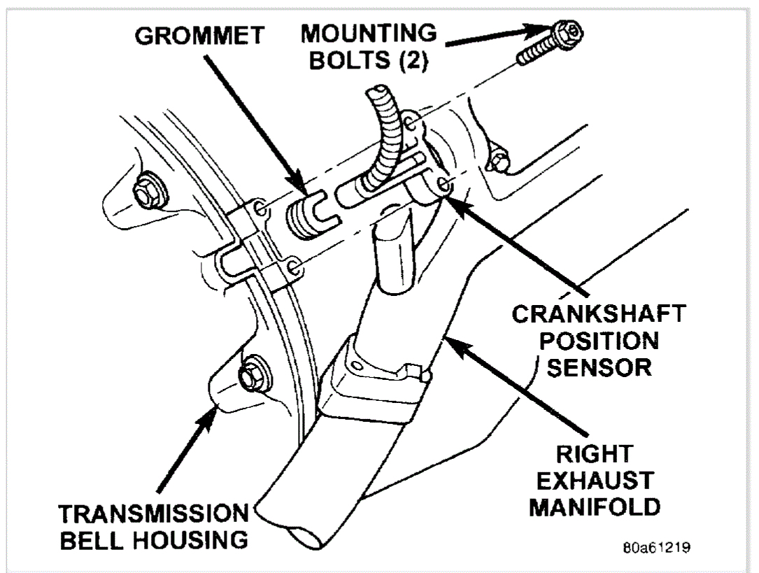

If you don't have a scanner, inspect the wiring at the crankshaft position sensor. The Crankshaft Position (CKP) sensor is located near the outer edge of the flywheel (starter ring gear). See pic 1 for location. It's right near the exhaust manifold and the wiring takes a lot of heat.
Let me know what you find.
See pic below.
