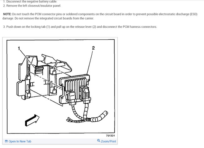

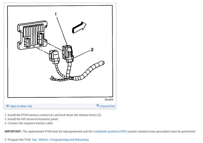

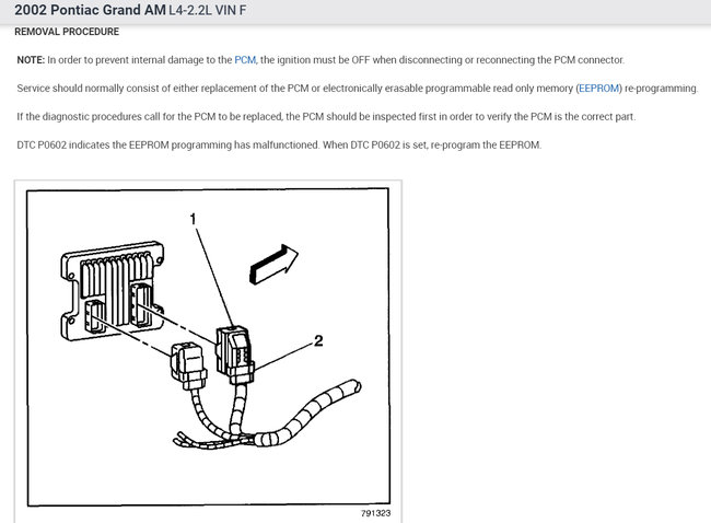

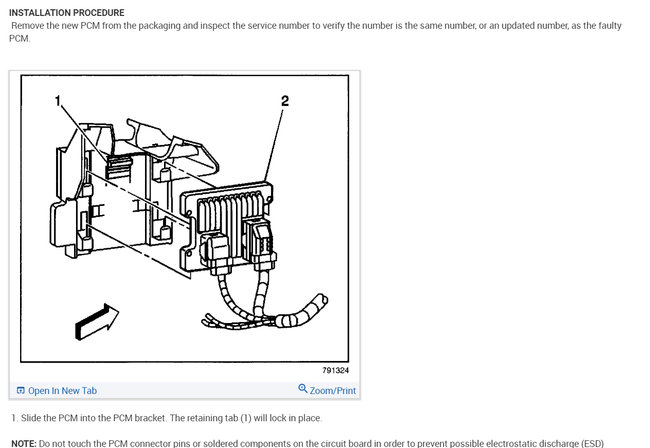

It sounds like the PCM has gone bad which there will be no codes for these are the instructions for replacing it in the diagrams below. Please give your VIN number to the rebuilder so they can send one pre-programmed.
The replacement powertrain control module (PCM) must be reprogrammed and the crankshaft position system variation learn procedure must be performed:
^ Latest Techline information on PCM re-programming
^ CKP System Variation Learn Procedure
^ Inspection/Maintenance (I/M) Complete System Set Procedure
^ Programming Theft Deterrent System Components in Theft Deterrent Systems
