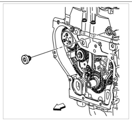

No start, Ecotec. I have 60 psi, new fuel regulator, have spark, checked chain it is good, upon inspection seems there are no injectors working because no fuel in cylinders plugs are dry. engine cranks but does not start but if you leave it overnight it tries to hit first cranking, but after that it just cranking no start. also replaced crank sensor. Help! what now?
Thanks, Mark

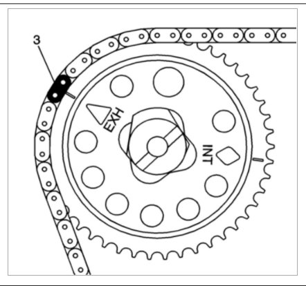

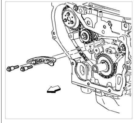

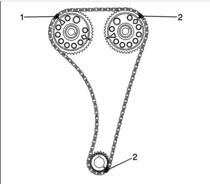

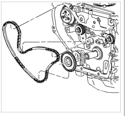

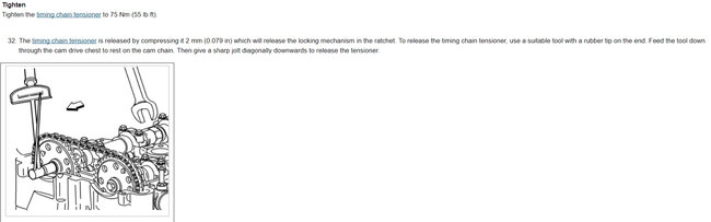

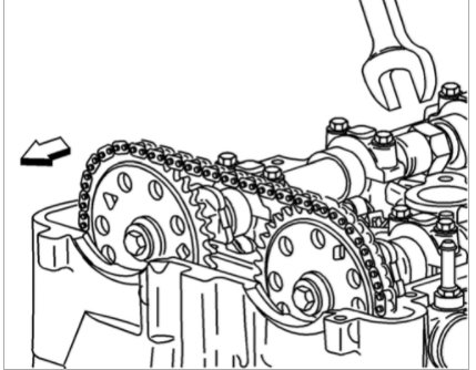

We got it running after full throttle and choked it, determined that it has jumped time.
Dec 9, 2017 at 11:41 PM
  • 55,389 POSTS

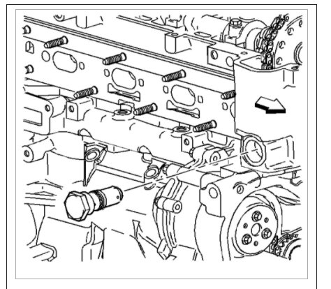

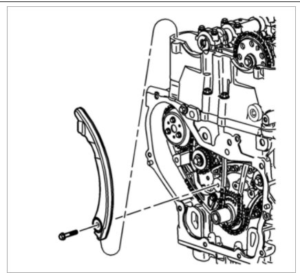

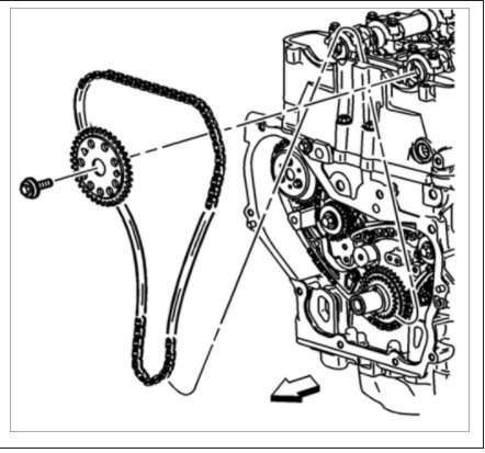

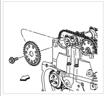

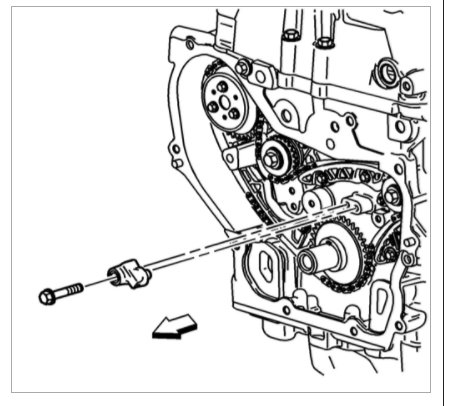

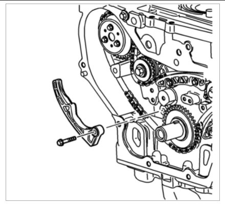

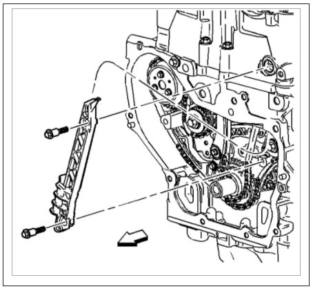

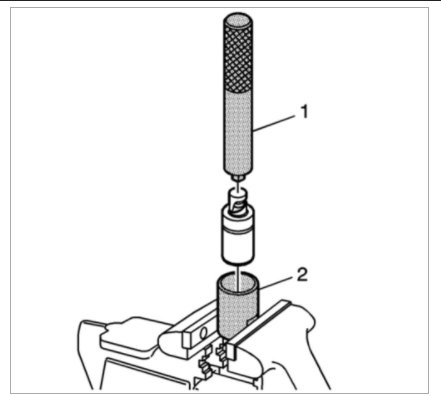

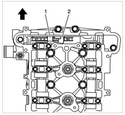

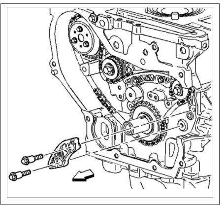

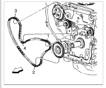

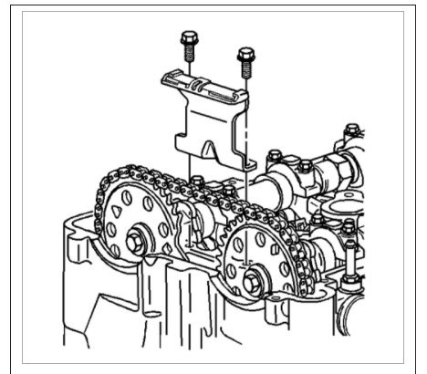

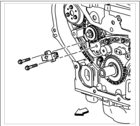

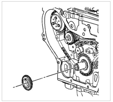

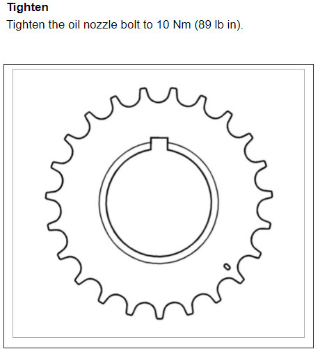

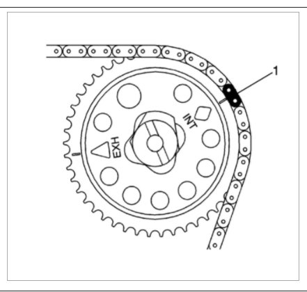

Yep that happens. Here are some diagrams on how to replace the chain. It might have bent valve so I would take the camshafts out and do a leakdown test before you install the new chain.
Here are the guides to do the timing chain (below)
Please let us know what you find. We are interested to see what it is
