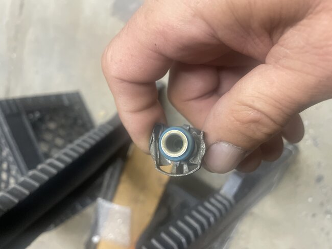

A mechanic put it on a scanner, and it got an injector code. I changed the injectors and put new ones in, but they are not getting any power to at least half of them. It idles, but when I disconnect the injectors, nothing happens on the right side. I disconnected two of them on the left side, and it almost shut off.

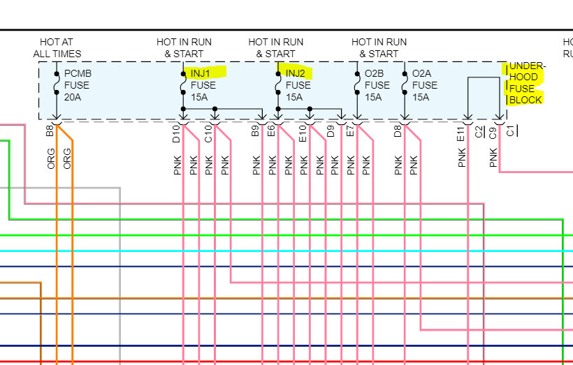

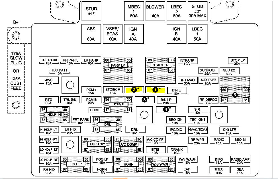

If you have no power to the injectors on one side of the engine, have you checked the fuses? Each side or engine bank has a separate fuse for the fuel injectors.
Take a look below. Note there are injector 1 and injector 2 fuses. I need you to check both fuses and confirm there is power to and from the fuses.
Also, pic 2 shows the under-hood fuse box. I highlighted the fuses to check.
Let me know what you find.

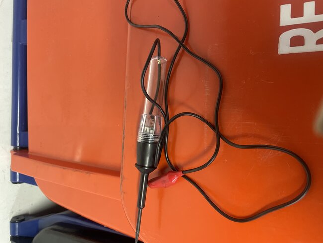

Fuse number two was blown, I put a new fuse on it and restarted the truck, it still has no power to the injectors. I haven’t put a test light on it yet. But the fuse did not blow.
Jun 12, 2023 at 10:12 PM
  • 110,244 POSTS
Okay, if the fuse was bad, something is happening. When you check any of the injectors on the engine, do any of the pink wires have power to the bank in question? Also, check to make sure there is power to and from the fuse you replaced.

I put another fuse in, turned the power on, and it blew the fuse. When I pulled the fuse and checked the connections, the left side has no power. I’ve searched for the grounds that I could find and clean them and reinstall them. The only ground that I haven’t got to is the one on the driver side door rail under the dash. But I am really stressed out because it’s my only vehicle, and I work from paycheck to paycheck and it’s costing me a fortune. And I don’t know how to check the lines on the injectors. At least not with the test glad that I have which is included.
Jun 14, 2023 at 8:05 AM
  • 110,244 POSTS
If the fuse failed as you mentioned, disconnect each of the injectors and see if the fuse still fails. If it does, then we have a short between the fuse and injectors. If it doesn't fail, then connect one injector at a time to see which one causes it to fail.
Once that is determined, check the connector as well as the wiring to that injector. If it is good, we need to replace the injector.
Let me know. Also, the test light you have is perfect. It will do the job if we need to go that route.

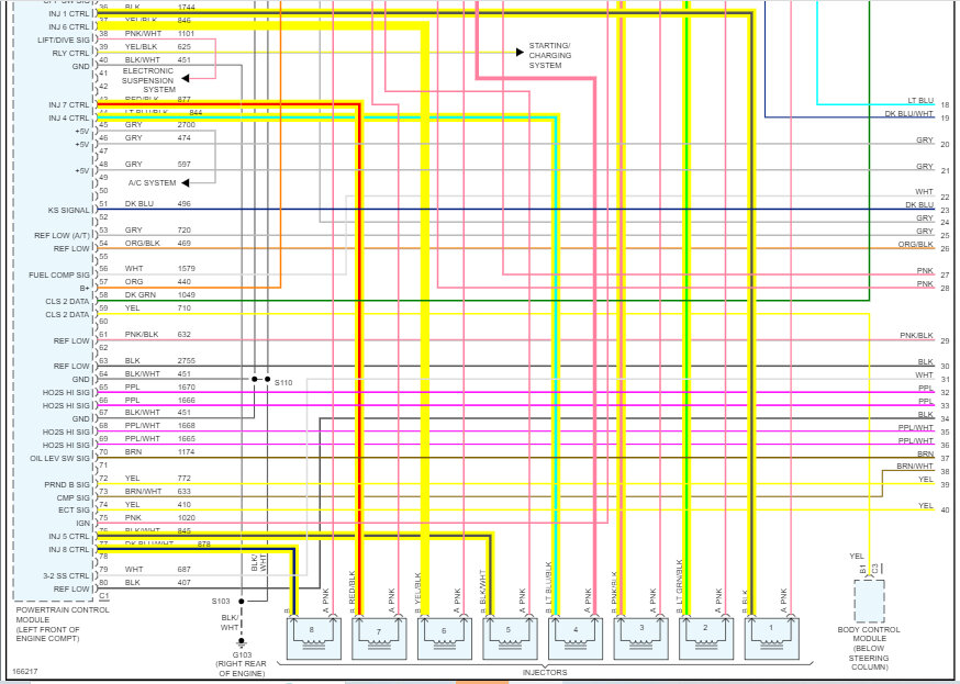

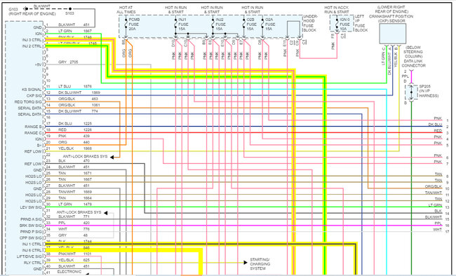

Can you please send me a wiring diagram for the PCM to the right-side injectors? I think it’s #1 injector bank, #2 fuse. Then can you tell me how to test it with a multimeter? Thank you so much for your help with this.
Jul 2, 2023 at 3:17 AM
  • 110,244 POSTS
I would be happy to. If you look below, I attached the schematic and highlighted all the signal ground wires from the injectors to the PCM.
Note that each injector has a pink wire. That is the power supply. It should have 12v with the key in the run position or start position.
Here is a link that you may find helpful when testing wiring:
If you are testing for a signal ground, it is easier with a test lamp. Connect the test lamp alligator clip to the battery-positive terminal. Probe the ground wire with the test lamp. Have a helper crank the engine. If the ground is working, the test lamp will strobe on and off.
Let me know if that helps.

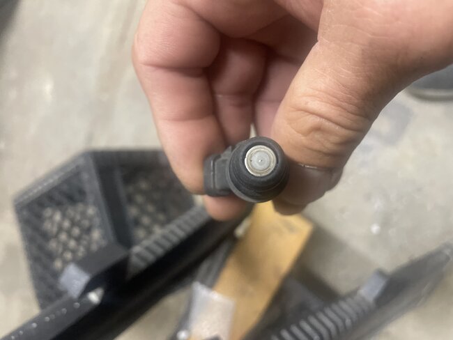

Oil after changing out the oil, pressure sensor, the engine light went off for about four days, and then it came back on, and told me that both of my field banks are running rich. And so, I changed out the air filter because it was very black and very old. Hoping that this will solve that problem. But my question is, would it be the new injectors that I installed? Because they are four hall injectors, rather than the original two whole injectors, which I still have. They seem to be very clean.
Aug 6, 2023 at 12:46 AM
  • 110,244 POSTS
If the fuel pressure is within specification, then I would suggest reinstalling the original ones to see if the problem goes away. There is a good chance that is the cause.
Aug 6, 2023 at 2:16 PM
K CALDERONI
  • 16 POSTS
I put the original injectors in, and so far the light has not come on. But it took a couple of days for it to do that before, so I’m going to wait for another day and see what happens. Meanwhile, I’m going to clean out the mass airflow sensor Because I bought some mass airflow sensor cleaner. I figured it would be a good idea and it might help a little more.
