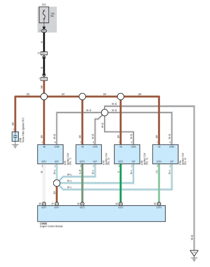

How do i know if the Injectors is bad? misfire on #3 and #4 Cylinder. rough idling i replace coils and spark plugs.

I done replaced the coils, spark plugs, fuel injectors and camshaft position sensor and still have a misfire on #3 and #4 cylinder can you tell me is causing of the misfire?

Well with those numbers it shouldn't be compression as the cause. Because the coils share so many circuits it shouldn't be the powers and grounds, however I would double check that you have battery power at the Brown wire to each coil, and a ground on the White with black wire. From there I would connect a test light to battery power and see if the light comes on when held to the Green wire on the coils. The various greens are the trigger wires for the coils. If the light flickers on with the engine running the ECU driver circuit should be working. The next step would be testing the injectors, for that a set of noid lights would be handy, many parts stores have them as loaner tools. They just clip in place of the injector and flash if the injector circuit is operating.

I have battery power at the brown wire to each coil.i did a retest with the test light and the light come on the test light flickers on with the engine running, the noid light flash when engine running. i remove the valve cover and check for slack between the camshaft sprocket there was about 3/8-inches of slack.
