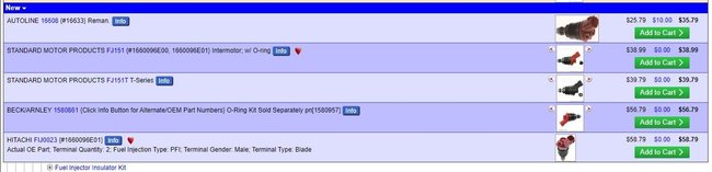

Good evening.
when you changed the injectors, did you use new or rebuilt injectors?
The reason I ask is there are numbers on the injectors. There are different types and if you put the incorrect ones in, you will have issues.
I attached the parts list from rock auto and they show the numbers that need to be matched from your old injectors.
