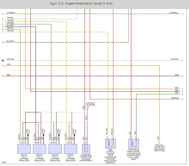

Can you assist me how to start my car? It is sending spark but not opening injectors.

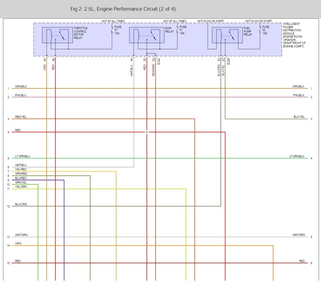

It sounds like you have a ECM relay that has gone bad, here is a wiring diagram that tells you where it is and I will include a guide that will help you test the relay.
Please run some tests and get back to us so we can continue helping you.
