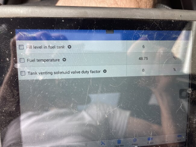

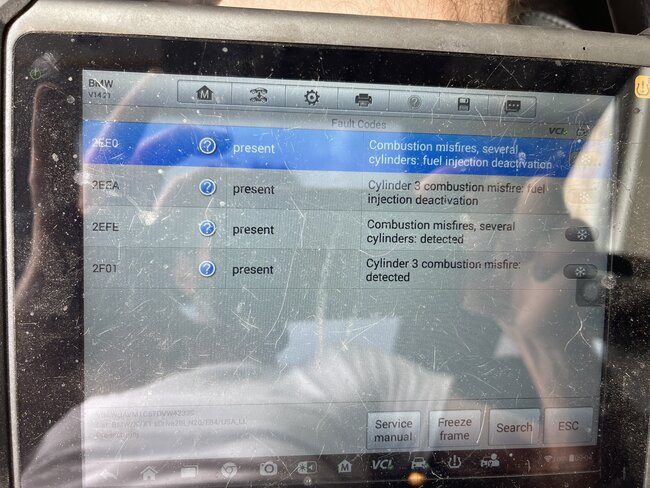

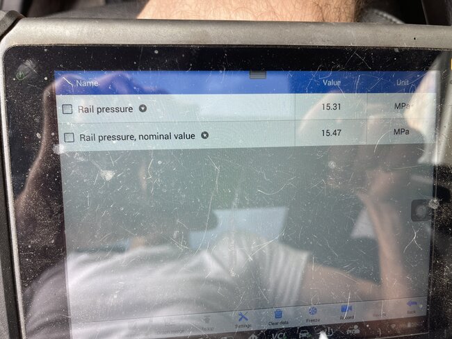

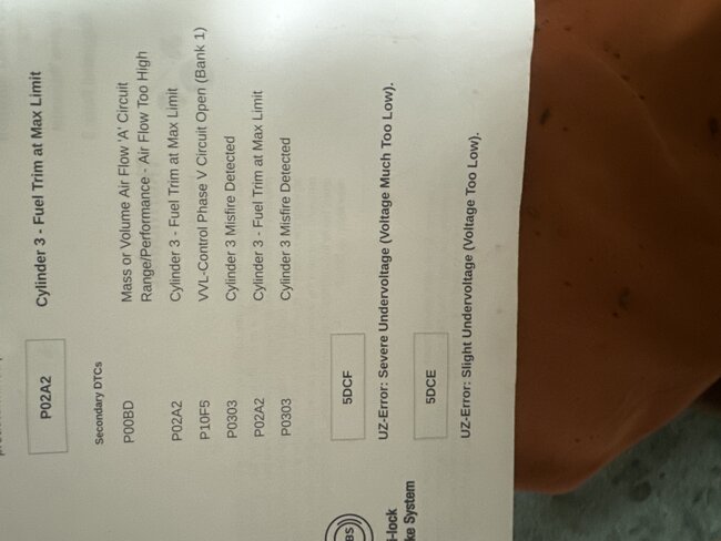

A friend has this issue that I am trying to help him with. He said a month ago started misfiring he changed coils and plugs, kept misfiring on 3 a d 4, be changed injectors he said it keeps blowing injector number 3 under load like on the highway and when idling it's like its choking from too much fuel. He said he saw something about a code which says cylinder 3 at max trim level which i have never seen before. So, it blows the seal off and leaks. He sent me this video which is attached. I worked on several BMWs never seen that with an injector.

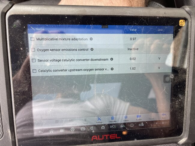

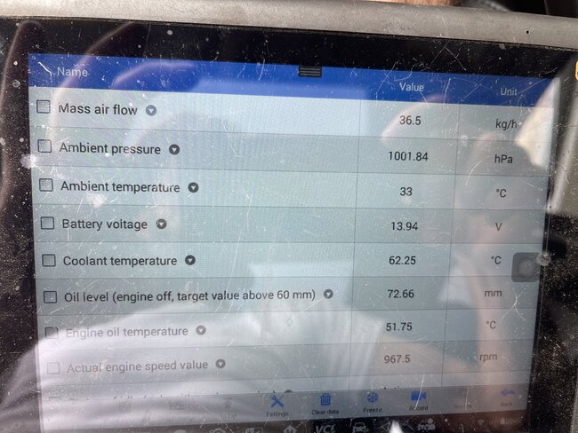

Isn't it possible the MAF sensor is causing this? What live data numbers on the scanner do you want to see to get a better idea? BMWs catalytic hardly fail. Also to test it. Shouldn't i remove an o2 sensor and measure the back pressure?

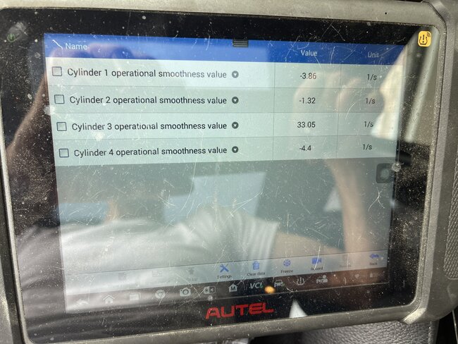

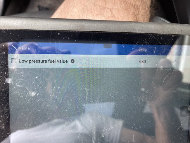

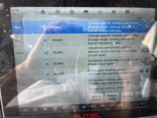

Do you see any flags as far as the numbers here? I switched coils and the misfire remained on cyl 3. If i clear all the codes, the engine becomes smooth like it should for few then back to misfire. Picture with so many codes was deleted and all the codes that remained have to do with cyl 3.

Yep, these numbers sound like low compression, have we checked the compression on #3? If the intake valve is burnt this can cause the problem you are having.
This guide can help:
Let me know what the reading is.
