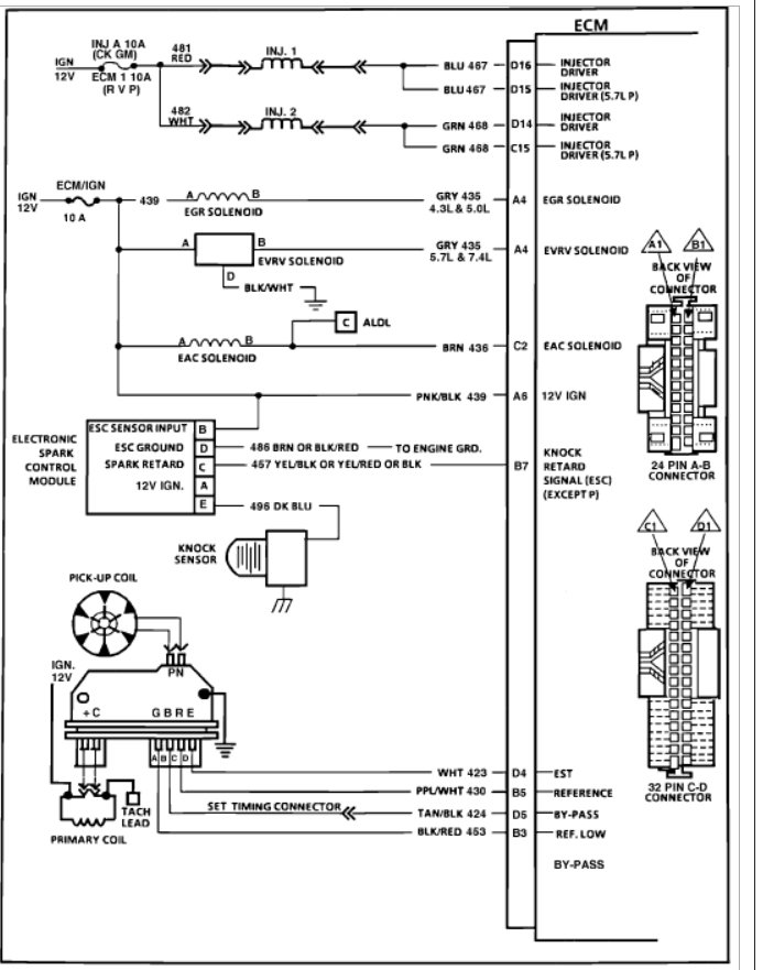

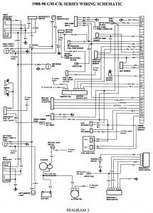

V8 two wheel drive automatic 165,000 miles. I have been having trouble with a friend's vehicle he needs for work. It had a bad fuel pump, so dropped the tank and replaced it thinking it would fix the no fuel problem. Getting proper fuel pressure at the TBi assembly. Motor fires over with starter fluid. Heard on this site http://www.chevroletforum.com/m_13174/mpage_2/tm.htm#63237 about changing the ignition module/pickup coil in the distributor to get the ECM to ground the fuel injector circuit. changed out for a JY distributor assembly. Still no go. Checked for voltage at injectors, twelve volts, and at the ECM's power out for them (A6 pin) twelve volts, and D14 and D16 I get twelve volts, so wiring is fine. After this in the circuit the computer grounds out the circuit, making it closed briefly and the fuel injectors fire. Are there any other sensors/modules, when bad, will keep the ECM from grounding out the fuel injector circuit(s)? I have not checked them with a noid light but pretty certain there is not a circuit complete due to a bad sensor Attached wiring diagram schematic: Also, check the thread on page 2, I posted more information about the ignition module voltage at ignition on position, there was basically no voltage coming back to the ECM, but power in from the ignition coil to the module. Possible bad JY distributor? Any help appreciated, thanks!
https://images.2carpros.com/forum/automotive_pictures/173092_0900823d80087955_1.jpg
Feb 12, 2021 at 3:38 AM (Merged)
BMRFIXIT
  • 19,053 POSTS
It sounds like it could be one of a couple things. the first things I would check would be the oil level because if the oil pressure is down it will cut off the ignition saving the engine. Next there are a couple of fuses that are in the system as well and finally the ECM is bad causing the problem. Here are some wiring diagrams and a guide to help you see how the system works and a guide to help you run some simple tests. Make sure the computer is getting power and ground.
and
Check out the diagrams (below) The ECM you can plug and play. By the way get a used one.
Please run this test and get back to us.

All fuses are fine (inj a + b, etc) and the ECU when tested gives twelve codes repeatedly when I jump the aldl connector.

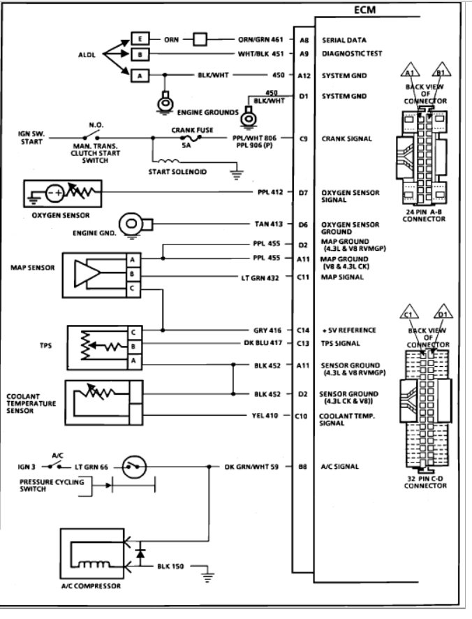

BRADSURFING
  • 5 POSTS
flood mode voltage would be five volts meaning maxed on that circuit meaning the TPS is not doing the proper resistance potentiometer it should be? or do I have it backwards (maybe cause I work on Fords). Here is a better diagram the other one i attached through the site did not show up right:
so C13 blue wire should be power to tps, five volts , and the black wire should be the changed voltage so at closed throttle it would be about one volt back once it goes through the coolant temperature sensor that alters a bit too?
How does this go, thanks for any help here and for the help you have shown, it sound's like a possible bad TPS.
I have tried to put it in limp mode before by disconnecting the TPS plug on the other side of the TBi opposite of the linkage and still no fire from injectors, but I think I had disconnected the MAP sensor at the same time but I do not think it should have had bearing on the injectors spraying.
Maybe I need to check the ignition module once more.

checked TPS voltage at the ECU pins and at idle it is a round five volts and it goes up to 4.5 or 4.8. i cannot remember when i pushed on the throttle pedal so i know TPS is good.
swapped the ECU's and did not do it, possibly wrong ECU.
Going to get the old ECU re-flashed either tonight or tomorrow night (no charge, good to know old employees. :)
i did test the old ignition module and it had a bad reference signal (the last test on the diagnostic machine).
tested the newer one and it passed all tests.
also, checked the ohms for the pickup coil and it is where it should be (800-1300 ohms not magnified).
spin the shaft on the distributor manually, set to volt AC and it is where it should be (.2 to .7 volt ac).
so the new distributor setup is good and not causing the ECU to cutout the grounding part of the fuel injector circuit.

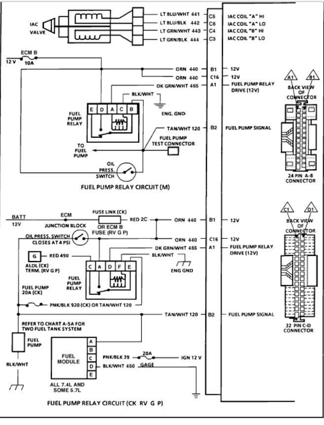

is there a wire that comes off the fuel pump to the ECU that tells the ECU the fuel pump is on and/or primed? i have not checked but i did have to repair the ground wire for the fuel pump (it works fine just fixed the connector on top the tank, soldered it up then taped).
BMRFIXIT
  • 19,053 POSTS

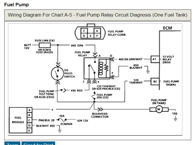

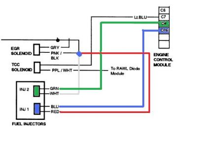

all i add is check the wiring. check for battery power at the injectors with key on and also check the wiring back to the ECM. let me know.
https://images.2carpros.com/forum/automotive_pictures/99387_injector_1.jpg
BRADSURFING
  • 5 POSTS
I did this a while ago, probably did not catch it due to all the information i gave.
it is fine it gets power (oh that diagram where it has D4 for injector should be D14, because d4 is really for ignition module) it is a typo on Chilton's behalf (where Autozone gets the diagram).
When I replaced the ECM the truck started! Thanks for all of your help this site rocks!
