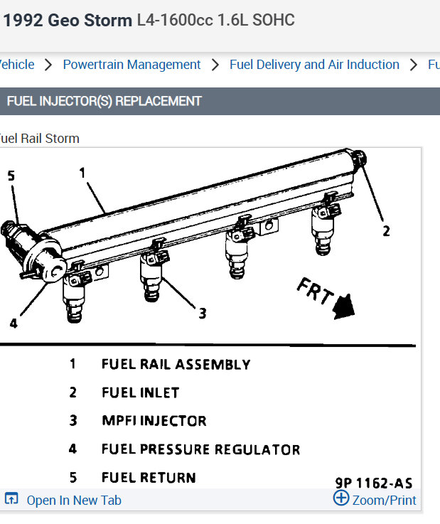

Can someone give me a manual or have instructions on how to clean the injectors of the vehicle listed above?

Cleaning fuel injectors is easy! Here is a kit that will help you for $79.00:
https://amzn.to/4h1hcQE

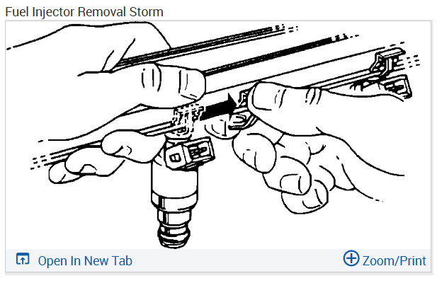

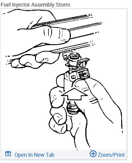

Here is how to remove the injectors for the service. Check out the images (below). Let us know if you need anything else.
