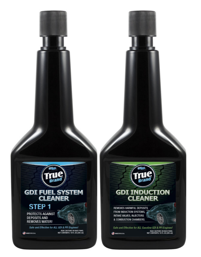

Sounds great. I have had pretty good success with this brand. Clearly I don't recommend them for any other reason then I have experience using it so I would just look for something specific to GDI engines and something that guards against deposits as this is the main concern with GDI engines.
Let me know if you have other questions. Thanks for using 2CarPros.
