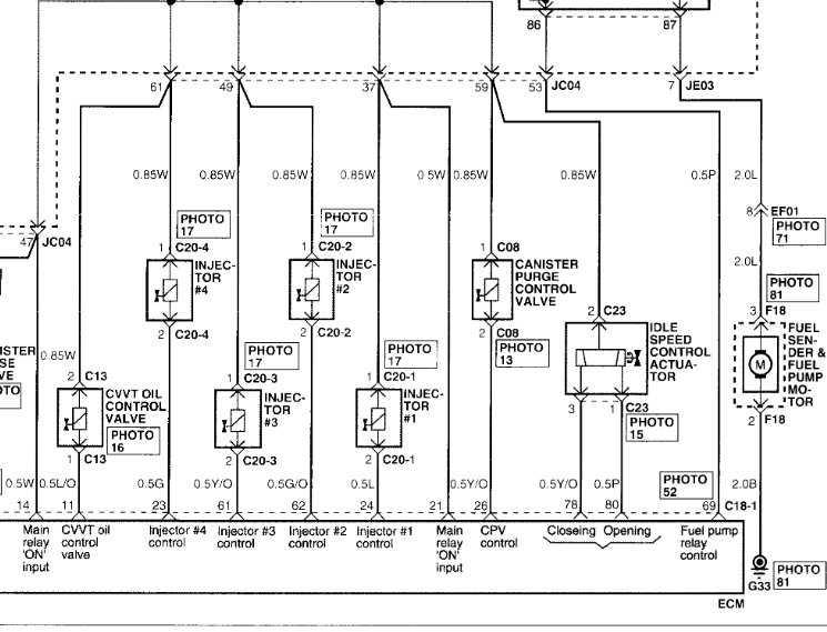

My injector number two not working. I have changed it but still same issue.
Dec 27, 2018 at 10:01 PM
Good afternoon.
Did you verify power to the injector. with the key on, remove the connector and test for voltage at the connector.
https://www.2carpros.com/articles/how-to-test-a-fuel-injector
the other wire goes to the pcm. that controls turning the injector on and off by grounding that wire. A tool called a noid light can confirm if it is doing its job. you can get one at the parts store.

I had done that and even swapped the number one injector to number two, but still the same. I had changed the cylinder head valves at that side but still same issue.

I am mechanic and am working on the vehicle listed above right now, the injector two is not working. I have swapped the number one injector to number two, but still the same. I had even changed the cylinder he's valves but still the same issue. the timing too is well fixed. the coil and the coil wires too working good. so what do you think is the cause of this problem?
Nov 26, 2020 at 12:16 AM (Merged)
  • 110,241 POSTS
If the problem remains at injector two regardless of switching the injector, you need to start by checking if there is an injector pulse to the number two injector.
Here is a link that shows how to check. If you have a noid light, use it to see if there is power to the injector.
If there is no power, then you need to trace the wiring back to the PCM to determine if there is a corrosion issue, the pin is pushed in on the connector, the wiring to it is bad, or if the PCM has failed.
Let me know what you find.
JOe
PAT.2
  • 25 POSTS
There is power coming on the injector. please
  • 110,241 POSTS
All I show is a 2.0L as the smallest for this vehicle. If you have power to the injector and it and a different one doesn't work, then it has to be a bad ground. Have you checked for grounding issues?
