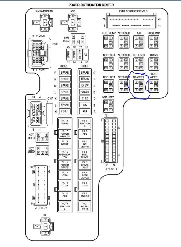

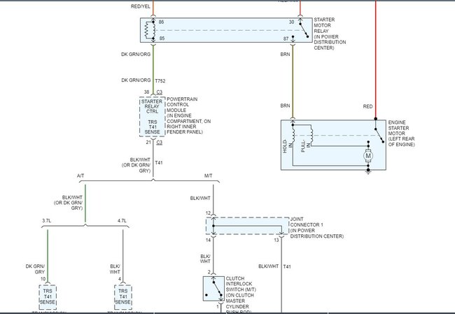

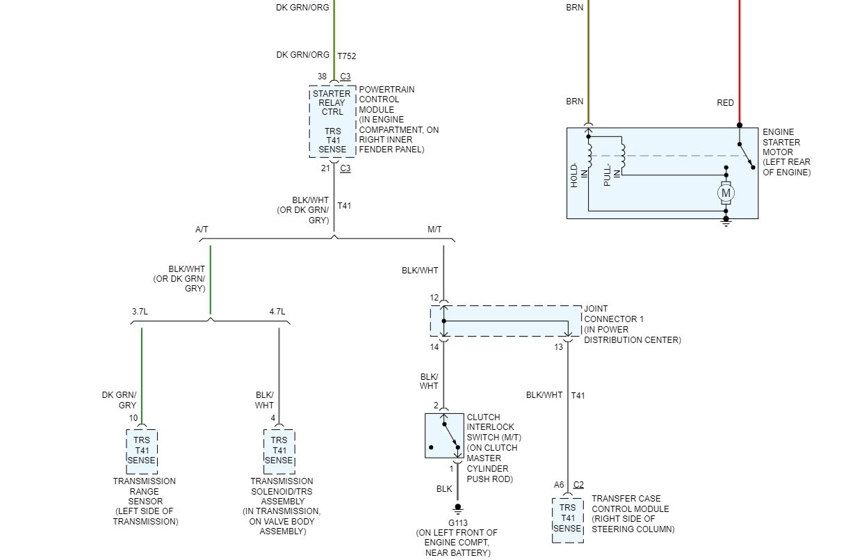

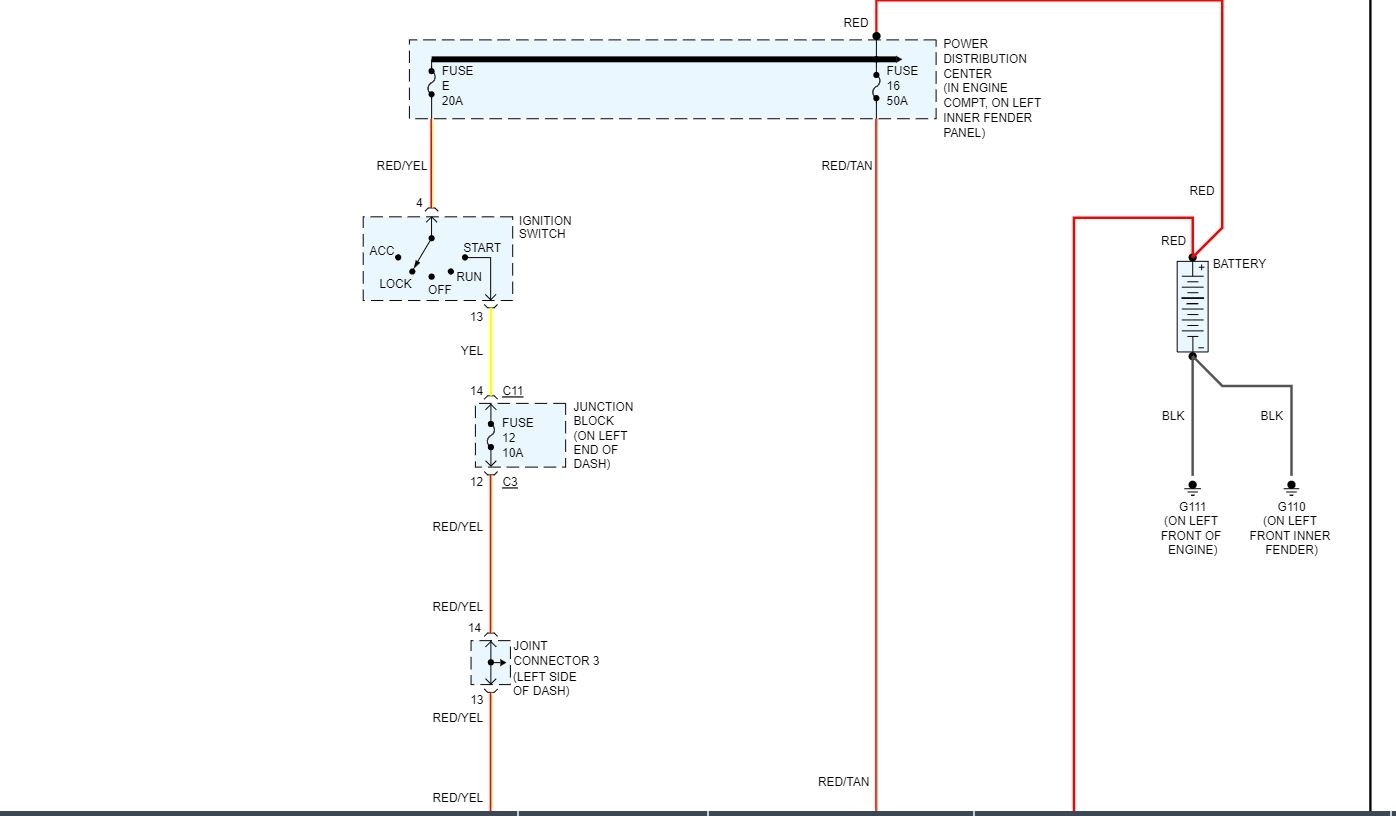

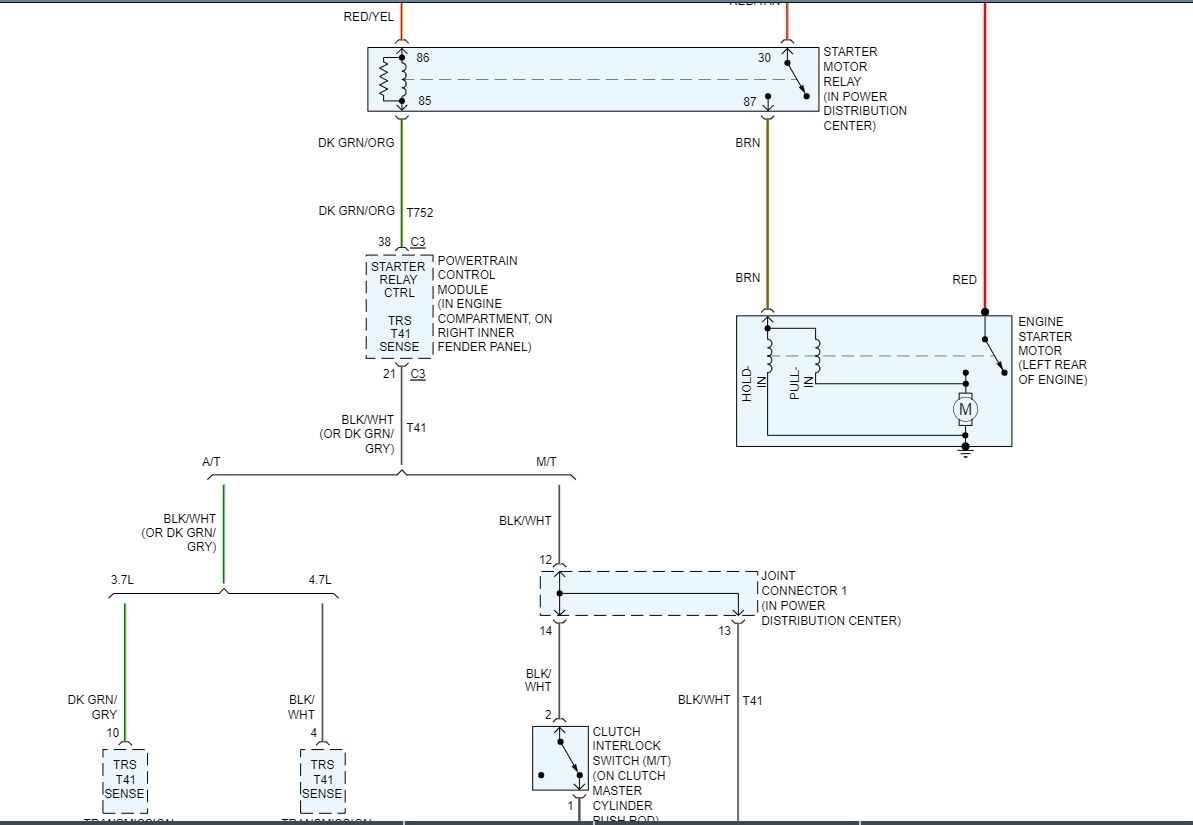

Good morning,
I attached a wiring diagram for you for the starting circuit. Make sure you check all the fuses for power on both sides for power.
https://www.2carpros.com/articles/how-a-starter-and-solenoid-works
This could be the relay, a bad connection, or the starter motor itself.

Decided after him explaining that all codes, po645,499,443 and charging, and A/C clutch all refer back to the one of the four modules on PCM.
It fixed all issues, 60 +miles, no problems.
Thank you for the diagrams, which I shall keep for my own reference.
