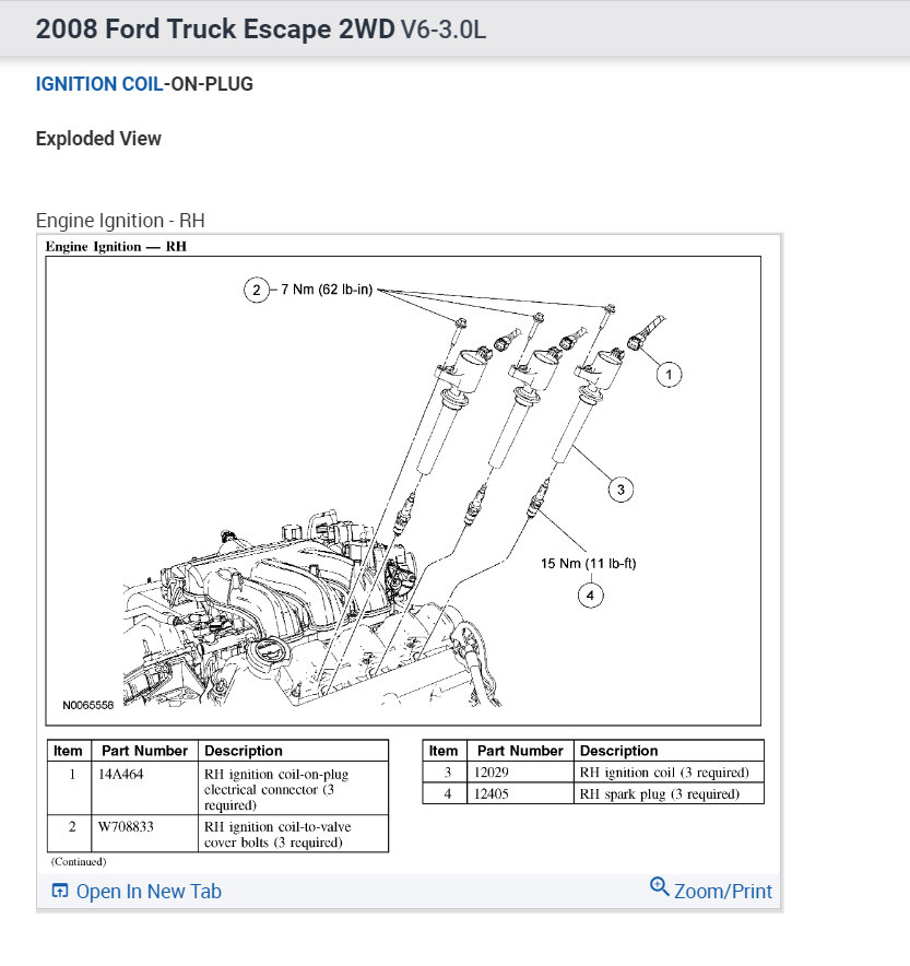

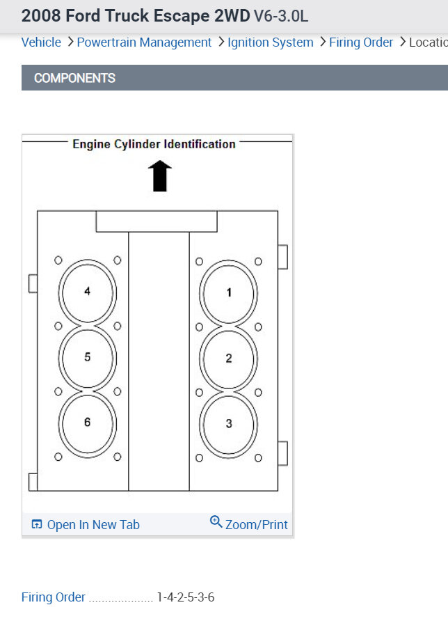

Which is cylinder #2 on my vehicle can you send me a picture or diagram?
Jan 21, 2023 at 5:52 AM
  • 55,402 POSTS

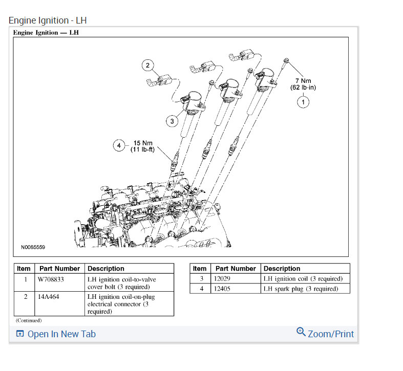

Coil pack, there are individual coils on this engine, please check the images below to see what I am talking about and i have included the firing order in case you need it. Please let me know.
Jan 22, 2023 at 3:39 AM
ISAIAHSMAMA
My engine sense diagonal, so I believe bank one is in the back with one two and three and the front is three four and five. am I correct on my vehicle listed above XLT model?I'm trying to figure out which one is cylinder two bank 1. I think we looked at the picture backwards when we rotated the phone, so we were looking at the wrong cylinder.
