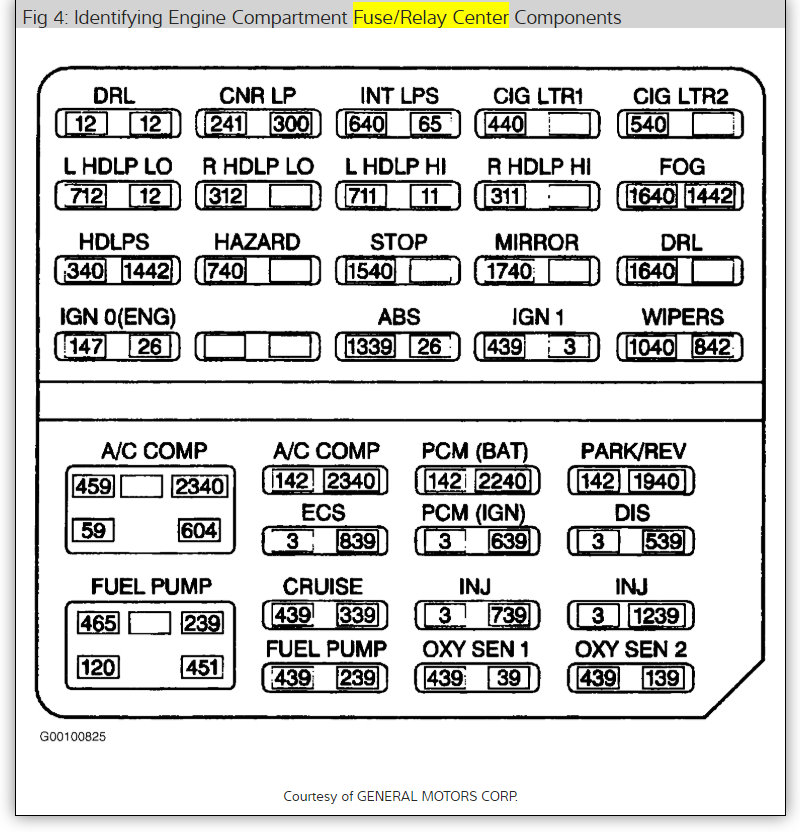

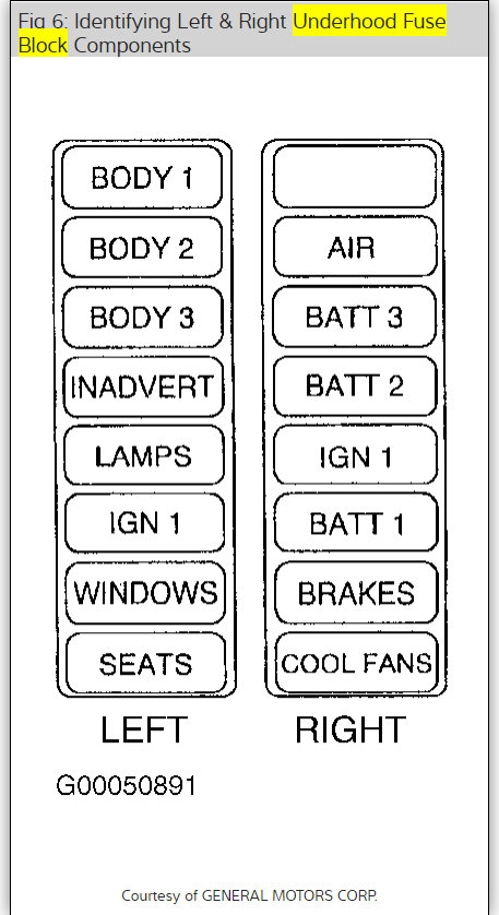

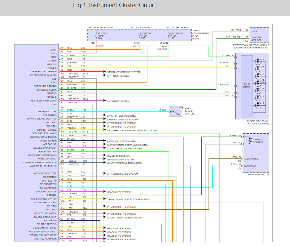

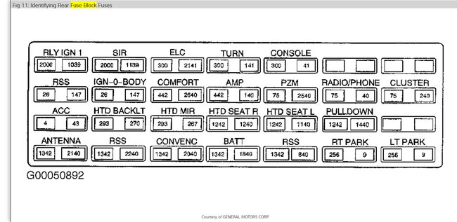

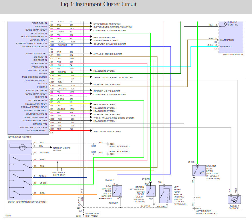

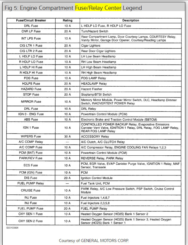

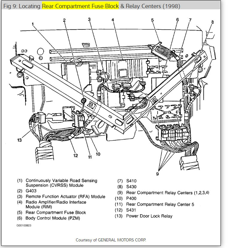

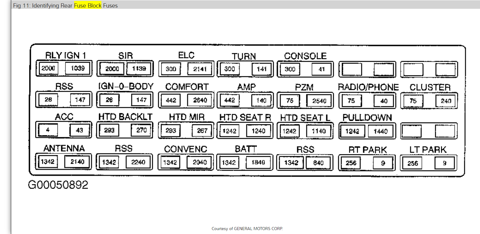

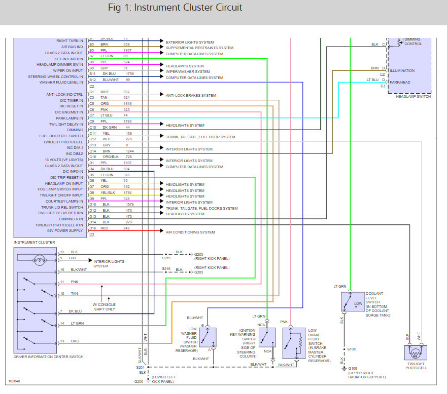

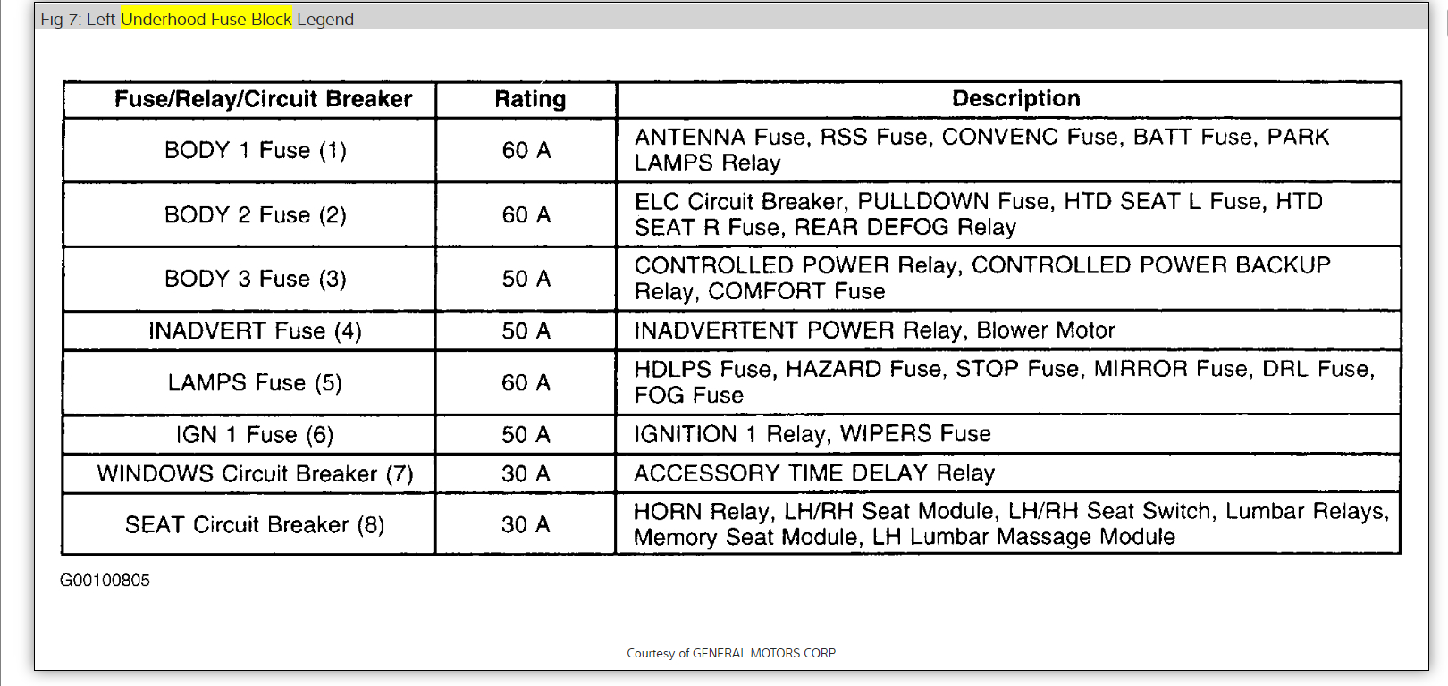

Upon startup the information does not work. Car sat while away now cannot get reading information on dash.
Nov 10, 2018 at 12:49 PM
Experienced Mechanic
55,684 POSTS
It sounds like a fuse is out or the cluster has gone bad. Let's check the fuses (Ign, cluster and body 0) and wiring first.
Here are the cluster wiring diagrams so you ca see how it works. Check out the diagrams (below). Please let us know what you find.
