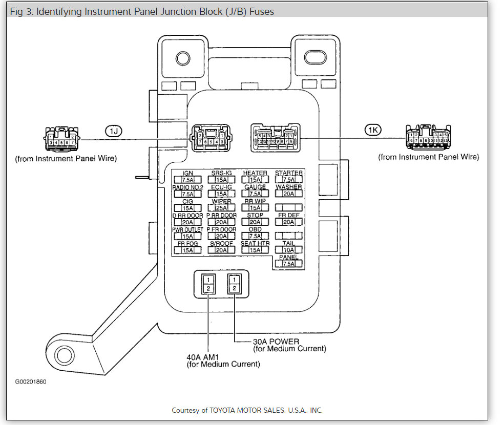

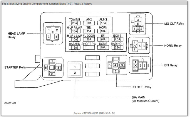

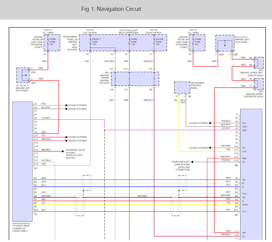

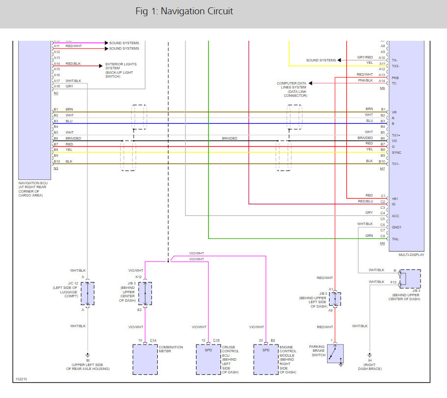

Information pane is no longer displaying - internal temperatures, fan speed, time in travel, m/ph etc. The radio and clock are still lit up.
Nov 7, 2018 at 4:04 AM
  • 55,421 POSTS
There are four fuses that run the system I would check the dome fuse first. Here is a wiring diagram so you can see how it works and a guide to help you check for power with the locations of the fuses below. Check the wiring diagrams to see the other fuses
