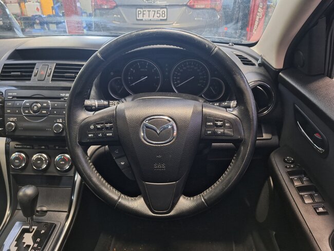

It all started when i purchased the vehicle.
1. I can't adjust the time settings. (This model has no H or M button and also no set button)
2. I can't access the trip computer to see fuel consumption.
I have replaced the clock spring.
I have also replaced the circuit board on the steering wheel for the buttons.
I have connected to a launch diagnostic tool and have found nothing to point me in the right direction.
Please see image of radio and steering.

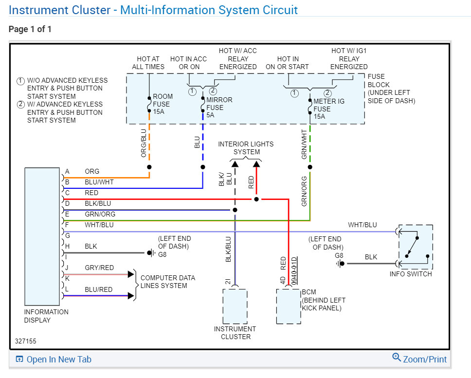

This will scan the body portion of the car not just the drivetrain. I would first check the ROOM fuse inside the car under the dash. Then let's use a voltmeter to test the connection of the WHITE/BLUE wire from the info switch to the info display, here is a guide to help and the wiring diagrams to help, if the connection is good, you may have a BCM going out.
