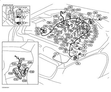

https://www.2carpros.com/forum/automotive_pictures/248015_54_1.jpg
2. Check the following:
"Â Check for poor connection at connector F32 terminal No. 4 (Green/Yellow wire). See Fig. 15 and Fig. 35 .
https://www.2carpros.com/forum/automotive_pictures/248015_15_5.jpg
https://www.2carpros.com/forum/automotive_pictures/248015_35_1.jpg
"Â Check for poor connection at fuse, fusible link and relay block harness connector E3 terminal 34R (Green/Yellow wire). See Fig. 11 .
https://www.2carpros.com/forum/automotive_pictures/248015_11_8.jpg

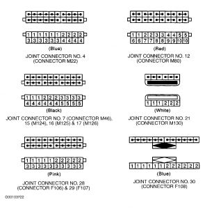

"Â Check joint connector No. 29 (connector F107). See Fig. 15 and Fig. 19 .
https://www.2carpros.com/forum/automotive_pictures/248015_15_6.jpg
https://www.2carpros.com/forum/automotive_pictures/248015_19_3.jpg

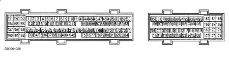

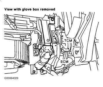

5. Disconnect ECM harness connector. See Fig. 5 . Check continuity of Yellow wire between left IVTC solenoid harness connector terminal No. 2 and ECM harness connector terminal No. 73, or White wire between right IVTC solenoid harness connector terminal No. 2 and ECM harness connector terminal No. 74. See Fig. 8 . Also, check circuit for short to ground and short to voltage. If problem is found, repair as necessary. If circuit is okay, go to next step.
https://www.2carpros.com/forum/automotive_pictures/248015_5_41.jpg
https://www.2carpros.com/forum/automotive_pictures/248015_8_15.jpg

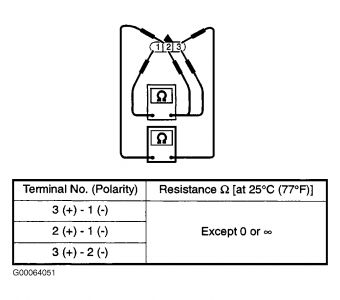

6. Remove IVTC position sensor. Visually inspect sensor for chipping. Measure resistance of sensor as shown in illustration. See Fig. 43 . If resistance is as specified and sensor is not chipped, go to next step. If resistance is not as specified or sensor is chipped, replace IVTC position sensor.
https://www.2carpros.com/forum/automotive_pictures/248015_43_1.jpg

10. Disconnect joint connectors No. 28 (connector F106) and No. 29 (connector F107) located under right side of instrument panel. See Fig. 15 and Fig. 19 . Check the following:
https://www.2carpros.com/forum/automotive_pictures/248015_15_7.jpg
https://www.2carpros.com/forum/automotive_pictures/248015_19_4.jpg
"Â Check continuity of shield circuit (Gray wire) between joint connector No. 28 terminals No. 1 and 3.
"Â Check continuity of shield circuit (Gray wire) between joint connector No. 28 terminal No. 3 and joint connector No. 29 terminal No. 3.
"Â Check continuity between ground and shield circuit (Gray wire) at joint connector No. 29 terminal No. 3.
"Â Check joint connectors No. 28 and 29.
Continuity should exist. Also, check circuit for short to voltage. If problem is found, repair as necessary. If circuit is okay, go to next step.

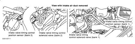

Looks like the checks are the same. . .. . .. . .. . .. . .
If you don't want to do all the checks. . .. . .you could take a chance and change the sensors. . .
The IVTC, crankshaft and camshaft. . .. . .. . .. . .
Then go to AZ and have them clear the codes and try it again.
