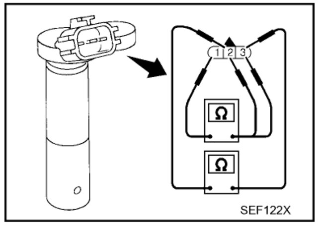

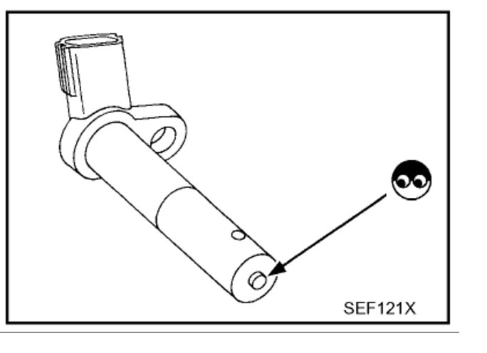

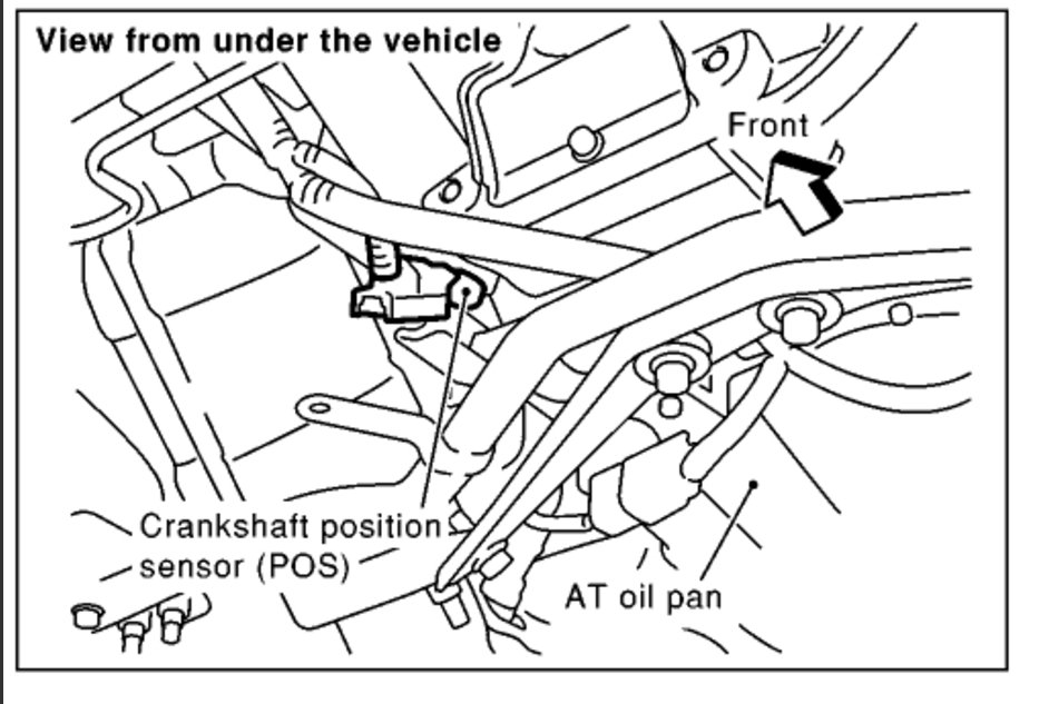

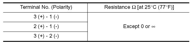

This is an old thread but I have seen many people having problems with the crankshaft angle sensor going out in this car.
Here is a guide that will give you an idea on what to do with the repair.
and
Here are some diagrams of what it will be like on your car and how to test the sensor (below)
You will need to jack the car up safely as well
Please let us know what happens and upload pictures or videos of the problem.
